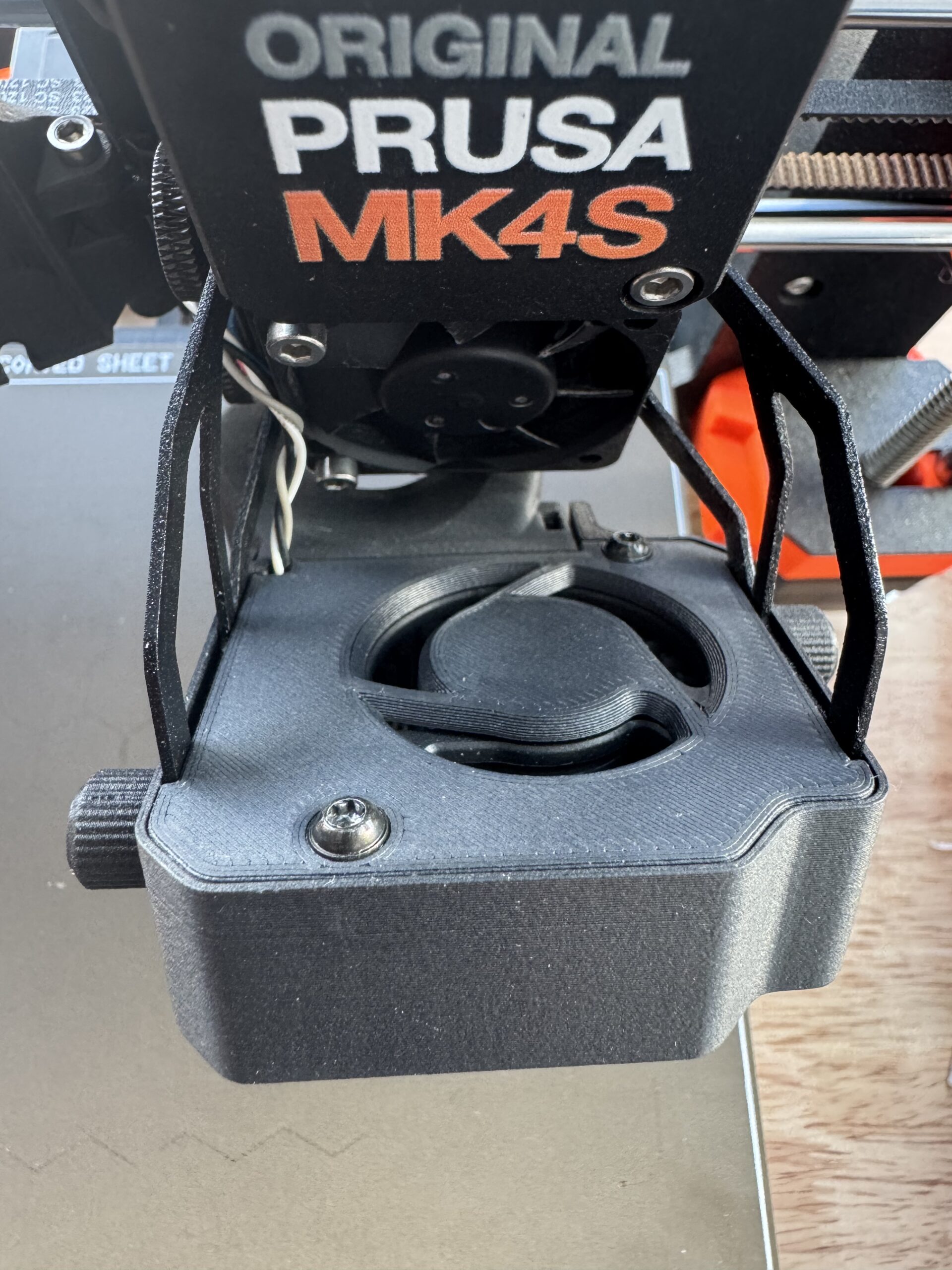

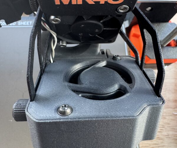

Though a recent reddit post I found out that I'm not alone with the loud X-Axis movement on the Prusa MK4S. I thought it was just me... I found out I could stop it by applying pressure on the center of the part cooling fan.

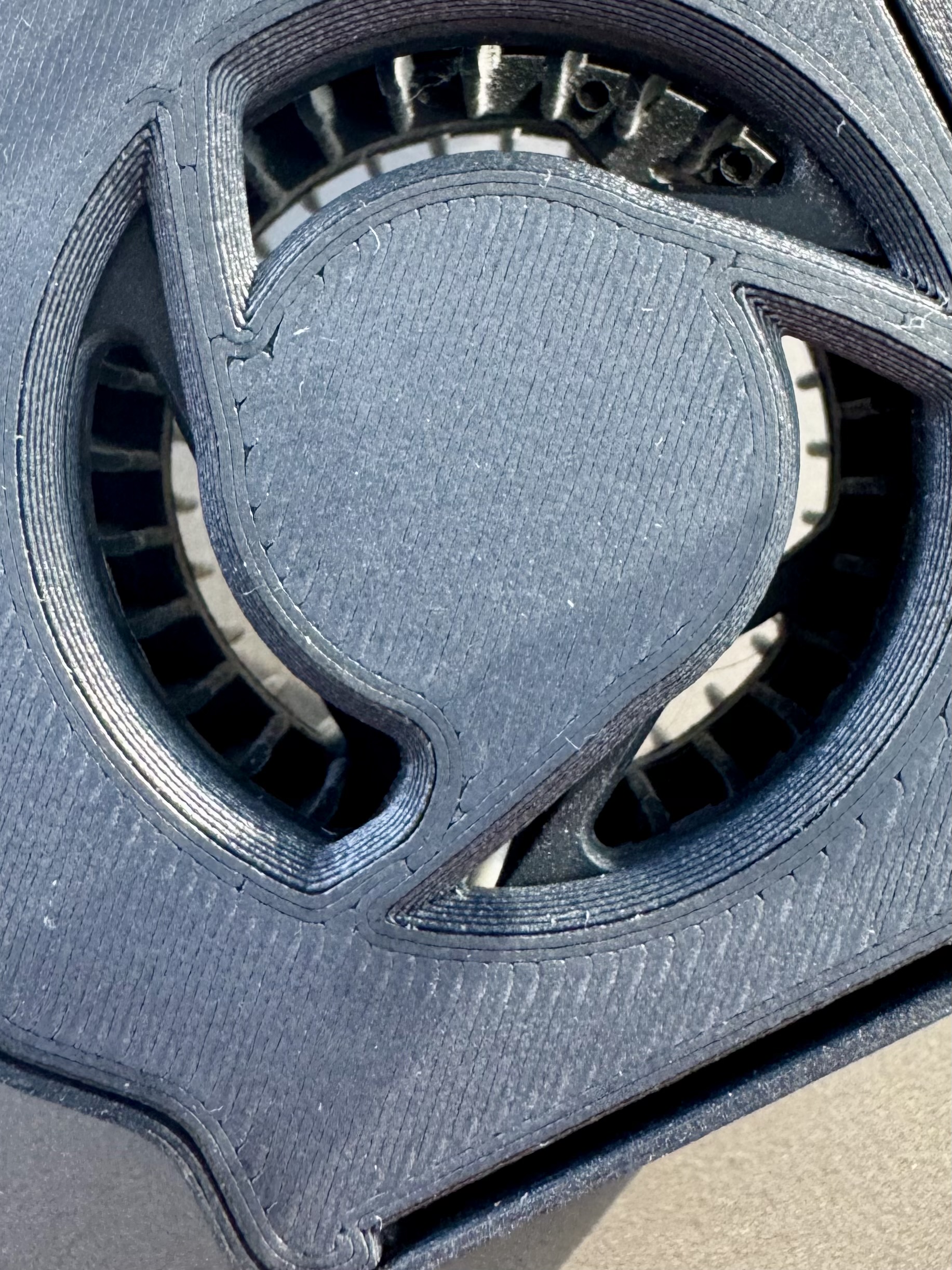

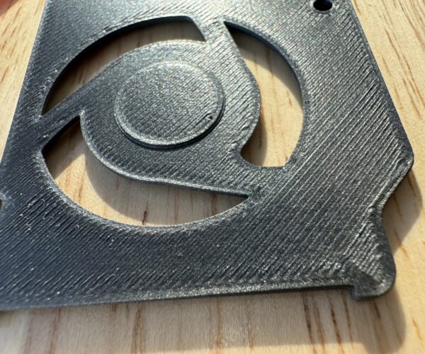

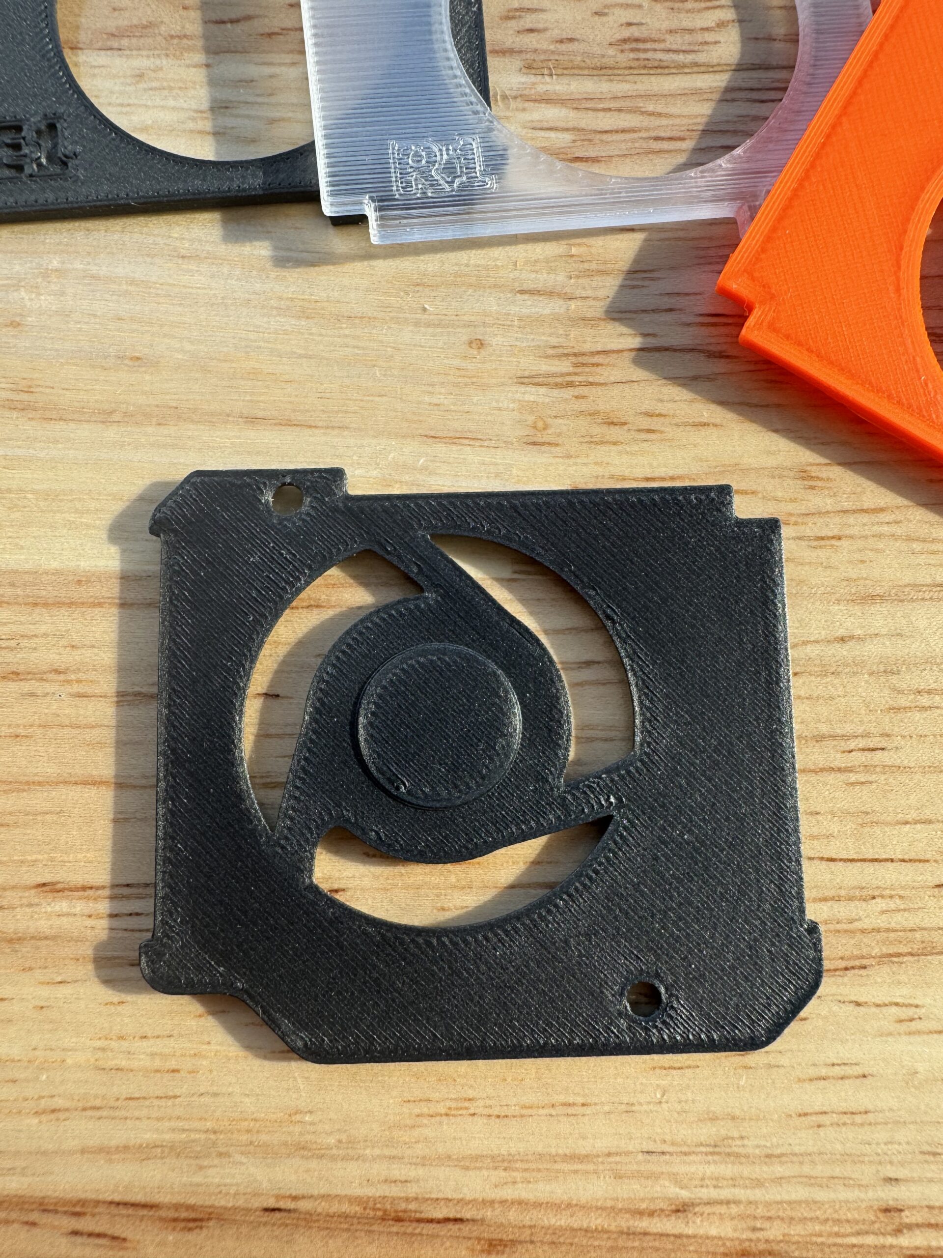

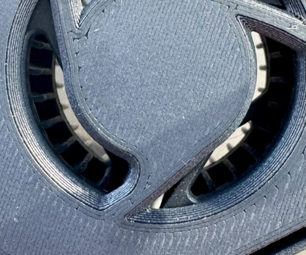

So I designed a new quiet fan cover that works better than my finger, and put it on Printables
I think the root cause of the sound is the natural resonance of polycarbonate. For examples, CD/DVD and Drivers Licenses are made from polycarb, and they make loud rattle when you drop them. I think the fan it reverberating in the case.
