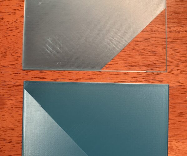

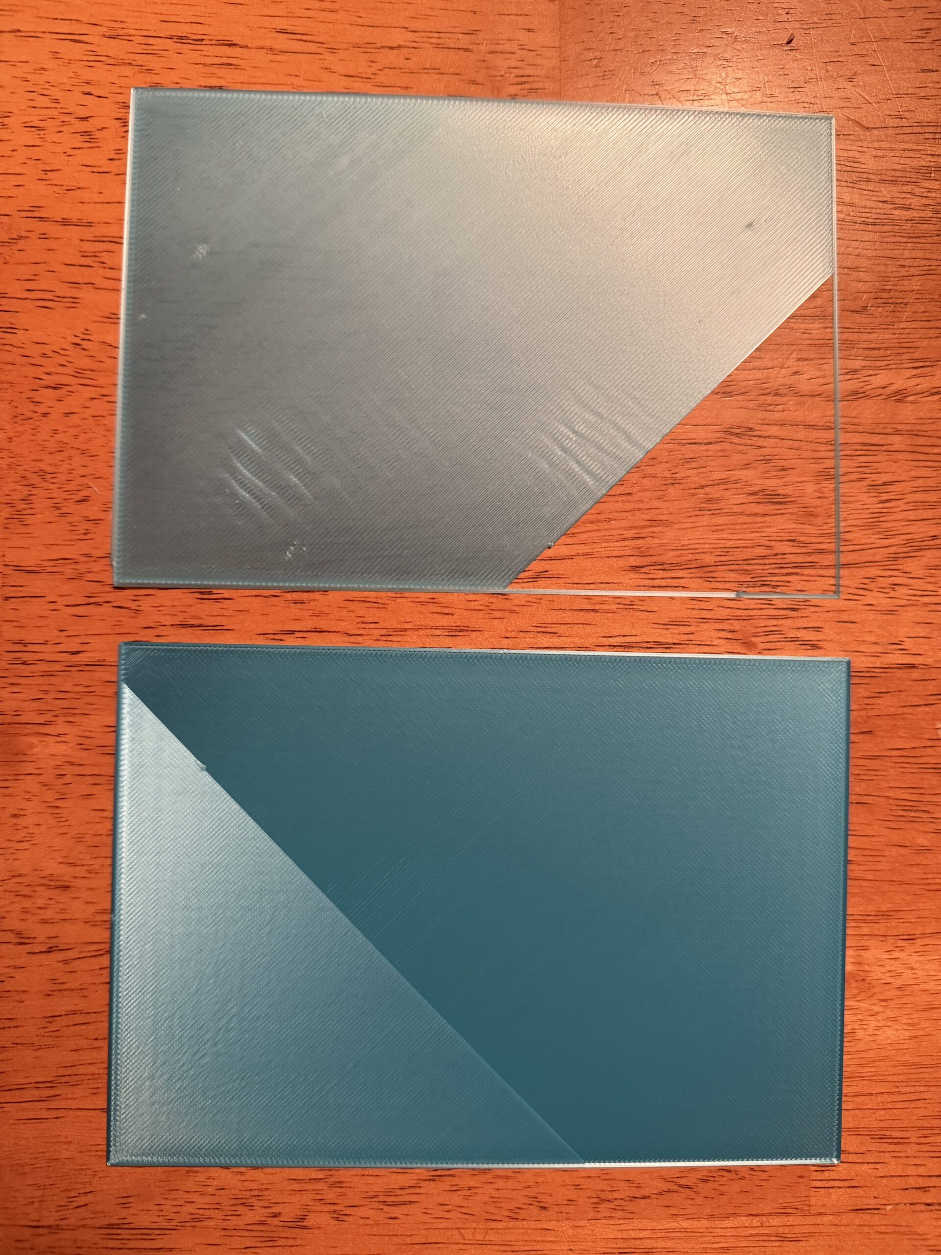

so i love this printer but this happens sometimes. Any ideas? I re ran the calibrations without success. It is on a stable non shaky surface
Best Answer by FoxRun3D:
See https://github.com/prusa3d/Prusa-Firmware-Buddy/issues/4254
Try adjusting live Z by +0.04 when the print starts by long pressing the LCD knob.

Thanks for your response! I will check into this and try it out.

That seemed to fix it! See photo. Is there a way to permanently set it up for a +0.04 Z offset?
