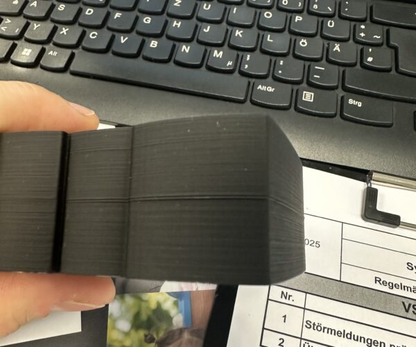

Hello everyone, I’m Bogdan. I’ve had a Prusa MK4S for half a year now, and I’ve gained some experience with it, but I still lack some information. I have the following problem for which I can’t find a solution:
When printing a wall on top of a top layer, the outer perimeter of the wall and the outer perimeter of the layer below do not align. The result looks like a layer shift.
What can I do to fix this?
Thank you in advance!

Look for "bulge" or sometimes misspelled as "buldge"
e.g.,
https://forum.prusa3d.com/forum/original-prusa-i3-mk3s-mk3-how-do-i-print-this-printing-help/buldge-when-print-reaches-solid-layers/

Thank you, I didn't know about the "buldge" phenomena, I had this issue in many of my prints and  i thought  that was just  some settings problems.
