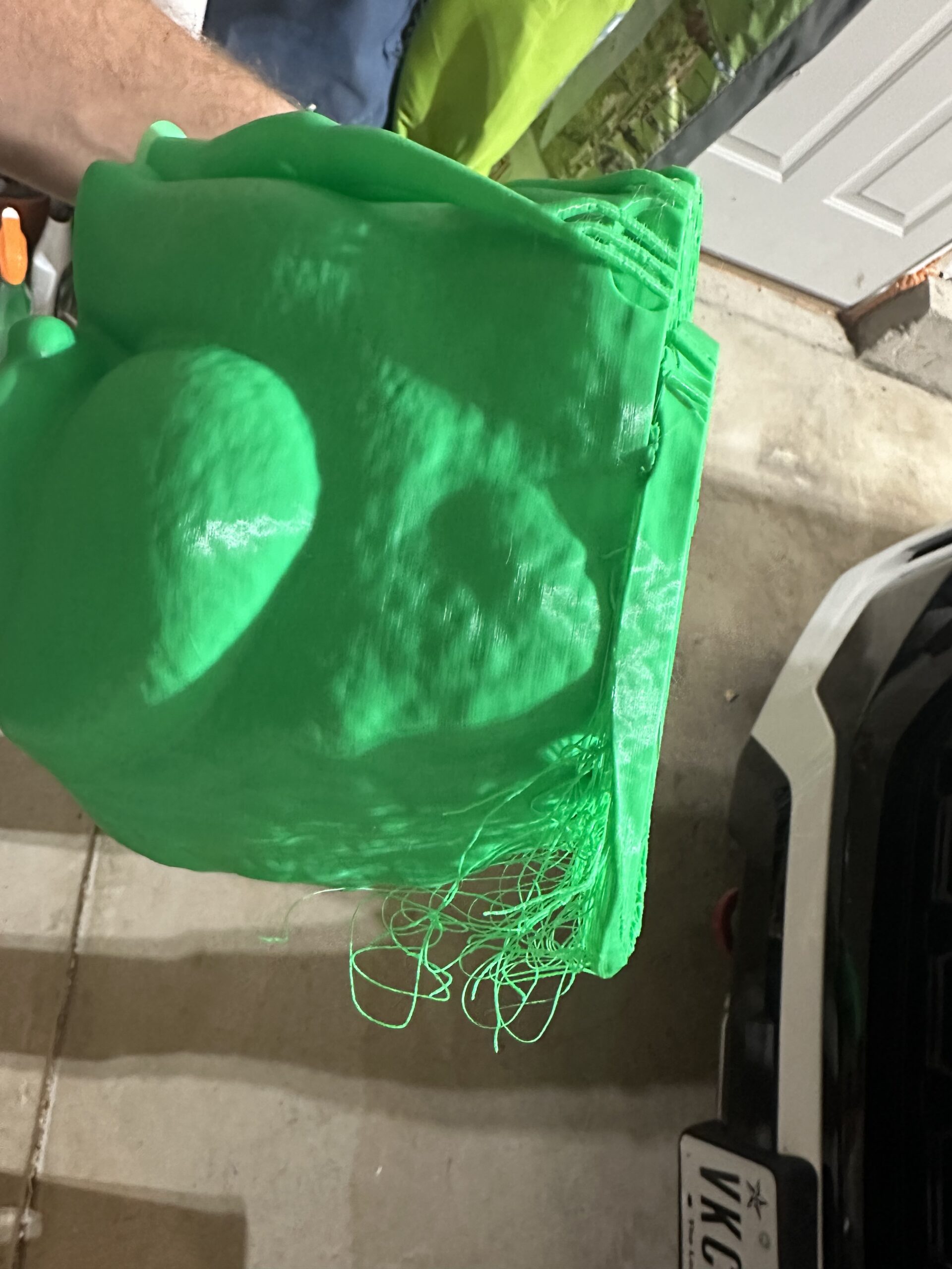

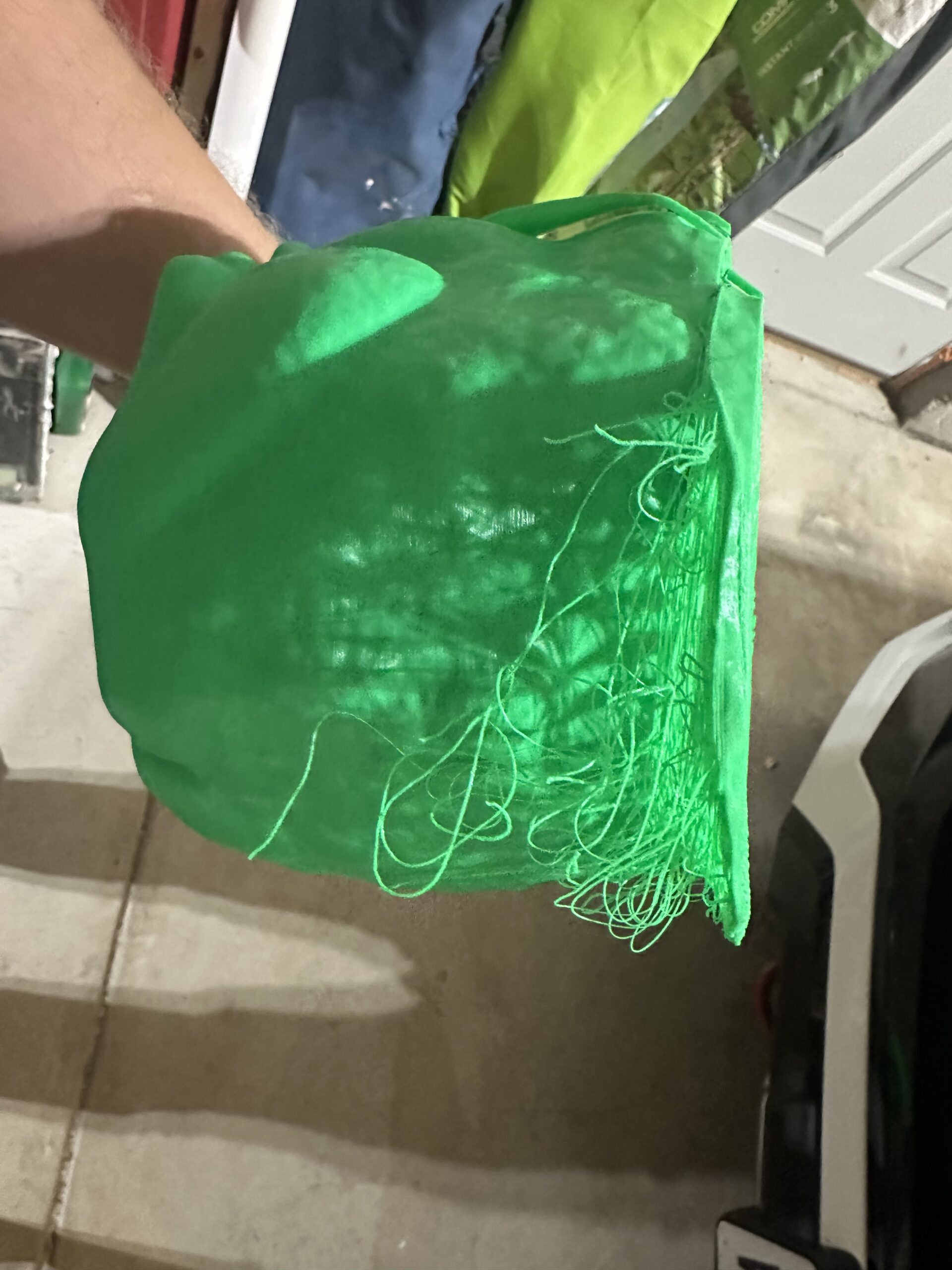

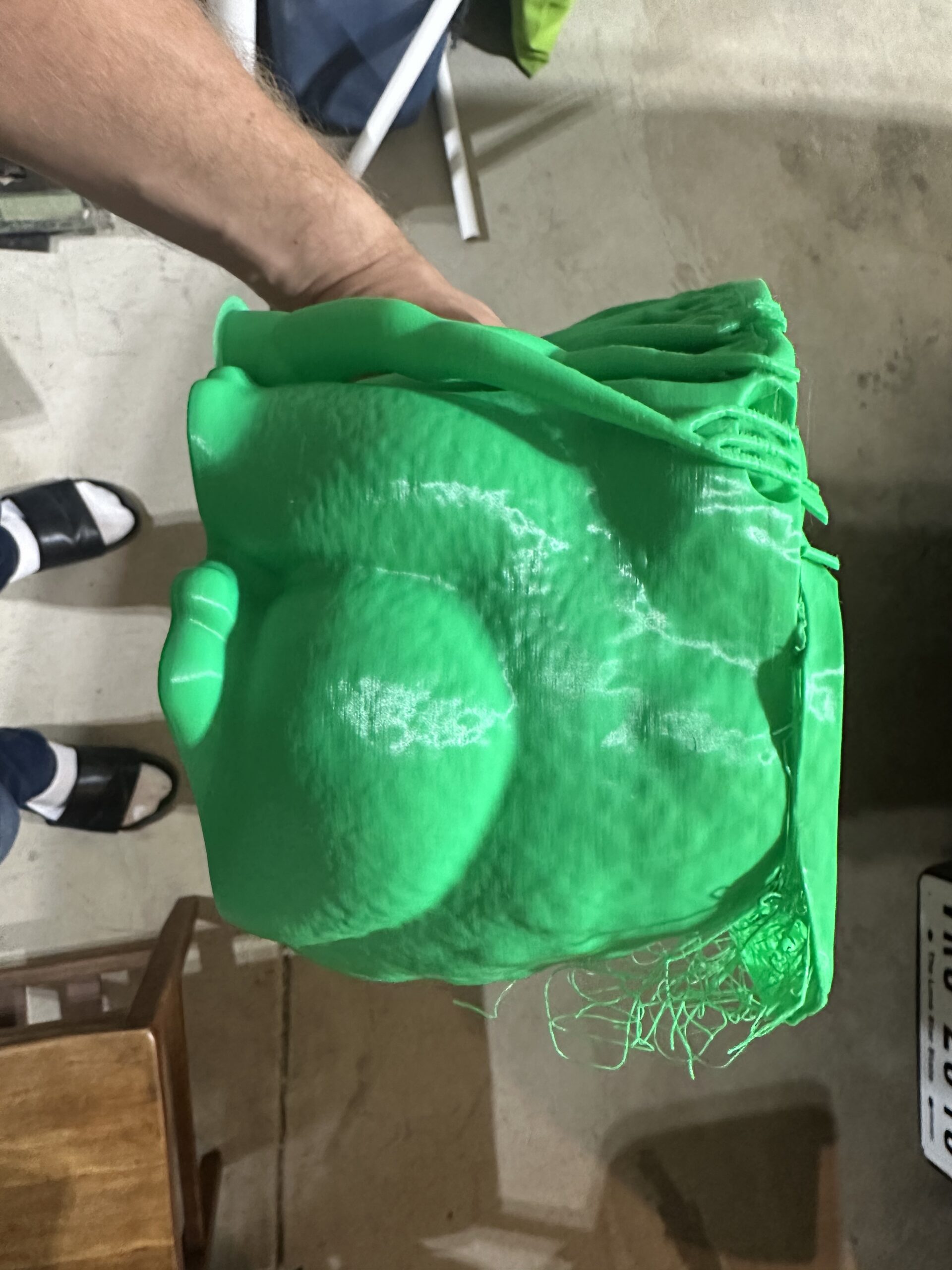

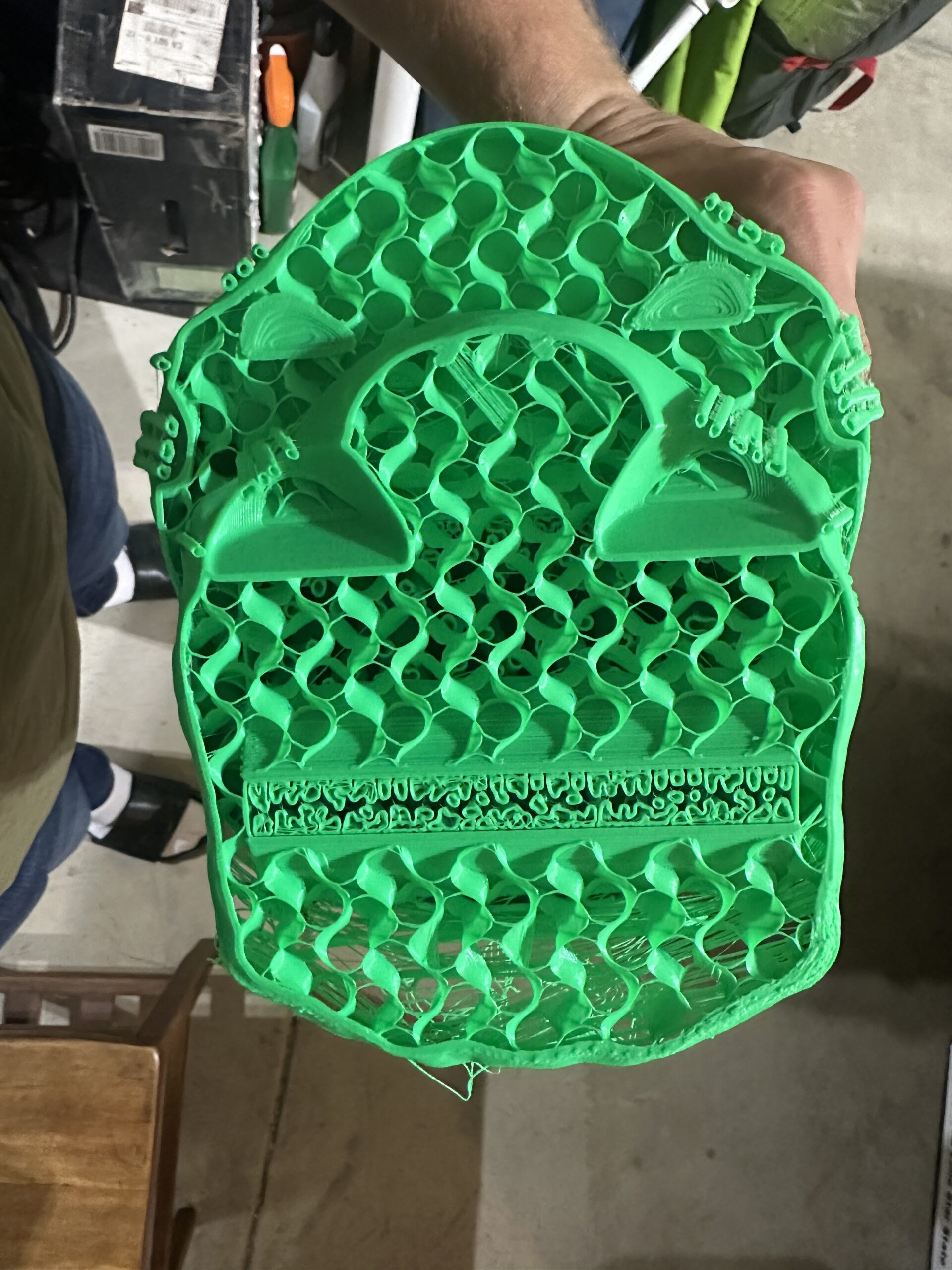

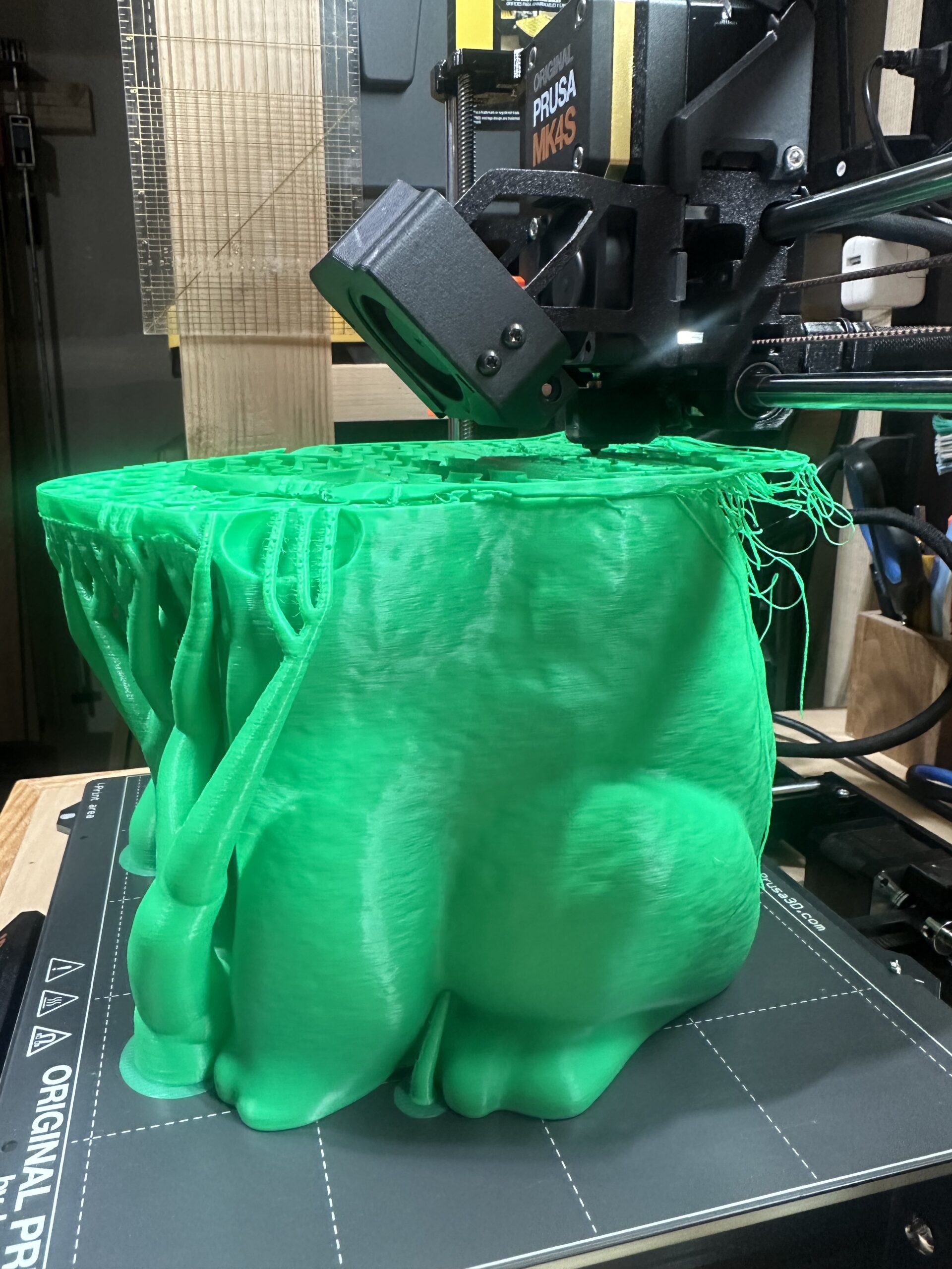

I bring it into Prusa app, follow the exact instructions from designer, but the print errors at the exact same place every single time.  I've now printed 3 times and each time, i re-import the file into Prusa Connect app, slice it fresh each time, and print.  But it errors in the exact same place every time.  I'm so frustrated.  I have ZERO issues with any other prints i've done.  This one is perplexing me.  Any help would be much appreciated.  I'd also like to know if I can print just the top part that messed up, and then glue it to the below portion, so it's not all a waste. IMG_5419

Before downloading any print file and definitely before paying for one, always read the comments and pictures of builds.  In this case it appears that others have had printing issues but it -is- possible to build it with care (not all paid-for files are printable, beware).
It looks like the main issue causing crashes is warping of the large, flat, roof-of-mouth area.  Protect the printer from drafts and perhaps try a fill that puts less thermal contractive stress into the part, I would try adaptive cubic or perhaps a low density honeycomb.   When you get to that stage next time watch the print, try to  see what, if anything, is catching.  It *might* be some of the organic support, if so look into snug support.
