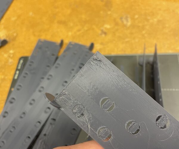

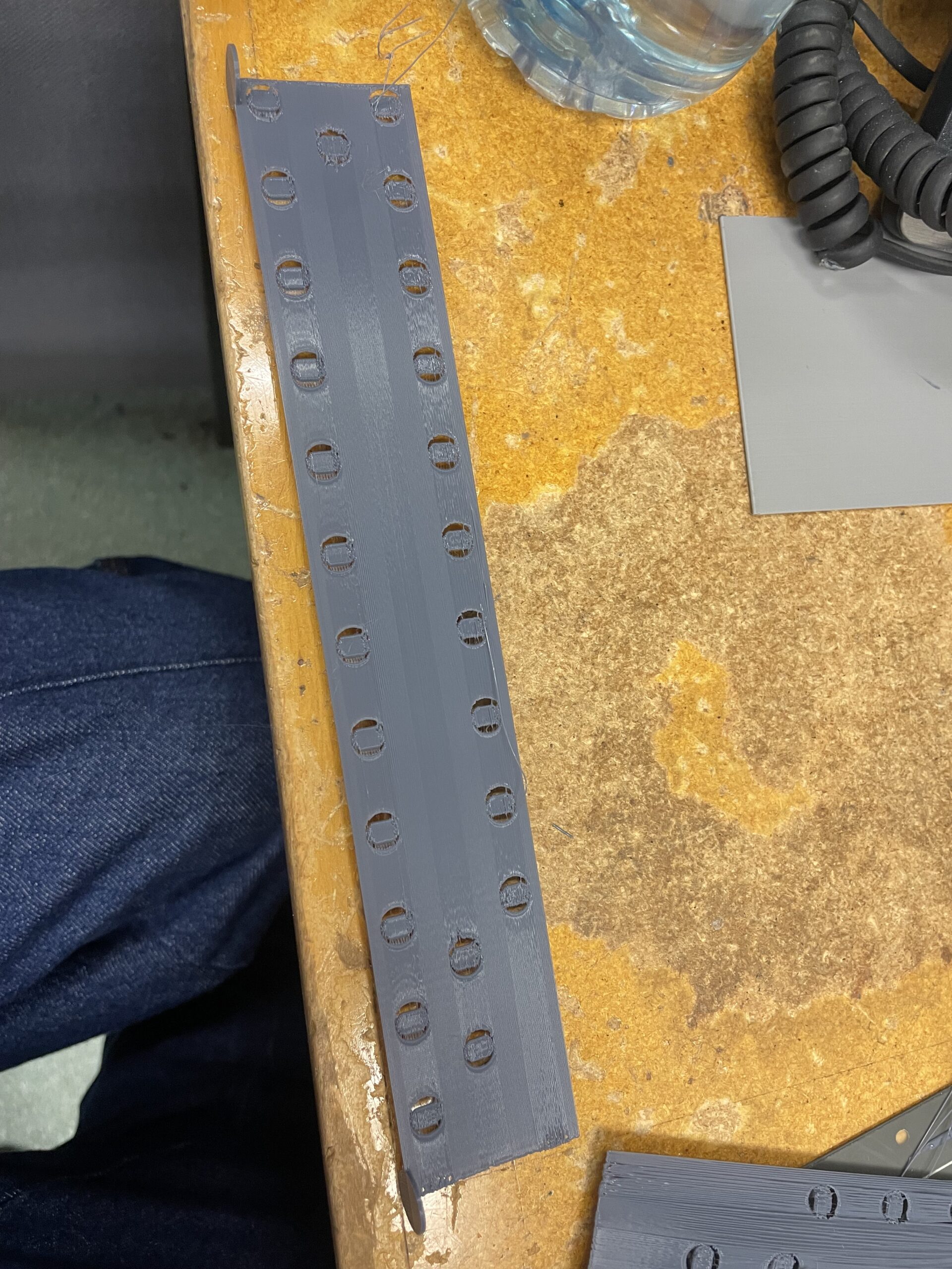

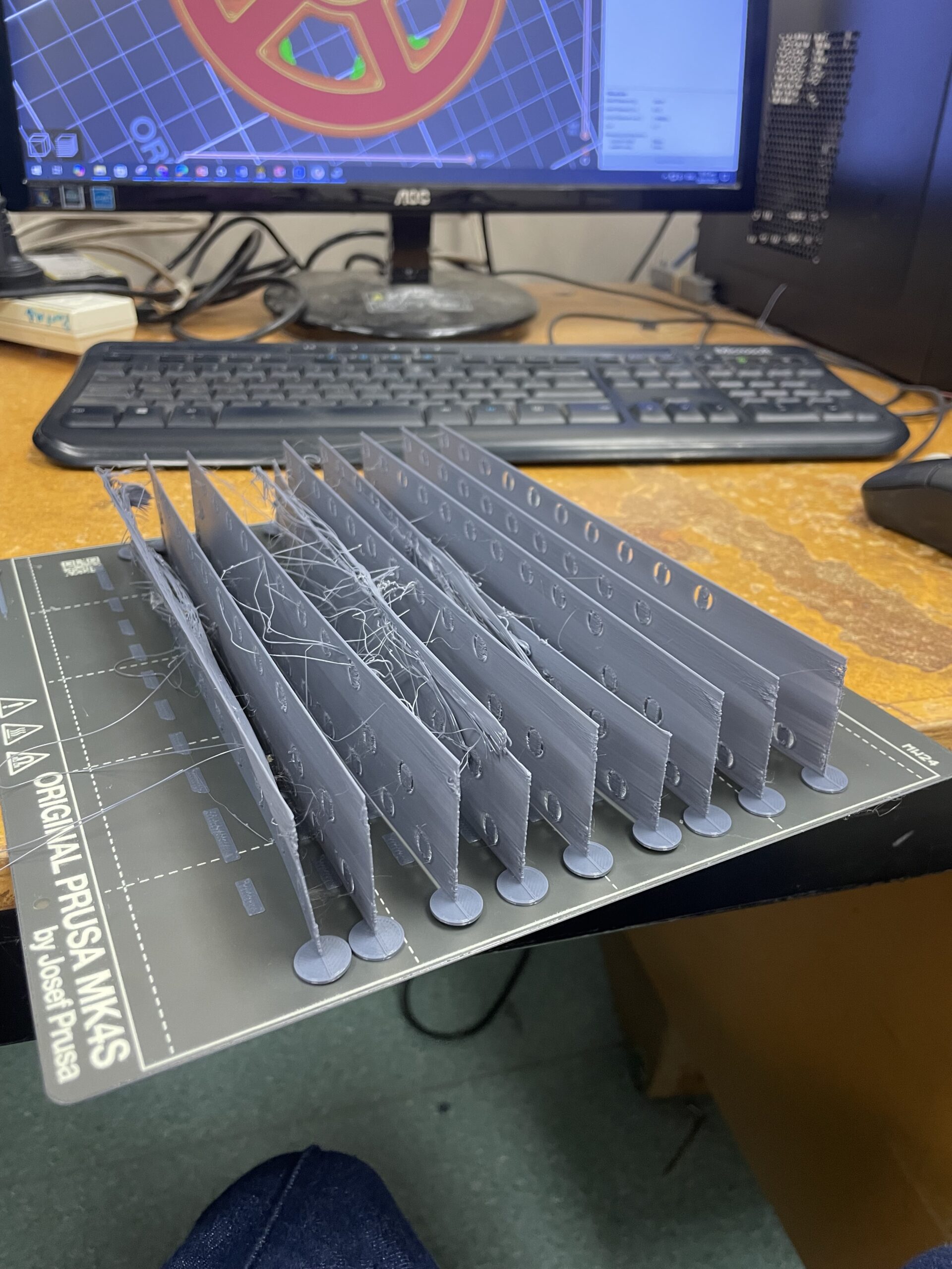

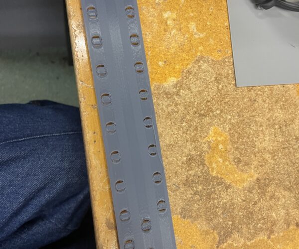

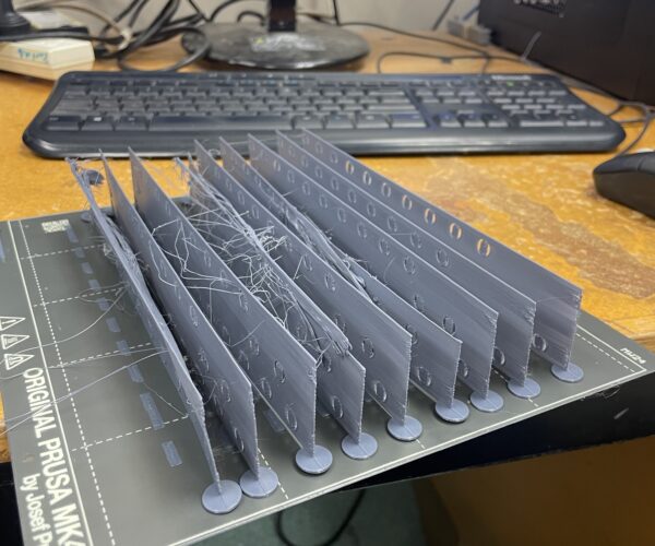

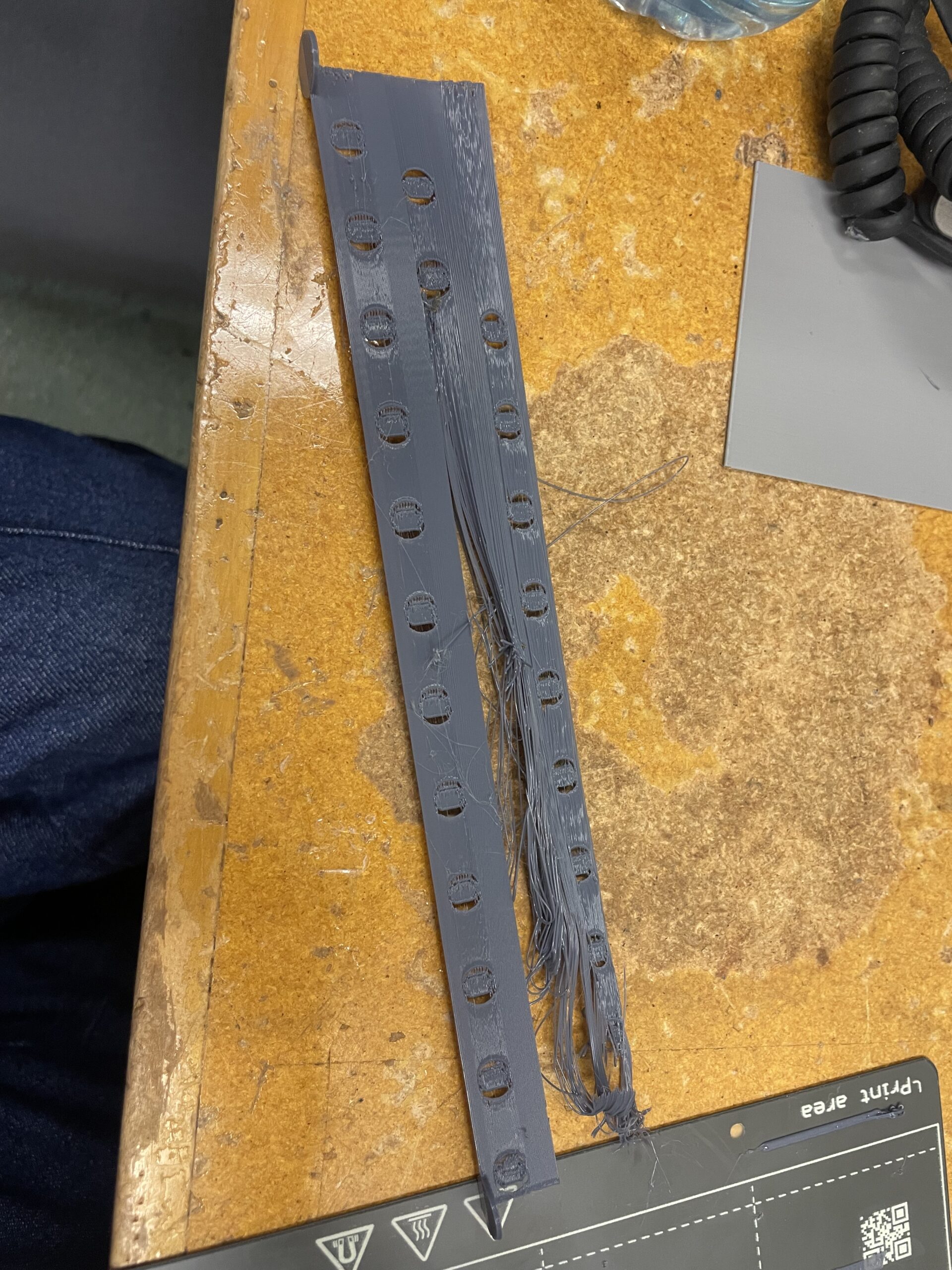

I am trying to print the thin structures as seen below, and I need to print them in this orientation for a separate reason.
The structure is only 0.5mm thick, so I am getting issues of poor layer adhesion.
The print below was done on 75% speed and with new filament, so I doubt this is the issue. I tried printing a single one at a time but this still had adhesion issues on the edges of the structure.
Any help would be greatly appreciated!

I suspect that your panels are wobbling as the Y axis moves back and forth
I see that the panels are quite long, is it possible to re orientate the panels at an angle diagonally across the build plate? this might help mitigate the potential wobbling
Or perhaps reduce the travel speed to give the panels an easier life!

Maybe even put them fully parallel with Y-axis
