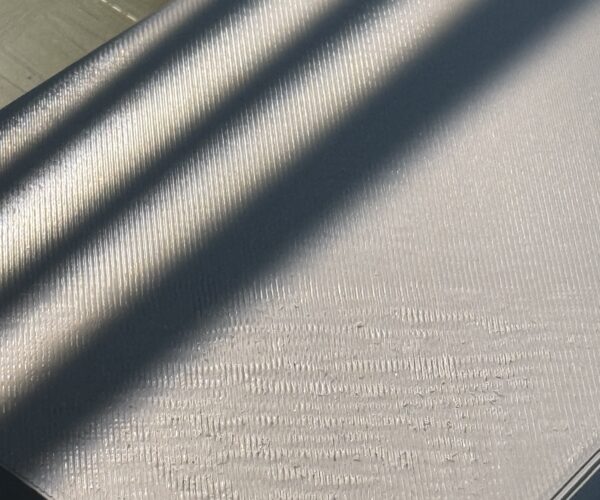

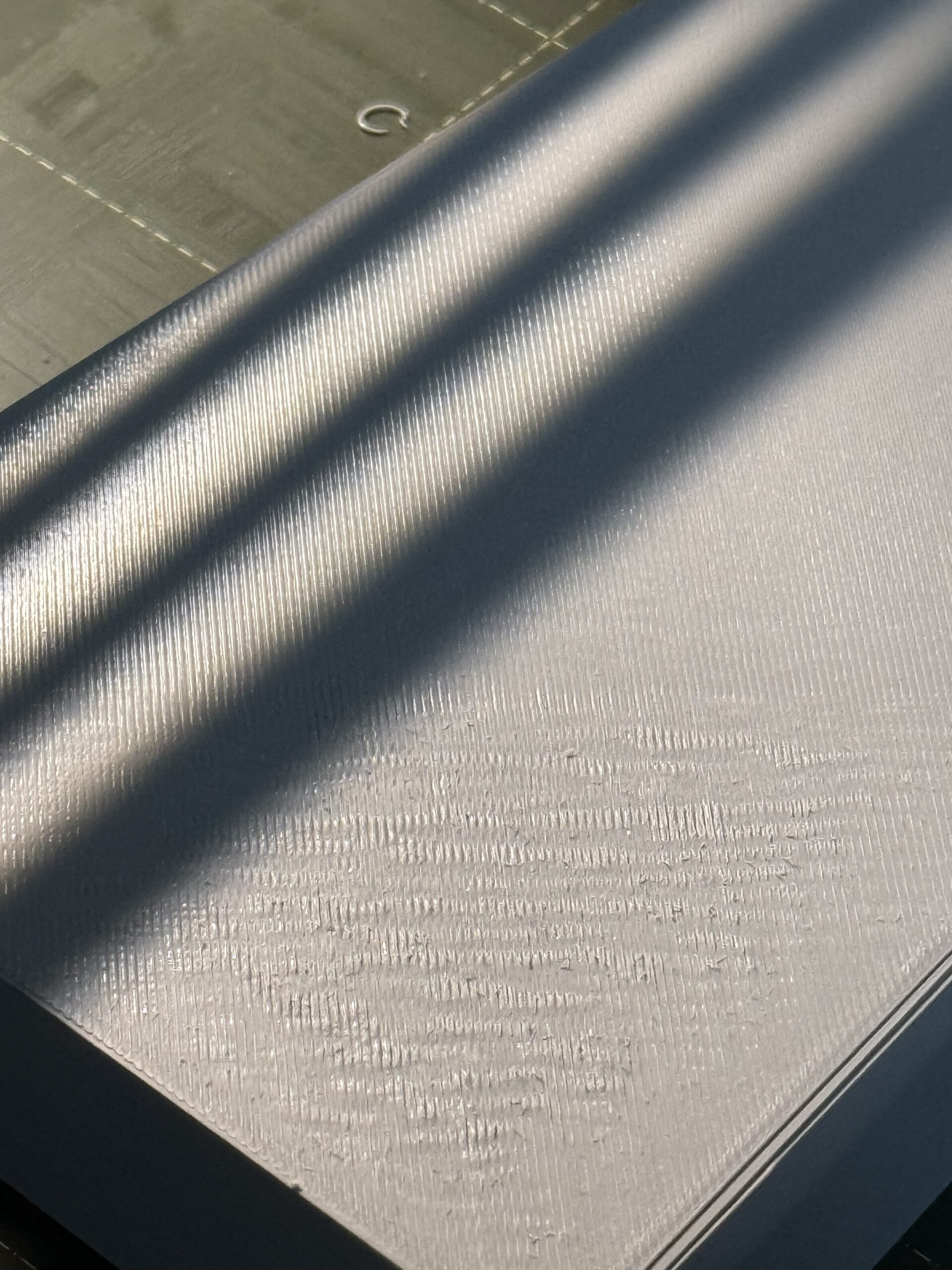

SpiritOfStLouis
(@spiritofstlouis)
RE: PETG challenges due to IS-only profile
Hello  All
Since  I updated  my MK3S to MK4S , I am facing  issues  to  print  PETG projects
I am using legacy  MK4S HF 0,4mm , 0,20mm Speed, Prusament  PETG  profile , infill 15% gyroid, nozzle temp  250°C , bed  temp  85°C
after  a complete maintenance of the  machine (cleaning, belt tension  X &Y axis , greasing ,  nozzle replacement. calibration)
I could get the  following result , after having modified the  nozzle temperature to  260°C ... otherwise it  would end  horribly :
For me there  is a problem  when  transitioning  between  infill and bridge infill.
Would you have any advise ?
