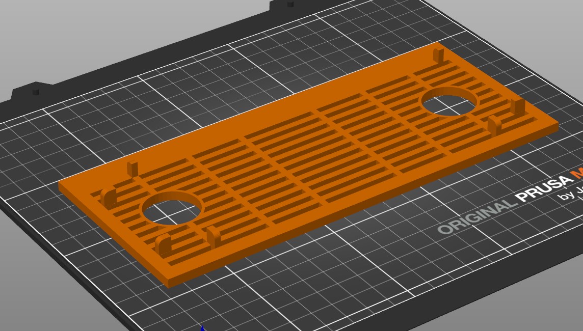

Can you introduce stress relief features into your design?  For a long straight wall, vertical "ribs" or "indents", or holes in the wall, can provide a way to relieve the stresses.  Rounding vertical corners also appears to help, and avoiding chamfers/fillets on bottom edges helps too.  Gyroid infill is less prone to warping, and less infill is better for this too.
All of these suggestions depend on your print requirements though.  Not all prints can take advantage of these.

Maybe it will help i wanted print this model.
