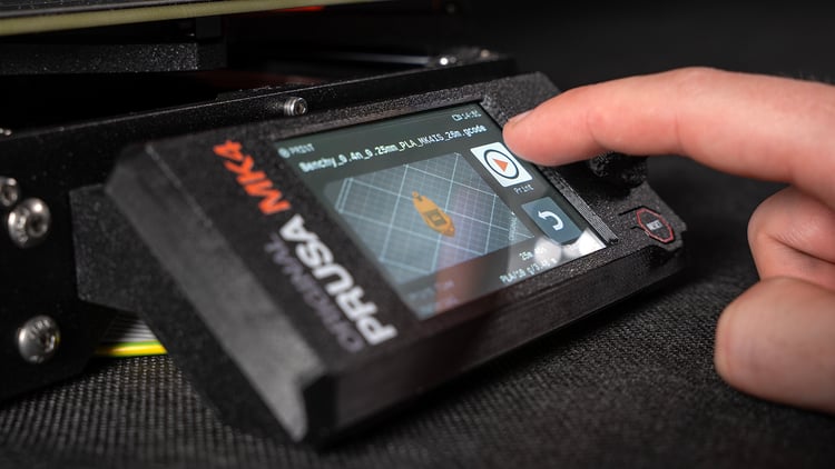

Putting text on 3d prints is somewhat easy on Prusa Slicer. However, how did Prusa put *Near* flush text on xLCD cover of the MK4?
Is clearly printed face down on a textured sheet and the text is slightly raised.
Mk4 LCD screen
Guessing the text here is done with an SVG. But the settings to make this work are unclear to me.
Greatly appreciated if i can get the secret receipt to this particular trick.
Posted : 23/12/2024 12:50 am
RE: Flush text over textured sheet?
If you're referring to the "Original Prusa Mk4" text, there's no secret recipe. It's screen printed on the part with a UV printer.
