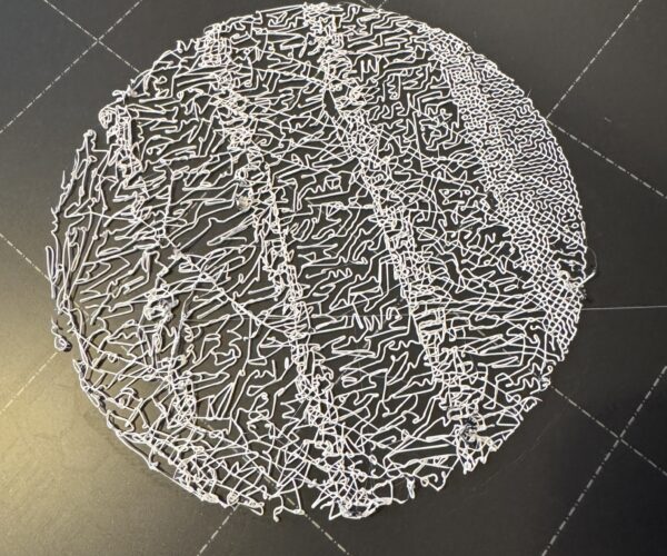

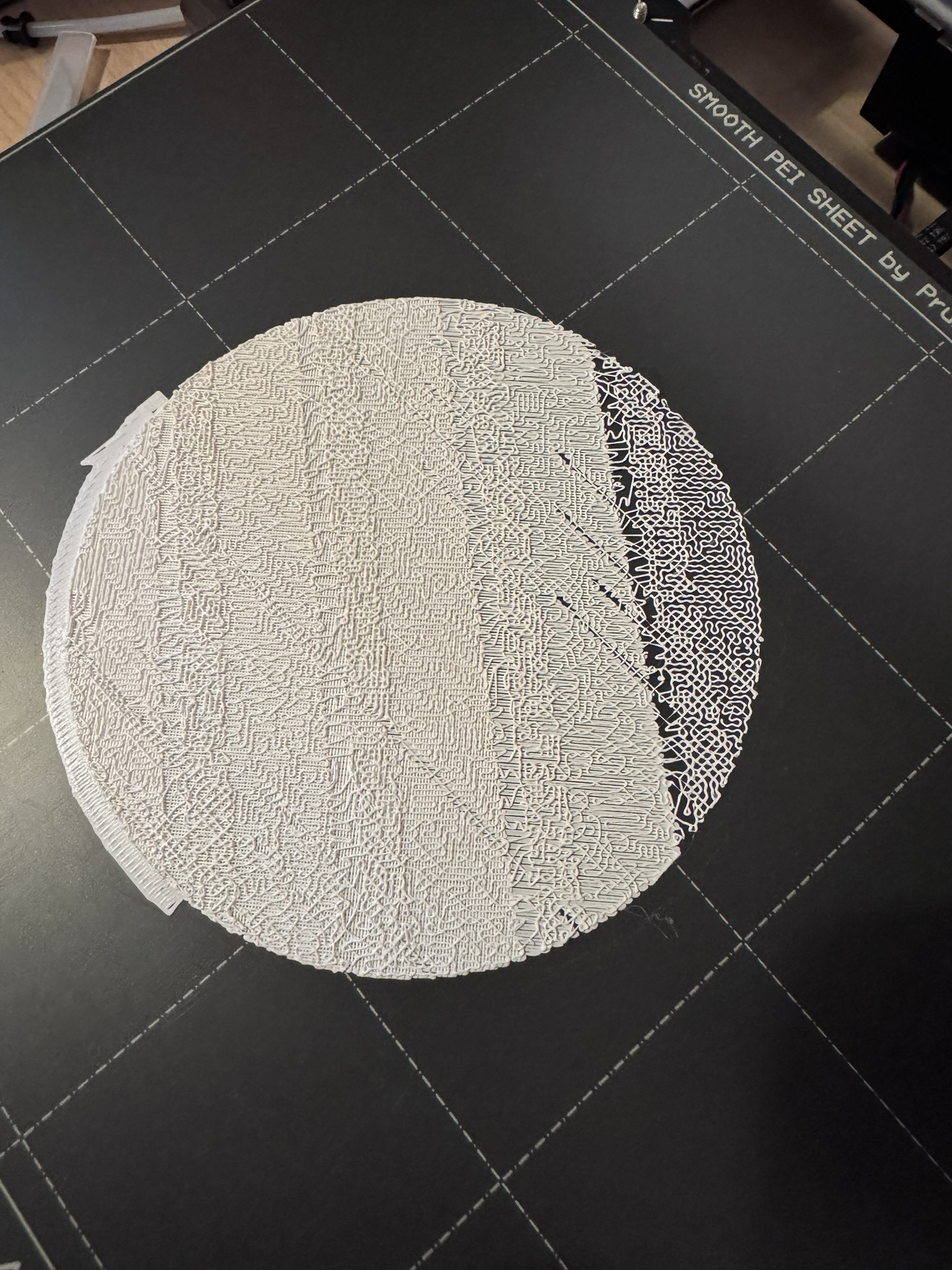

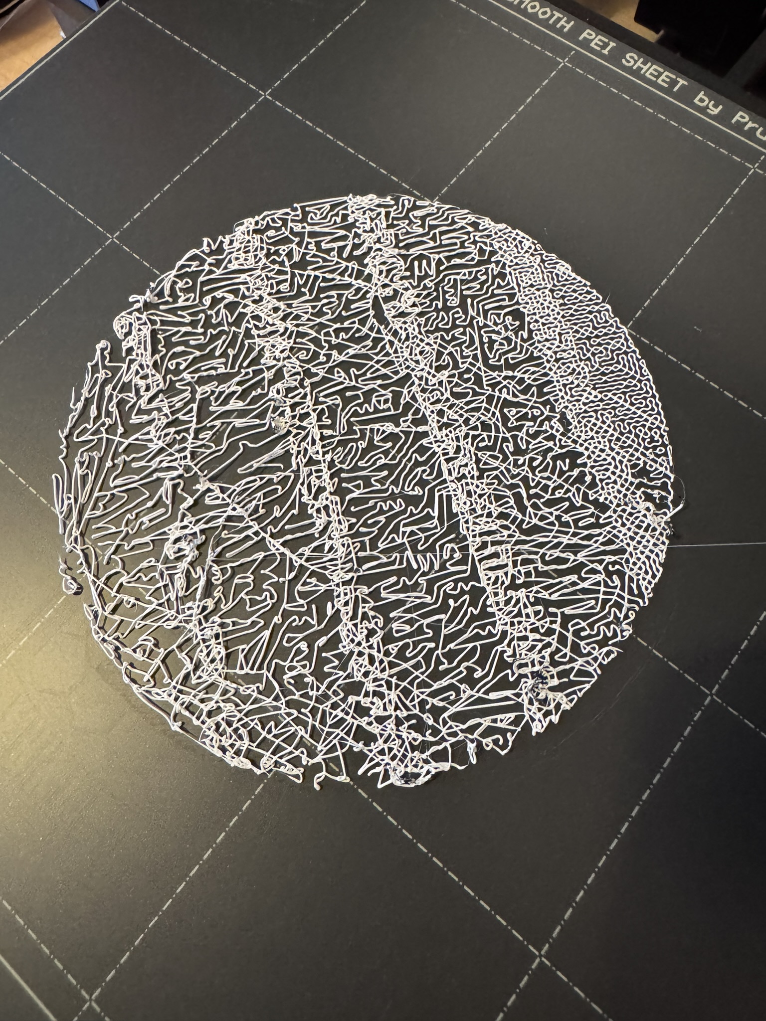

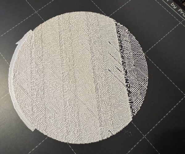

I have been trying to print a mesh for a mosquito screen; 1mm spacing and 0.3mm diameter cylinders to form the "threads" all drawn in TurboCad.  Without supports produced a squiggly mess, and with supports there are multiple layers but not even and not to the design.  Can anyone advise why this is happening.  I used .stl from the CAD to PrusaSlicer.

Can you please add a copy of the Project .3mf file, containing the model, so we can try and help.

While not addressing your particular issue (sorry!) I can suggest another (rather easy) way to generate a mesh.  If you simply define your mesh shape as a solid object, then slice it with zero top and bottom layers, it will print entirely with the infill pattern.  Define a suitably high number of perimeters (to make a strong enough border), then choose your infill pattern and infill density to vary the mesh.  Not as controllable (e.g. mesh size) as your method, but by eyeballing the slicing result you can probably make a mesh to suit your needs.  There are a few infill patterns that work well as a mesh - see here.

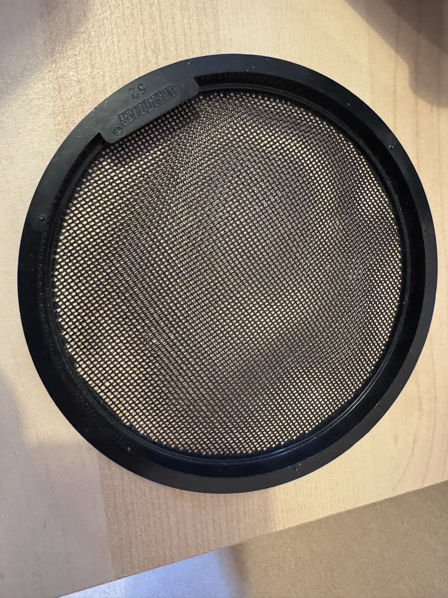

@Chris; thanks for the obvious solution of buying the mesh but this is for a boat's porthole which has a specific detail to position it and retain it in place as attached.  I had extracted my mesh element to check the printing would work because I know the surround is OK.  I could have bought the replacement item at a huge price but the challenge was to do it myself.  Perhaps a bit ambitious for a newby to CAD and 3D 🙁

Thanks to Chris and others I have been able to complete this mesh printing as attached.  I have created a new port hole screen (for a boat) with a1mm mesh, perimeter ring and a holding rim.  Brilliant; with the advice from the Forum I would not have succeeded.
