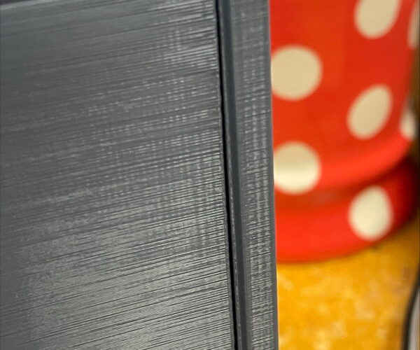

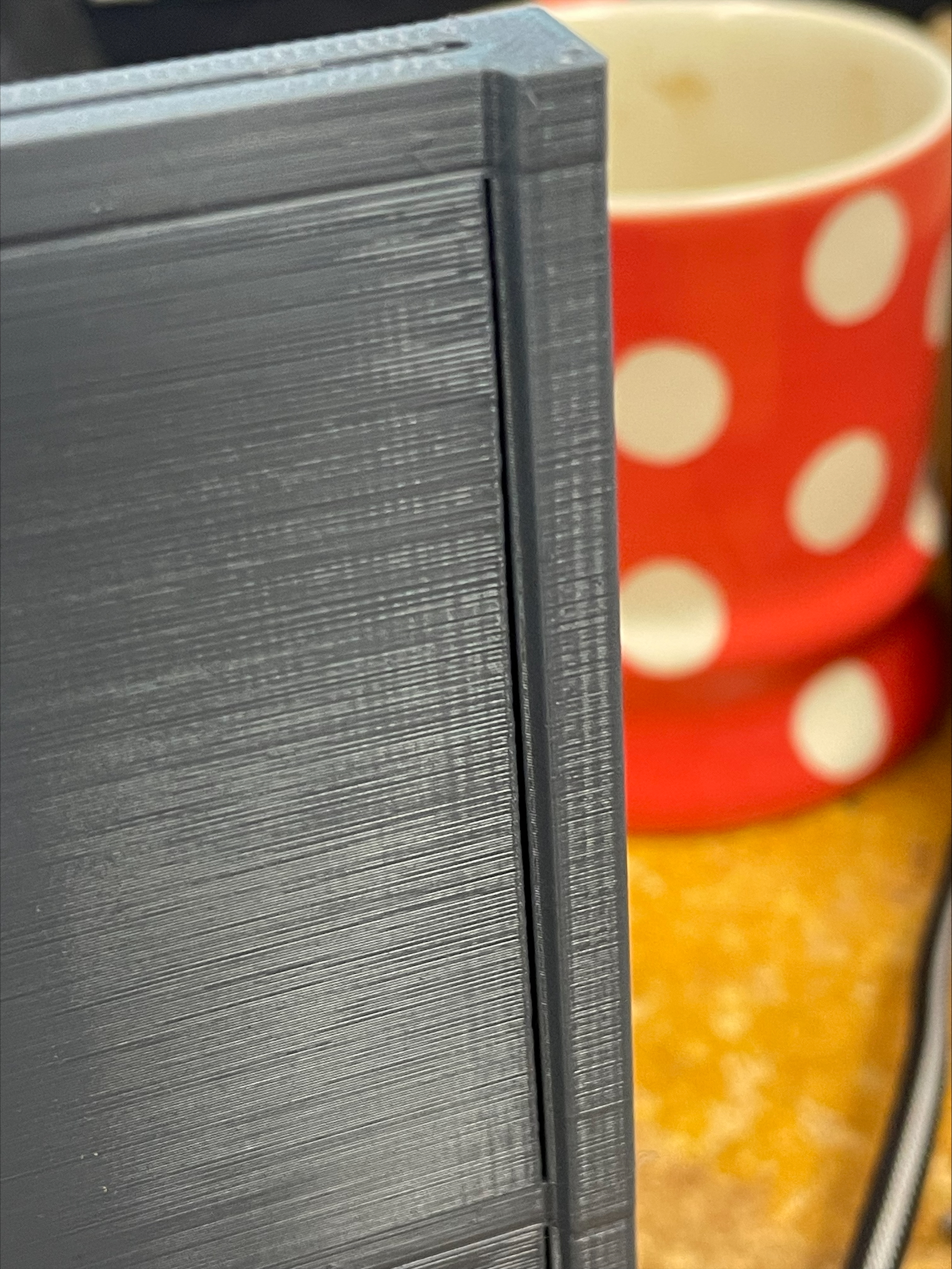

I am currently trying to print the object shown below, which has thin (0.5 mm) walls attached to some thicker spacers. For some reason, the thin walls do not attach to the spacers due to the path of the slicing. It should be connected as shown in the preview below. I have tried editing my geometry, chamfering it where the disconnection was, but this did not change anything. It has to be printed in the orientation shown due to a separate reason.
Any help on how to have no disconnects in the print would be greatly appreciated. My slicing settings are shown below.

Try a wall thickness of 0.86mm or 0.45mm to make the extrusion simpler, try making the end spacers an odd number of extrusions thick.
