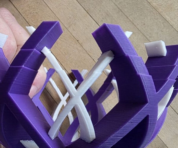

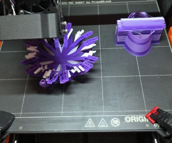

Since upgrading to firmware 6.5.3 with the corresponding MMU3 hex, I’ve been experiencing severe layer shifting on MMU prints—single‑filament prints remain unaffected. This model alone has failed 6 times, with layer shifts occurring at varying Z heights.
From a hardware standpoint, I’ve verified belt tensions, nozzle tightness, and the entire Nextruder assembly. I’ve also tried re-slicing, repositioning the model on the build plate, reducing print speeds (75%, 60%, and 50%), and even clamping down the control board using an old Creality mindset. Most shifts initially occurred along the Y axis, leading me to suspect plate movement. However, the final failure showed displacement along both X and Y axes (see second photo).
Posting this for awareness and also to see if others are encountering similar behavior. Is anyone else seeing this, or am I an outlier?

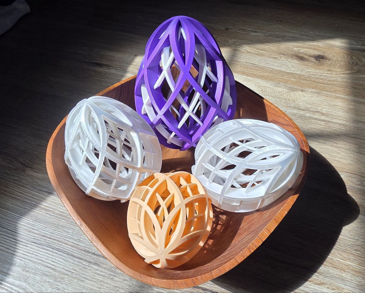

After downgrading to firmware 6.4.0—which has presented its own irritating issues to me—the print finally completed successfully without incident and subsequently two more MMU3 versions (not pictured) for Easter gifts.
