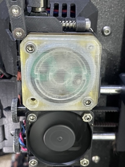

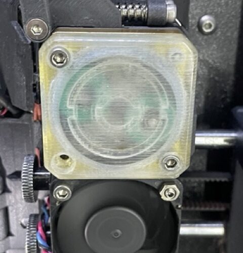

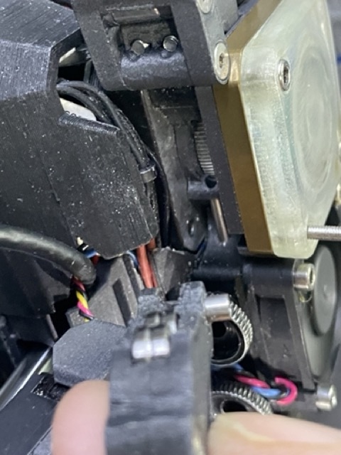

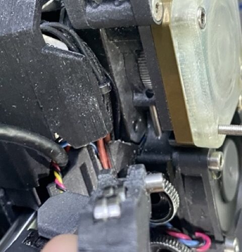

Just wanted to add another possible cause to the mix. I was getting errors, and the extruder was making bad noises while loading filament. Eventually, I found the problem by opening the tension latch and looking at the large gear that feeds the filament. The filament had completely missed the opening to the tube at the top end of the hotend assembly. It turns out that the bottom post of the main plate had broken off (don't know why) so the filament wasn't being guided to the tube opening properly.
If I manually guided the filament into the tube then closed the tensioner it prints fine. Obviously the main plate needs to be replaced. Fortunately, I found that the bag of spare parts has a spare main plate. I will use it, but I think I will also print my own main plate using the provided files. I noticed that the original part has only about 2 walls and pretty low density infill. I will print one that is all walls to make it stronger. Hopefully it won't break again.

In my case what happened is that the filament went down the side of the feed tube, because the bottom guide post of the Main Plate had broken off. With the spare Main Plate installed the filament is feeding just fine.
