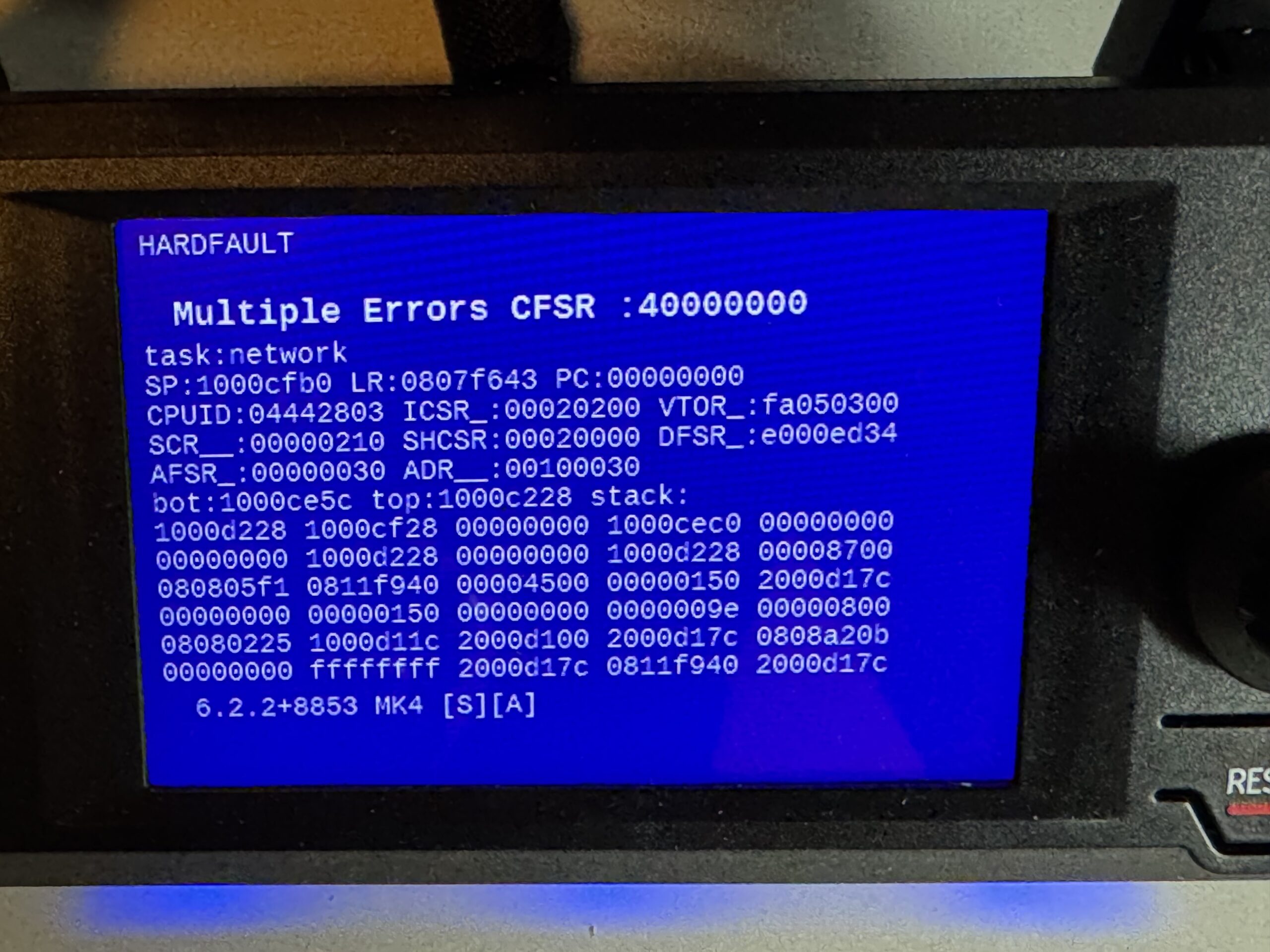

I've started having some very strange networking problems with my printer since I upgraded my MK4 to an MK4S.
The most recent is a DNS problem. My printer is connected via ethernet, and the network settings for it shows "-" for DNS server. The "Ping | Loss" section says "DNS FAIL" for "Connect". I just started a print via PrusaLink and was trying to check the camera via PrusaConnect when I noticed this, so I can't reboot it until the print is done. This happened before and turning off power to the whole printer fixed it. The reset button did not.
The DHCP server gives out two IPs for DNS servers on the LAN. I didn't have problems with it before, but is that maybe triggering a bug in the firmware? I can't really do much about that, since it would affect everything on the LAN. Does the "-" for the DNS server just mean it can't show two, or does it mean it thinks it doesn't have a DNS server?
Are there any logs I can somehow look at to try to debug what's going on? Is this a known problem of any sort? I am admitedly a bit behind on the firmware, on 6.1.4+7908. It's not the first weird networking problem I've had since I upgraded to an MK4S, sadly.

I updated the firmware to 6.2.2 yesterday. Today while I was out, I got a Prusa app alert about a printer error. I got home to a printer beeping and some kind of network task error. I don’t know why this printer is so unhappy about the network in general!

Looks like some incompatibility between the printer and the DHCP server in your router.. hard to know what is going on without using a packet inspector to look at the DHCP info being exchanged.. did you ever try  a static IP setting to set all the IP parameters?
