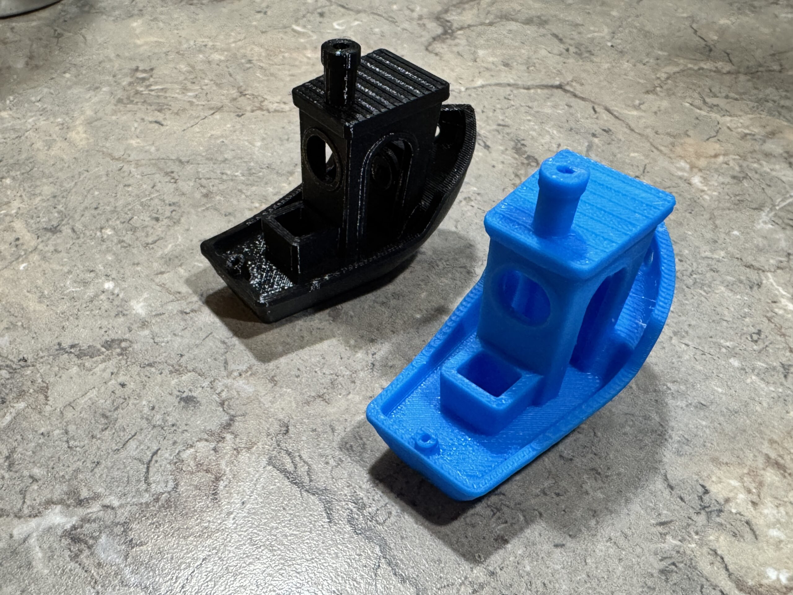

We bought a MK4S for Christmas because we liked the MK3S that we have and wanted an upgrade to speed things up. I haven’t had much time to mess with it but at work we just got a Elegoo Centauri Carbon 2 for prototyping, which I admittedly scoffed at, but I am in charge of running it so I had to set the machine up. Long story short, that machine absolutely hauls ass and is dead nuts perfect. For something that was less than $300, it kicks the shit out of my $1000 Prusa machine, at least on speed. I printed a Benchy on each machine with the same nozzle size and layer heights and they both came out beautiful. The problem is the black one came from the MK4S and took about a hour, while the blue one came from the Elegoo and it took about 14 minutes. What gives? Admittedly the blue is PLA and the black is Prusament PETG, but that shouldn’t make it take 4x longer. I don’t get it, and there is no IS profile for my machine so I can’t find how to enable that either. Any tips?  Before anyone asks, I did search through the forum and could not find any definitive answer as to why this machine is so slow or there is no input shaper option. As advised by Prusa, I’m trying to get the machine absolutely dialed before we put the MMU3 on it. Thanks in advance for any help you can give me!

Were both files sliced by you?
For the MK4S, there is a pre-sliced 14 minutes PLA Benchy on the USB drive, so about the same speed as the Elegoo.
This is absolutely dialled in to push the limits of the machine, while the standard profiles in PrusaSlicer are tuned to give reliably good results.
Might be the same for the CC2?
Also, a standard Benchy sliced with 0.20mm Speed profile gets me a time estimate of 37minutes in Prusaslicer for the MK4S, which is usually pretty accurate, so I don't know why it took an hour in your case
Definitely could be, but parts that we make in house are just as speedy and not from a website or anything.
Also, a standard Benchy sliced with 0.20mm Speed profile gets me a time estimate of 37minutes in Prusaslicer for the MK4S, which is usually pretty accurate, so I don't know why it took an hour in your case.
Ya me either, that’s what’s confusing. My MK3S is faster for a Benchy than my MK4S so I’m obviously missing something, I just can’t figure out what it is.

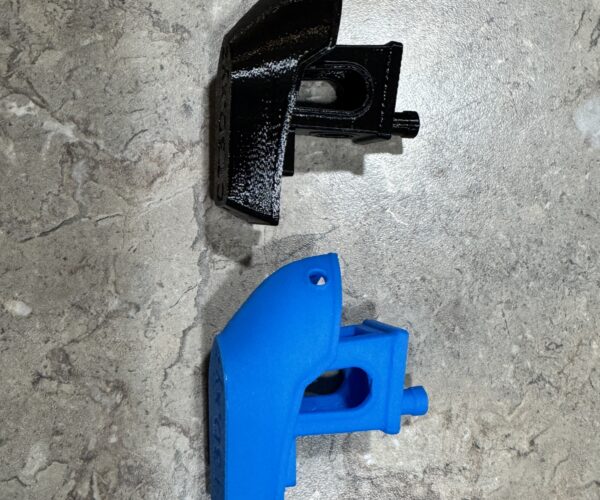

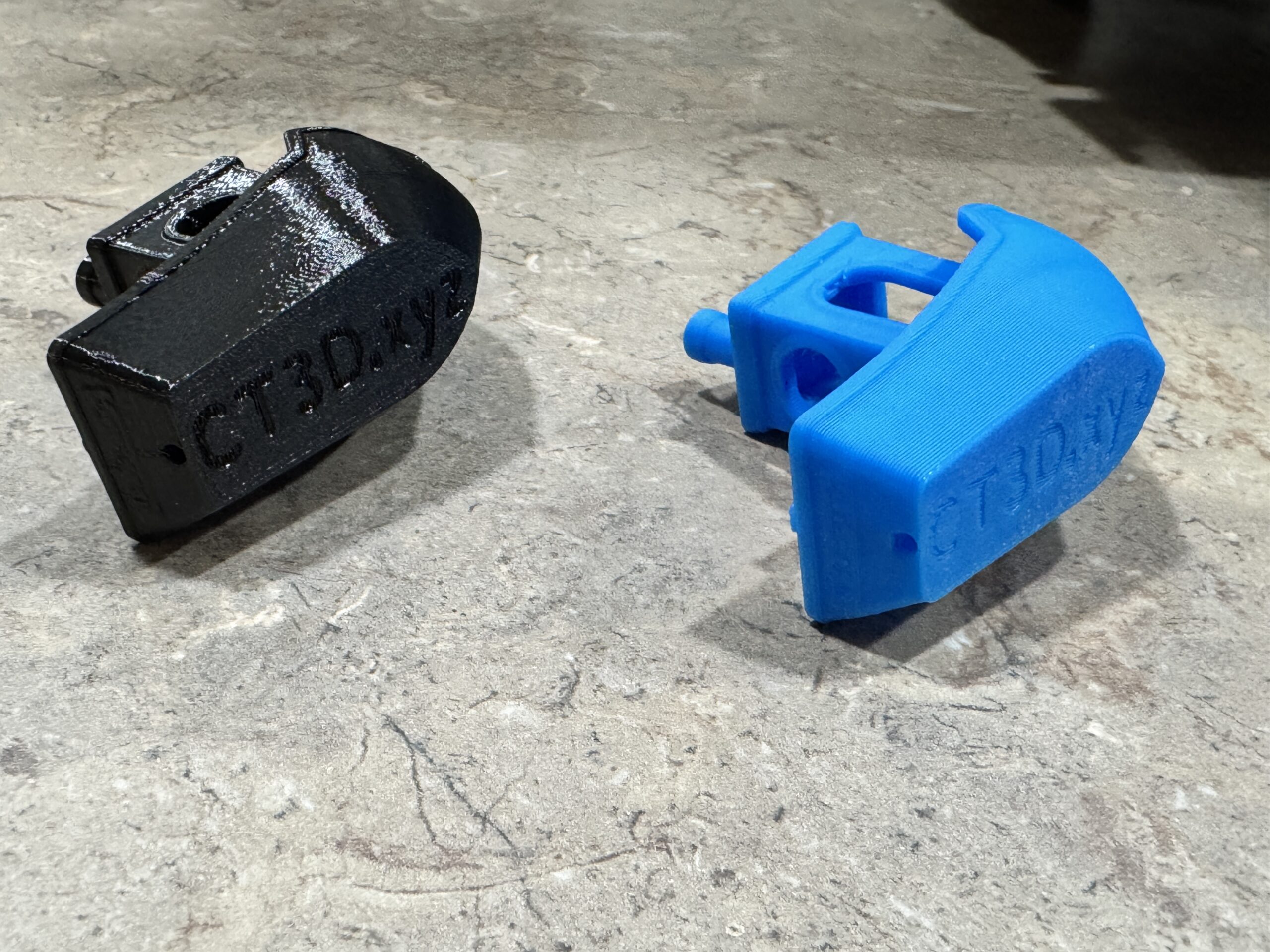

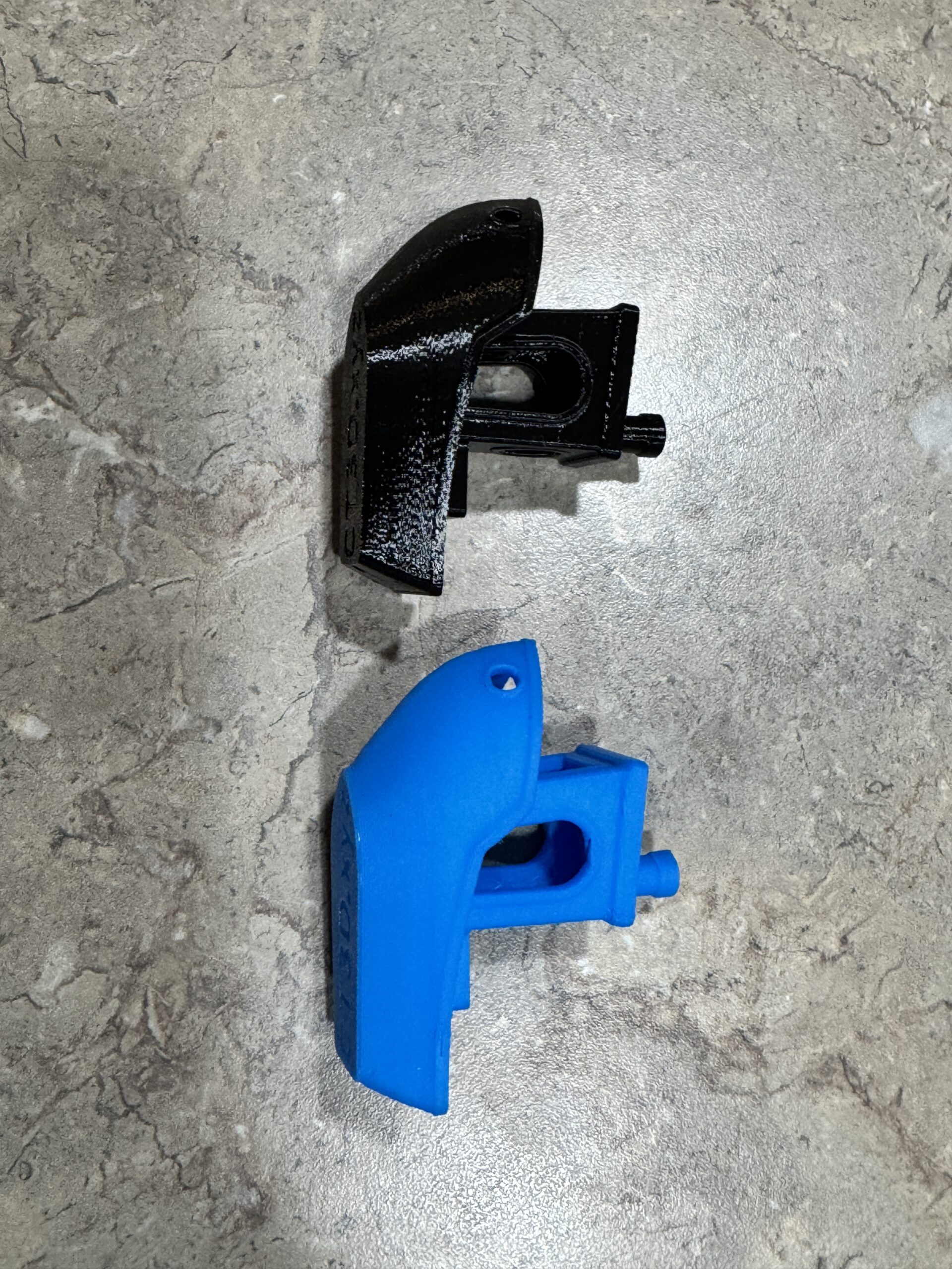

What brought all this up is there is a 2 piece part that we make at work for tooling that the CC2 estimates a little over 4 hours total print time and I had to catch a flight back home so I said “fuck it, I’ll print it on my badass new MK4S at home!” Then I loaded it into Prusa and it was 1 day and 11 hours print time! So that’s when I knew I had something wrong, not just need to figure out what!
