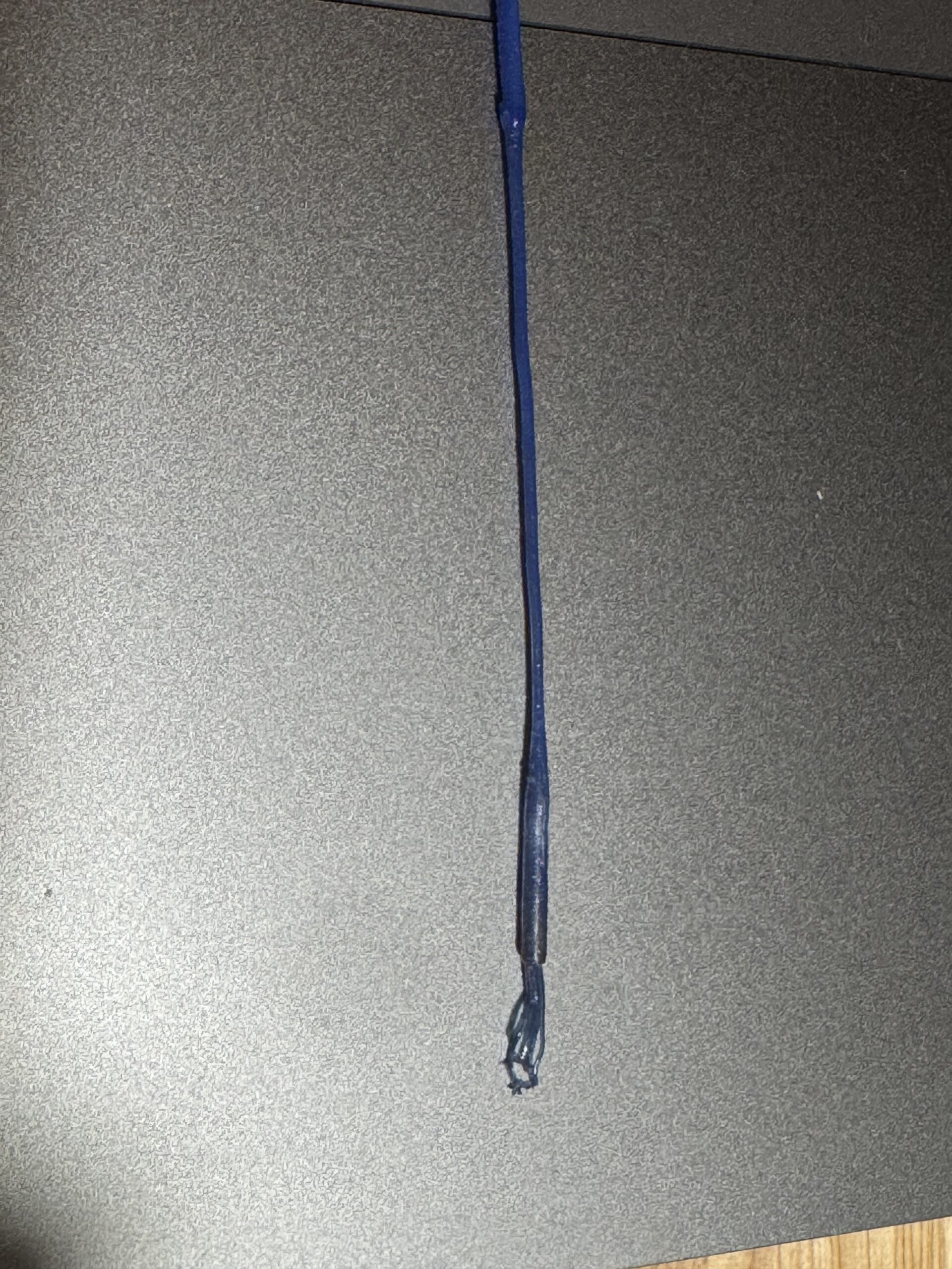

you guys are wrong, cold pulls definitely work on nextruder HF nozzles:
Posted : 16/01/2025 11:18 pm

Yeah - a cold pull itself is working but the result is misleading. You see three strands but what if the obstruction is beyond the end of the strands were they unite? Currently got into this problem and am throwing away the hf nozzle.

Indeed. If one channel is obstructed the material will not really enter there because the other (open) channels will shortcut it. Therefore the obstructing particle will not be 'embedded' sufficiently to pull it out.
Also the 'peel' effect will be less effective. When you pull out the filament at a cold pull you see the half-molten filament is strained and contracted. In the contraction it peels any debris from the walls. In a standard nozzle with simple inside geometry that works well, but quickly gets less effective for complex geometries.

On a good cold pull  you see clearly the internal conical shape of the nozzle and a tiny cylinder at the end, corresponding to the diameter of the orifice (0.4mm in this case ).
