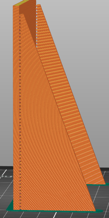

I have created some custom supports that could be used for this purpose, note the thin spikes along the vertical edge in the screenshot. These spikes should just touch the back face of the lithophane model. Check in the slicer preview that they actually touch the lithophane part. Like this the supports can be removed easily. I have attached the 3mf file with the parts and a fusion project if you want to adapt it.
I had added the hex pattern to the supports to save on filament.
While I must say that I had not tried to print those supports before uploading them here, I have just started a test print on my MK4S here and the supports print just fine without failing, see screenshot below. PrusaSlicer gave me a warning about print stability and suggested adding a brim, but I did not do that. What could also be important is that I merged the supports with the lithophane part and checked that the layers go through the supports and link all the parts.

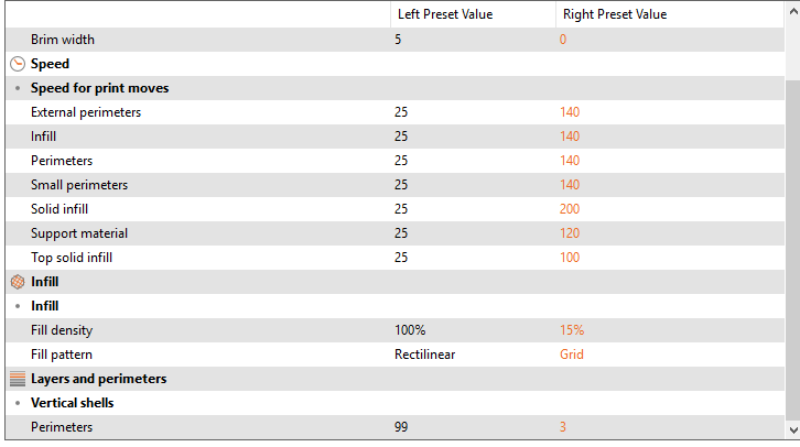

On a first fast attempt I used the 0.10 fast detail profile with the following changes: enable brim, infill 100% and rectilinear infill, this failed about 30 minutes in.
I then did a second attempt (the one in the pictures) with the same changes over the default 0.10 fast detail profile (enable brim, infill 100% and rectilinear infill) plus setting perimeters to 99 and decreasing speeds to 25mm, here is a picture of the comparison with the default.

For the more horizontally inclined fans of hex patterns I have added another variant of the supports. Hex patterns in this orientation I have used and printed successfully before in other projects.

I always set the number of perimeters high enough so that the slicer does not create infill, which I check in the preview. So the print consists only of perimeters, then the settings for infill become irrelevant. You say you set the perimeters to 99, then you can forget all settings for infill type etc. You do not want empty cavities in a lithophane, it should be solid through and through. I have always had success with this setting. I have used the 0.1mm fast detail profile for lithophanes sometimes, I also printed one or two with a 0.25mm nozzle on my MK3S, but I mostly use just 0.2mm structural and I use the default speed settings from the profiles and do not reduce the speed.

I have started the print with the 0.1mm fast detail profile and substituted one of the supports for one with the horizontal orientation of the hex pattern to be able to compare. The horizontal version prints much cleaner and the vertical one has problems with the 0.1mm fast detail profile.
The print is finished. The horizontal pattern is definitely better suited for this. I have appended the PrusaSlicer project I used.
