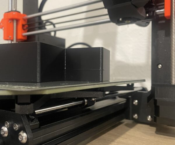

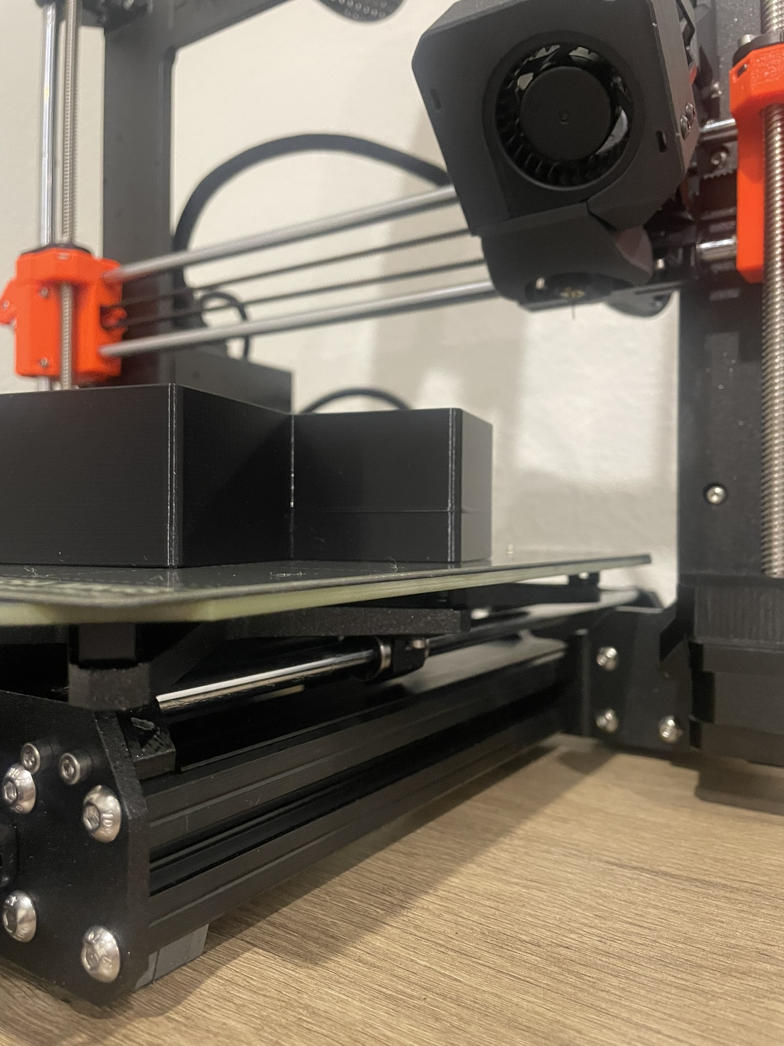

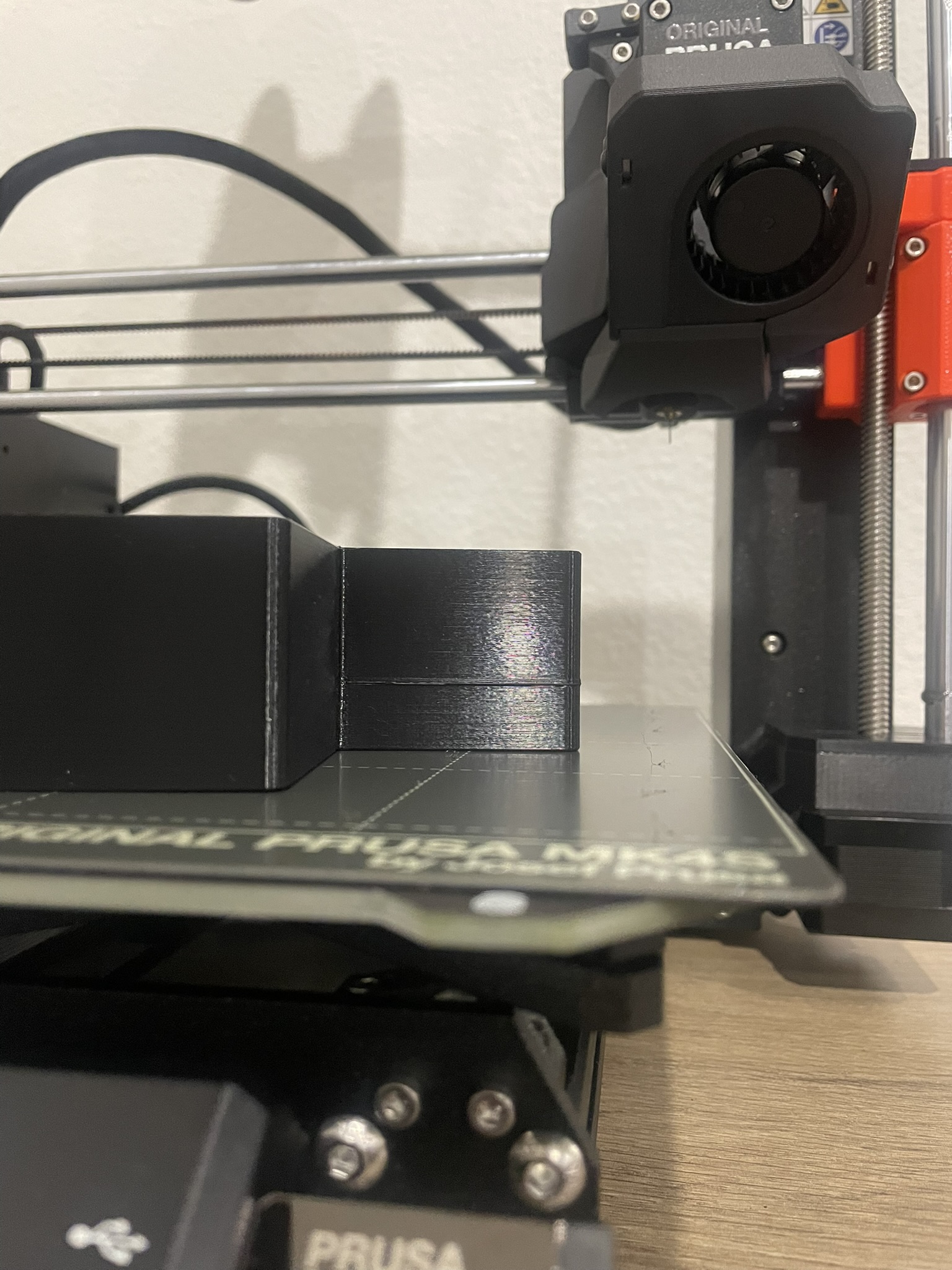

Hi I'm very new to 3D printing. I recently just got the MK4S and have been having a blast. Problem is that it seems that on some of my prints there seems to be a single layer getting misaligned but the rest of the print is perfect. It's not even the entire layer that is misaligned, just that section of the print itself. The printer was pre assembled and less than two weeks old. This print was done with Prusament PLA Jet Black with the default .20mm Structural and Prusament PLA settings. I did tweak the outer perimeters to be 4 layers and a cubic infill as an experiment but other than that I didn't touch anything. Any advice would be appreciated!

I have also seen some "spot anomalies" on prints from my new MK4S, and am still observing it to watch for any predictability.
In your case, does it seem like the part has released from the print bed in that area where you see the malformation? As the part grows, particularly if you have internal geometry that causes the part to contract as it cools (i.e., solid layers), it can cause the edges of the part to release from the print bed. That can make the part warp upward, causing interference with layers above it. After a few more layers are applied, it usually settles back into its intended Z axis height, with a bit of "mushrooming" in the problem area. You can check this by shining a light from behind the part, and looking at it from the level of the print bed. If it has released from the steel sheet, you'll see light through the gap. I've experienced that more times than I can count. After getting over the frustration, it makes one seek to understand the art form more, and adjust variables to prevent it.
If your case is, in fact, a G-code glitch or something like that, I will watch this thread eagerly. 🙂

I have had similar issues with my new MK4S.  A print would randomly produce a horizontal section with, what looks like, a missing layer.  It can range from a half-inch long to 2 or 3-inches long.  I can’t tell whether it’s a z-axis issue or an extruder issue.  I have spent about 20-hours (over 4 or 5 different sessions) with Prusa Chat with no real cause or solution.  The level of expertise varies depending on the tech. who connects with you.  Be careful, one tech suggested taking the printer apart and checking the z-rods to see if they were bent.  I thought that wasn’t practical and I felt if they were bent, ever print would have an issue…so use your judgement on their advise.
Here is what I gathered from Prusa:
1.) Yes, as mentioned above, the print partially lifting can cause an artifact that looks like the layer issues that you see in the photo and the model layer issue that I discussed.  You can look at the bottom of the print when done, and hold it up to the light at various angles and you can sometimes see a subtle texture variation that suggest the print partially popped off the bed…usually a corner.
2.) The issue could be a bug in Firmware.  If so, Prusa tech said to wait for next firmware update to see if it goes away.
3.) Could be a bad file.  In my case however, the same file can print with or without an issue…it’s very random.
I have been researching the web to see what I could find.  One thing I tried, and it seemed to work, so far anyway, is to replace the Prusa Flash Drive with a SanDisk USB 3.0 as I discovered that the drive reads & writes data to/from the printer and, sometimes it’s too slow or corrupted, so it can interrupt the gcode flow to the printer…causing a missed command, etc.  After 3 or 4 prints, I haven’t seen the issue return…in fact, unless it’s my imagination, my prints actually look slightly better.  I’m not getting too excited though, I’ll need to see many prints come out flawless before I think the issued solved.
