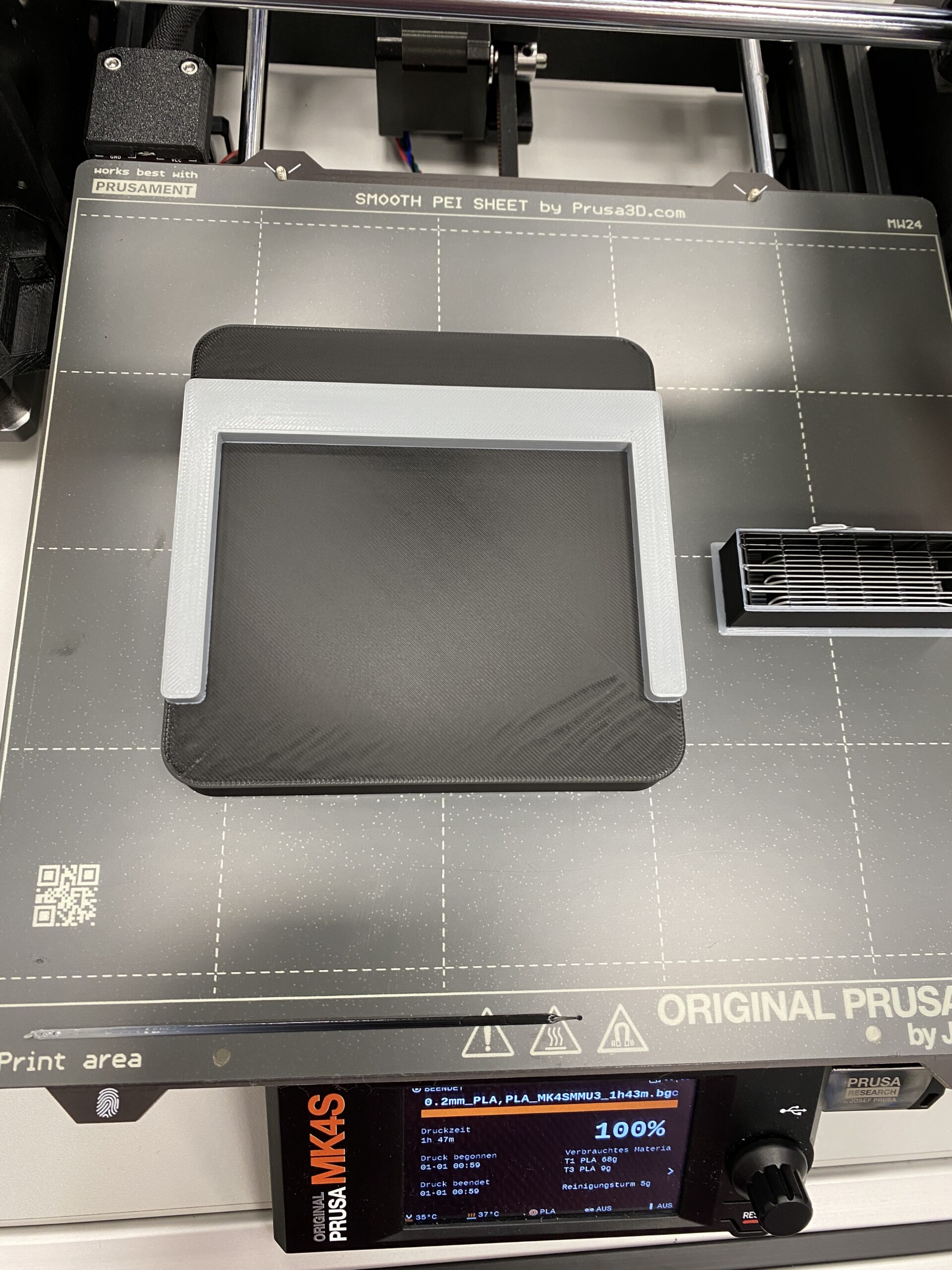

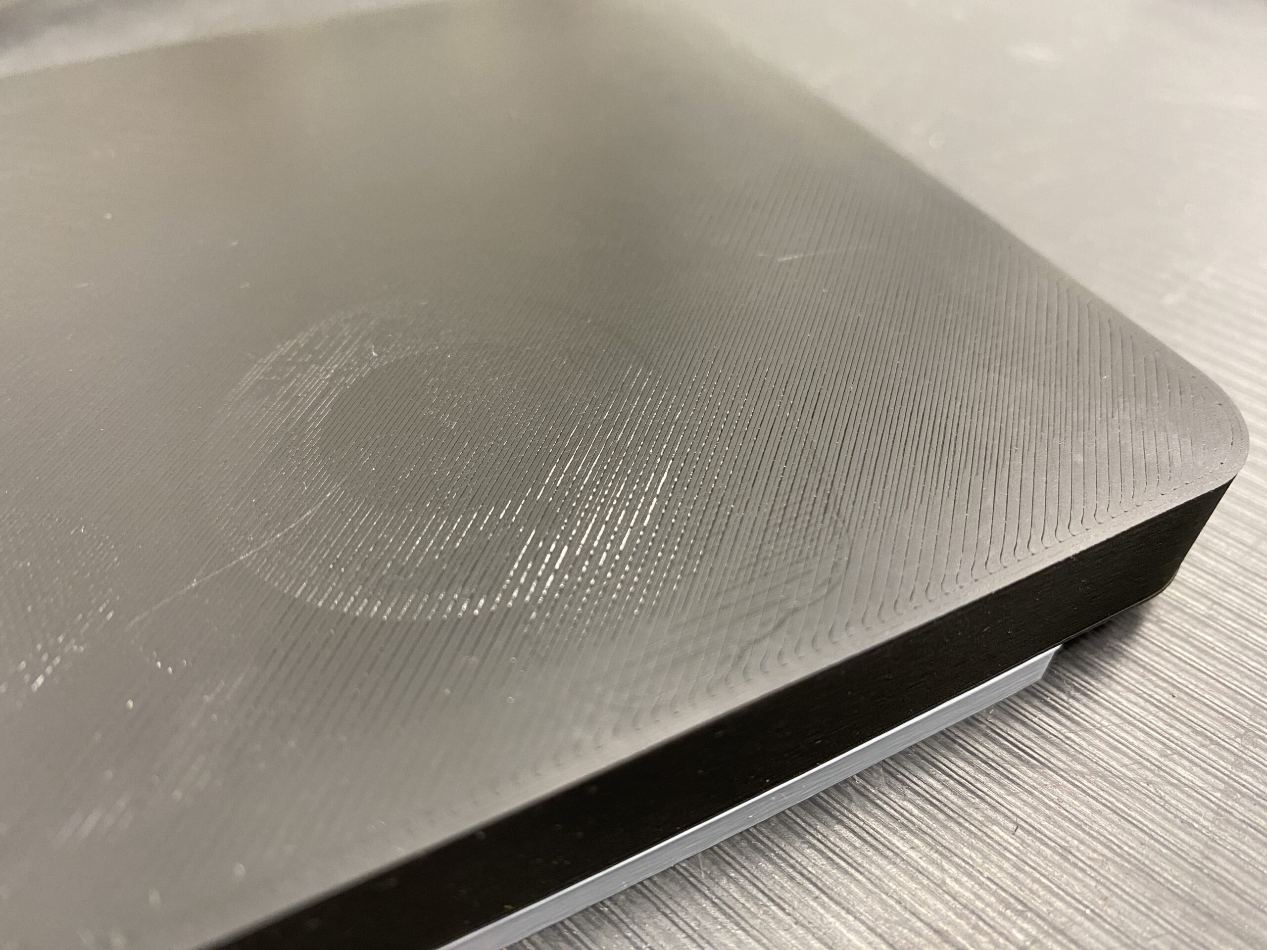

When I print with my new MK4S MMU3 combi, I get this wierd over-extrusion or other artefact on top layers. Strange, that not all top layer is affected. One side its clearly visible, the other side is beginning to show signs of over-extrusion. All arround the part in the last 3-5 layers a lip has formed, that could also show a sign of over-extrusion?!
Does someone have an idea, what my problem could be?
Thank you.
From below, Lip is visible:
From the side, Lip is visible:
Gradient on the surface, middle seems to be unaffected
Closeup on the failing area:
overview:
Posted : 28/01/2025 2:51 pm
You have some warping.  Clean your print sheet, dishwashing detergent (Dawn/Fairy) and plenty of HOT water.  Make sure you are not printing in a draft.

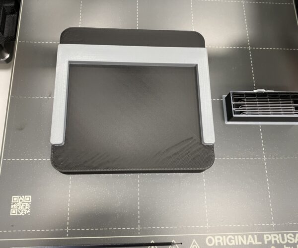

I cleaned the bed as described and put the printer in an enclosure. Same model, same problem.
I have an old Ultimaker 3 where I had to apply glue for better adhesion.
My Anycubic Kobra 2 Pro at home has a rough PEI build plate. I never had to worry about any bed adhesion with it.
Now after my first prints with the MK4S i have not one successful print. A Brim might help, but from now on printing only with Brim is a pain.
Are there other solutions, I could try?

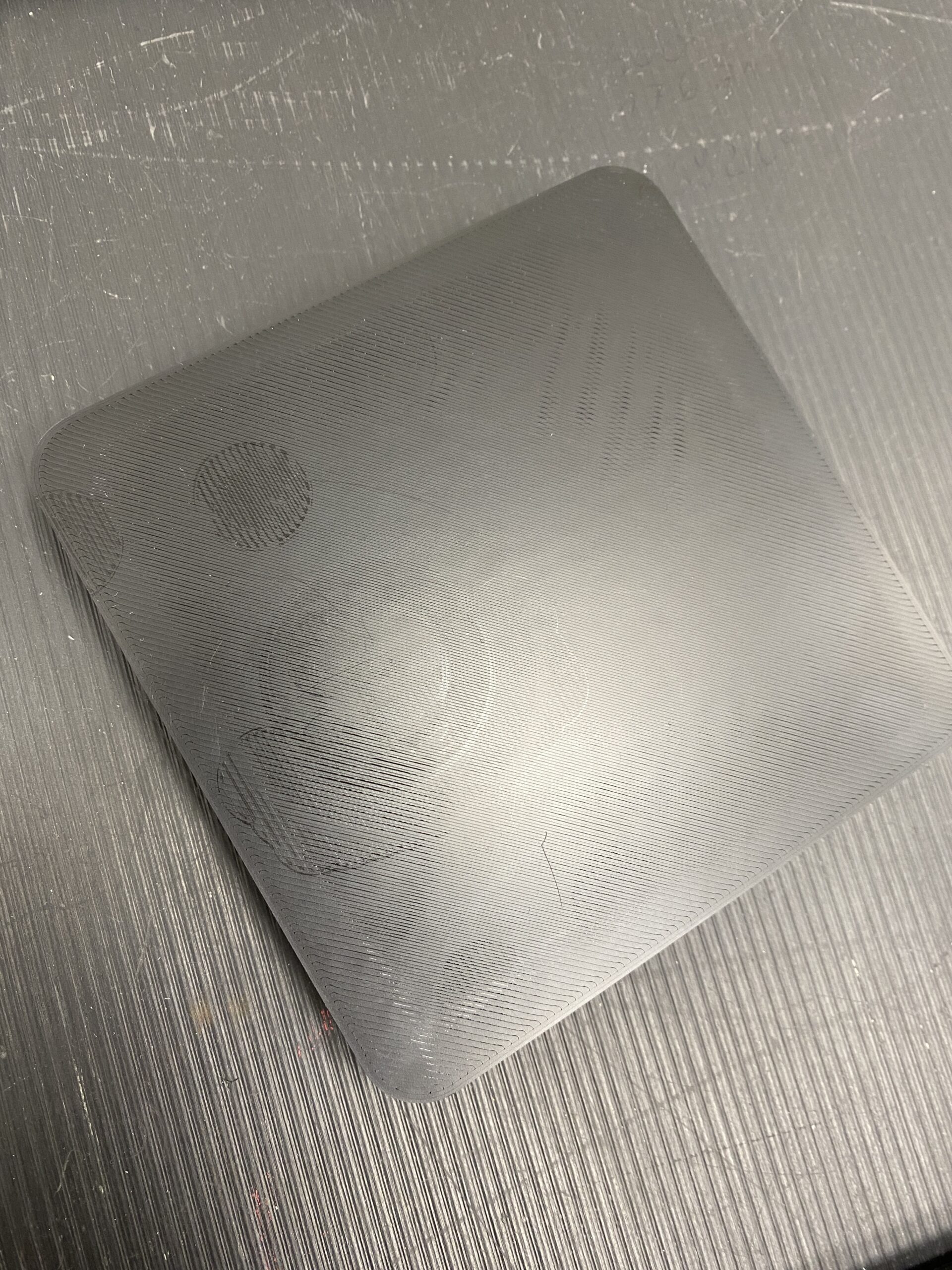

Some improvement but not enough - please show us the underside of that last print.

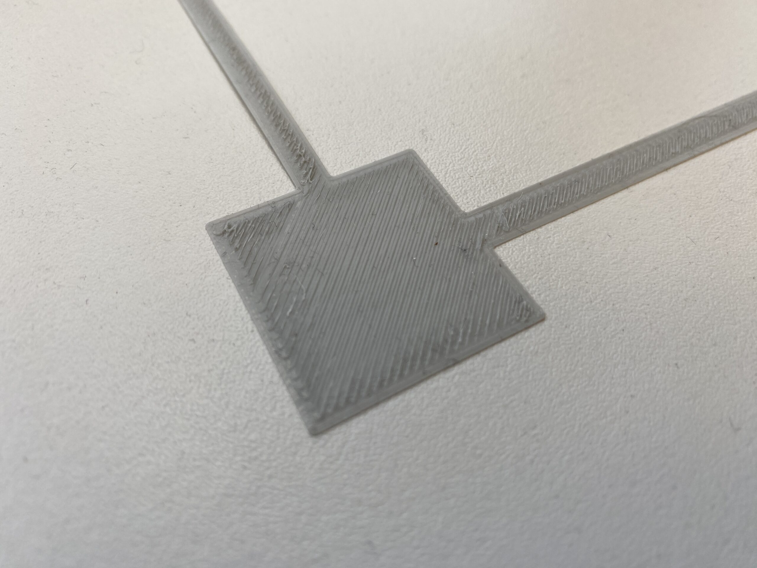

I just printed a simple first layer bed level test. Bed is level, but the Z offset seems to be to low. can't find the settings to change it tho.
If the first layer of a print counts that much, does it affect my problem as well?
Posted : 30/01/2025 11:45 am
Tobias
(@tobias-7)
RE: Over-extrusion Top-Layer or other Artefact?

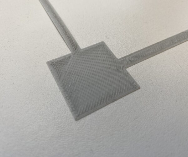

A different file for bed level test in gray shows my untrained eye, that the nozzle is a bit to low. The underside shows trapped air pockets between the lines. I can feel these pockets with my fingernail.
Posted : 30/01/2025 12:30 pm
Still some loss of adhesion, let's try a more drastic clean.  (Sc)rub neat dishwashing detergent into the surface of the print sheet, leave for five minutes, then rinse clean with *VERY HOT* water.  Dry with a fresh paper towel handling by the edges only and finish drying by placing on the heated bed ...  We normally assume the contaminents are human fingerprints, filament residue and PEI oxidants but if you are using aerosols in the same room, or spraying paint, laying fibreglass, arc welding - anything that creates dust, smoke, spray. You get the idea. The bed needs to be clean.
If the first layer looks too low you can try raising the live Z offset from the LCD menu while watching it go down and see if it helps.

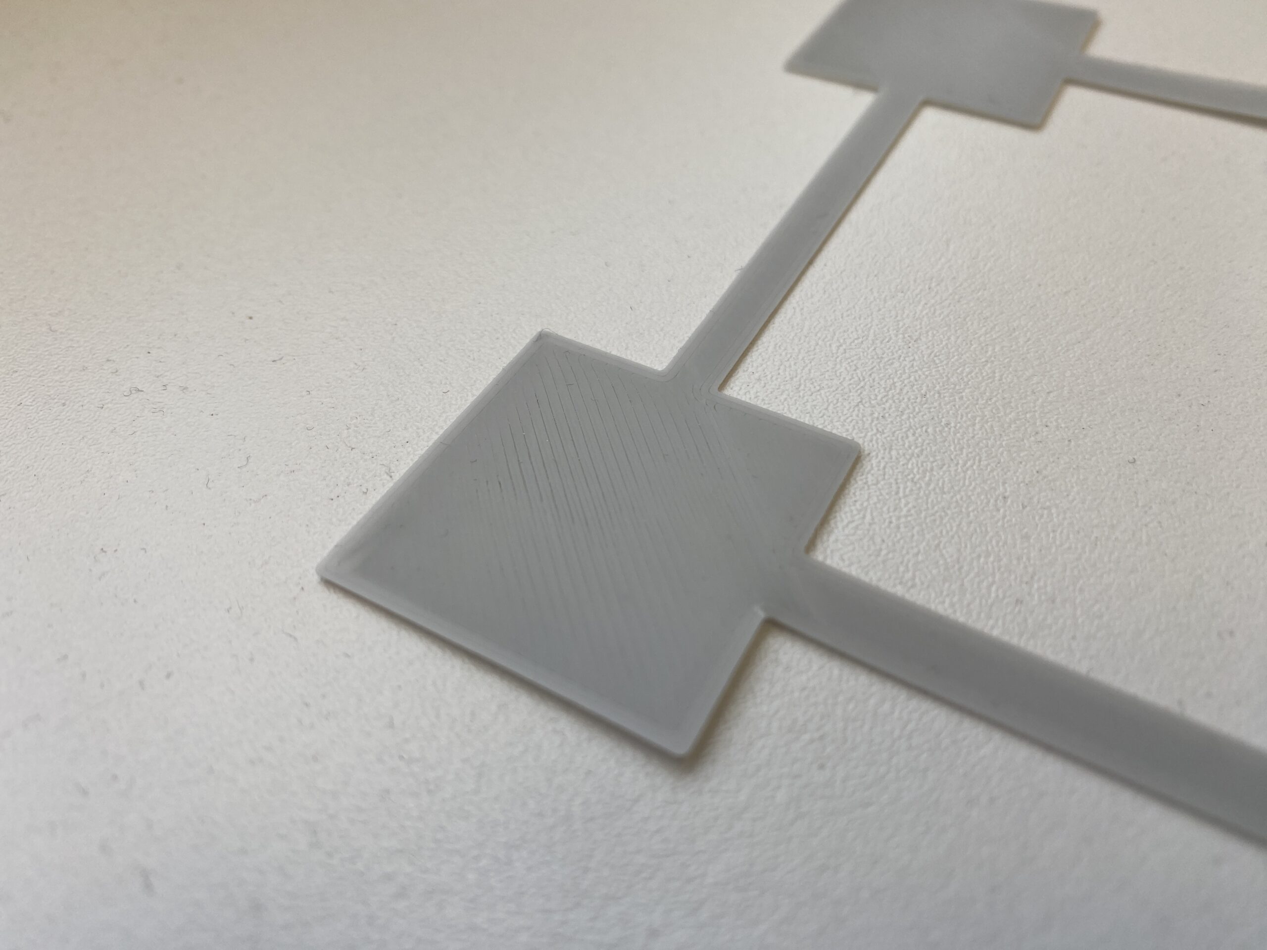

I couldn't find the Z offset settings on my MK4S, but after some searching I found the setting in the Slicer under Printer and raised it +0.05mm.The first layer looks better now.
You may not be so wrong about the a aerosols. I'll try the deep clean method as soon as possible. The printer arrived before the enclosure was finished. So it sat in a corner of a larger room with a large CNC mill and lathe for a few days. (coolant, etc.)
You seem to be a fan of dish soap 🙂 Would you substitute it with isopropanol?
