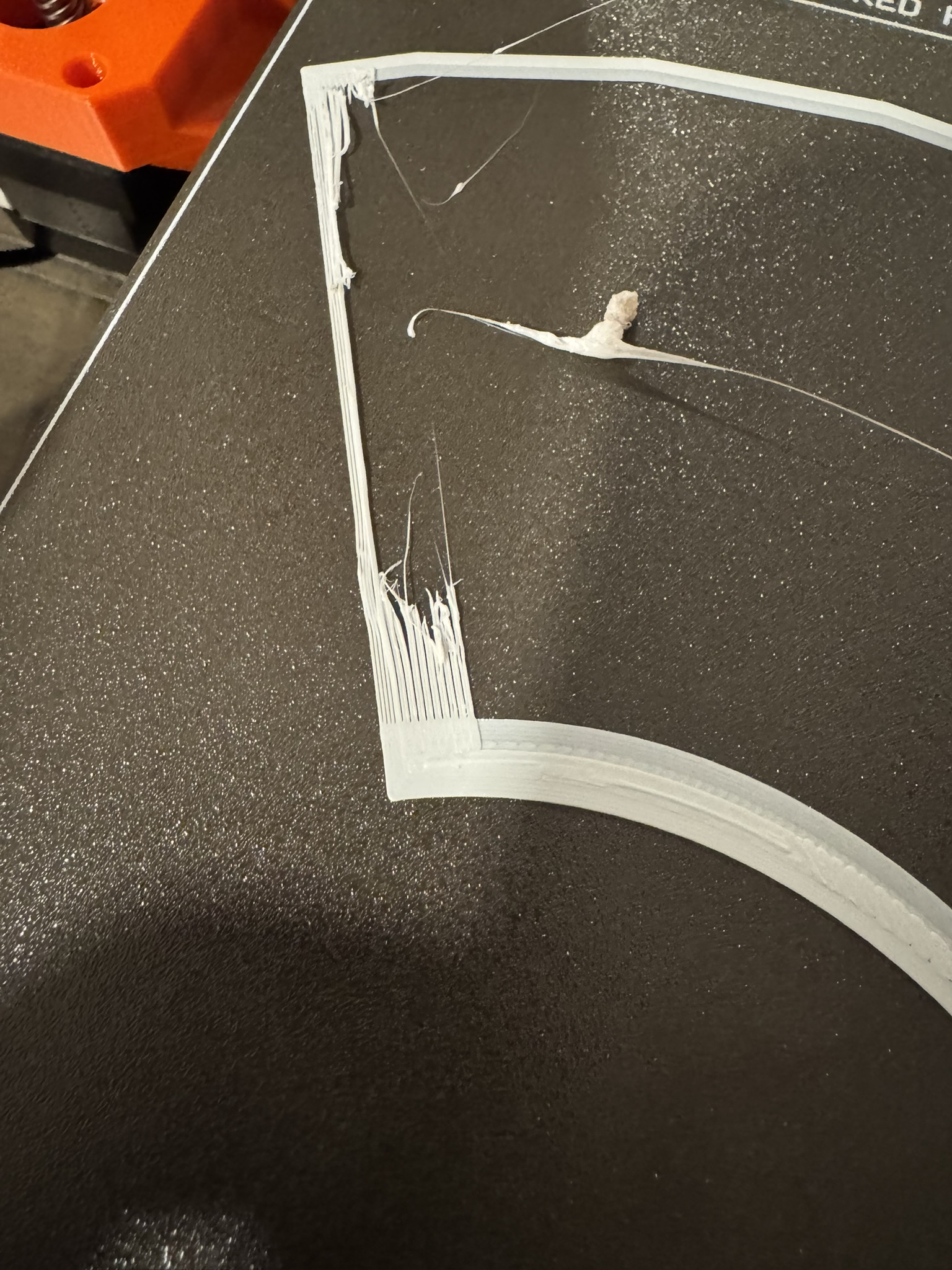

I have recently upgraded my printer to the MK4S and I am experiencing some first layer issues. In the image, it looks like there are gaps in the first few lines. I have never seen this before when printing with the MK4 before upgrading. Then after those first few lines go down, it seems that the nozzle is dragging across the print and causing it to clump up. Is this an extrusion issue or a z offset issue? I remember changing my z offset when I first got my printer but I do not remember what to. I am also new to this high flow nozzle. I would appreciate any direction I can get on getting this solved.

Is the nozzle loose?

  • Are you using the high flow profiles in Prusaslicer?
  • Make sure the nozzle type is set to high flow in the hardware settings section of the LCD menu on the printer. Some firmware versions set it erroneously.

I'm not sure what could cause this, maybe loosen the nozzle, make sure it's pushed up all the way and tighten.
If that doesn't work I'd reach out to support.
Posted : 24/03/2025 1:37 pm
RE: First layer issues with newly upgraded MK4S.
I'd swap the HF with a regular flow nozzle, to see if that makes a difference. I gave up on the HF after a week. Hardly any meaningful difference in speed but a bunch of issues, so why bother.

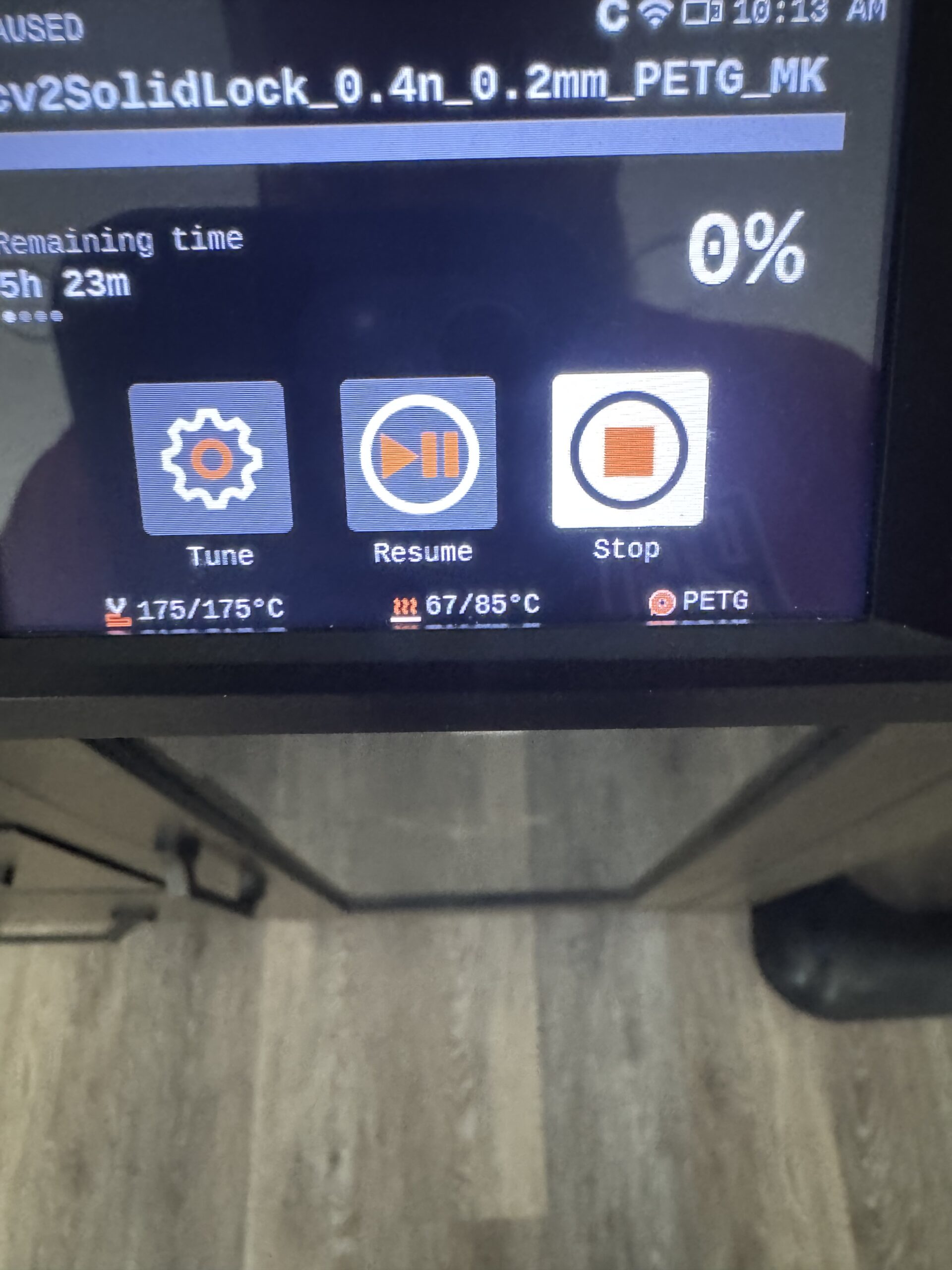

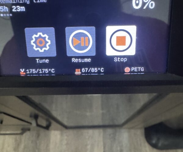

I think I found what could be the issue? If you will notice I am printing with PETG. The nozzle temperature is only going to 175. The spool recommends 230. I have PETG selected as the filament when I loaded it into the printer and also selected in Prusaslicer……..So why is the printer only going to 175?

That is during the bed probing stage, yes? That is so the filament does not drip all over the print sheet during probing. The temp should go up after bed probing is finished and before the start of the actual print. You can also see on the display that the bed has not yet reached the final temp for printing.
Posted : 24/03/2025 2:26 pm
Yes, that's the "no leak" temp while the bed is heating up for MBL.
Not sure what that means? There's no way to change the z offset on the printer? Do you mean in the slicer printer profile? In which case I'd set it back to zero.
With PETG and the textured sheet I find I need to manually adjust live Z when the print starts. After bed leveling and the nozzle and bed having reached target temps, as soon as the print head starts to move to the print the start line, long press on the knob until the live Z adjustment menu pops up. I set live Z to -0.03 or -0.04 for PETG. Marketing of course claims that with the load cell the first layer is always perfect but enough people have reported issues on Github and the need to make live Z adjustments that I think that's a myth.

Did the self-test routine after performing the upgrade run successfully for all the axes? Did you have to repeat one of the tests or did it run successfully to the end at first try?
Z offset is located in the Printers tab of PrusaSlicer:

Could there be something stuck between the print plate and the surface of heated bed there? Even a small piece of debris can cause some unevenness of the print plate. I have seen that sometimes on my printer when during the bed probing the nozzle goes up and then down again over a certain spot on the plate. Usually there is a little piece of filament debris under the plate.
