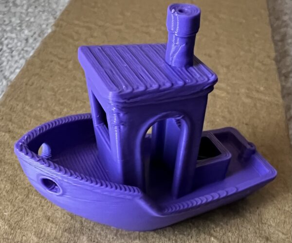

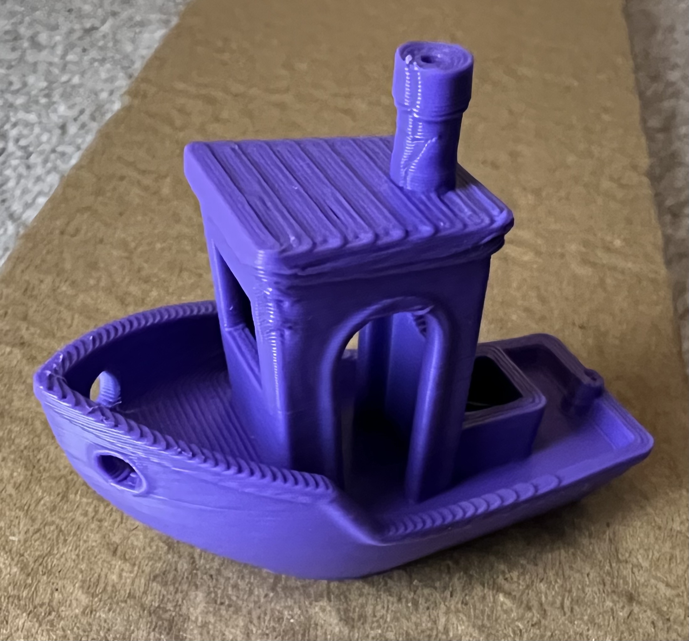

Hey everyone,
Could anyone please tell me what’s happened here?
It was my first print with brand new factory assembled MK4S, in Prusa enclosure with doors open. Overture Super Pla+
Used pre-sliced 14 minute benchy from the USB drive included with the printer. Set for PLA in the printer’s menu.
There was a filament jam mid print, maybe half way up the hull of the boat.
Cheers,
Omar

I wish Prusa had never included that file on the USB.
For a racing speed benchy on a brand new machine using PLA in an enclosure: that's pretty good.
The standard benchy is a torture test to be used to check most of the parameters affected by fine tuning, frankly, a perfect benchy, whilst good, is irrelevant on a newly built machine or a transit-shaken prebuild as most of the fine tuning will drift as the printer shakes down and runs-in. All the initial setting up will have to be rechecked at your first monthly maintenance session after which there is a good chance the machine will remain stable indefinitely.
The Bonkers Benchy is just that, bonkers, it is a nod to a minority sport racing to produce a benchy in minimal time - in the process it loses most of the benchy's useful diagnostic properties and just produces a flimsy, useless, trinket. That said, it is only printable on a perfectly calibrated machine but may well stress that machine so much that it needs attention before attempting a second one.
