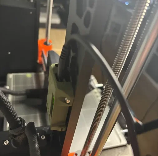

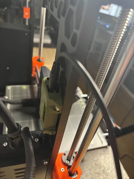

Hi, I went through your videos again and noticed that the holder I’m using doesn’t provide a good connection between the cable and the board (2.5mm jack) 🙂
Link to the model: https://www.printables.com/model/1016997-prusa-gpio-hackerboard-cover/files
I’ll be redesigning it! 🙂

RE: GIPO - Canon EOS R8 - 2.5mm
It still won’t take any pictures for some strange reason.
See the attached images—I'm using the same code you provided, with focus enabled.

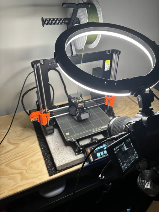

Does the camera reacts when you try these steps?
Posted : 08/02/2025 9:38 pm
512MB
(@512mb)

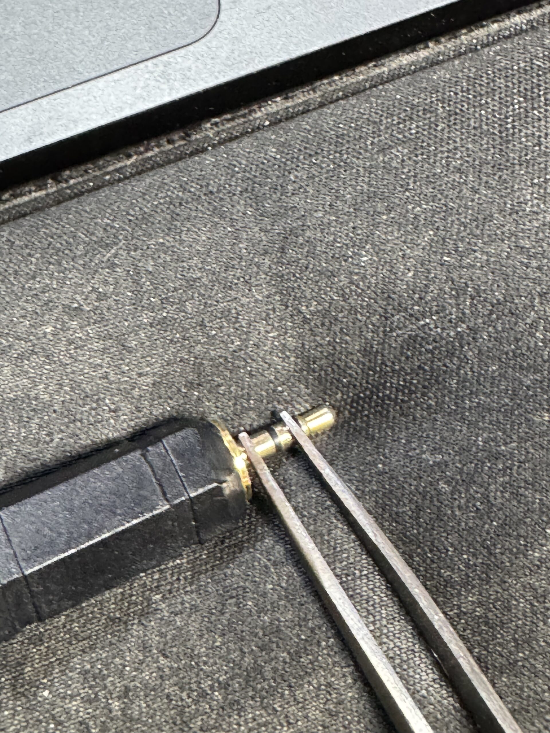

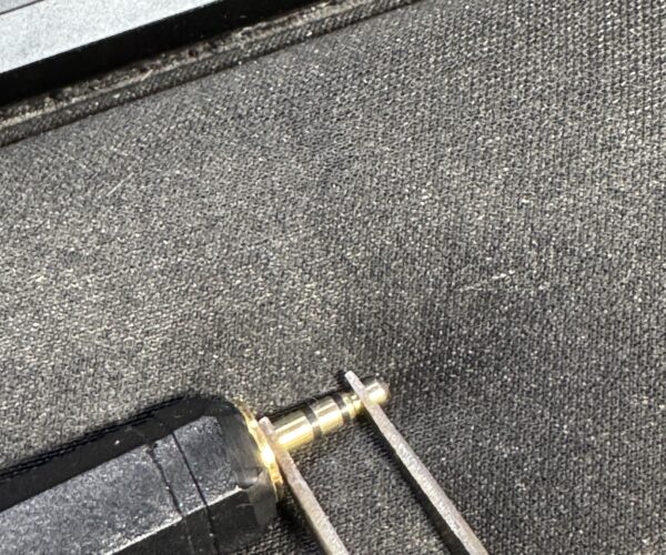

Hi!
I solved the issue by testing with a different 3.5mm to 2.5mm adapter, and it worked! It seems the original adapter was faulty. The camera now responds to the shutter command you provided.
Everything is working perfectly now, and I just want to thank you again for your dedication and detailed responses—they truly make a difference!
