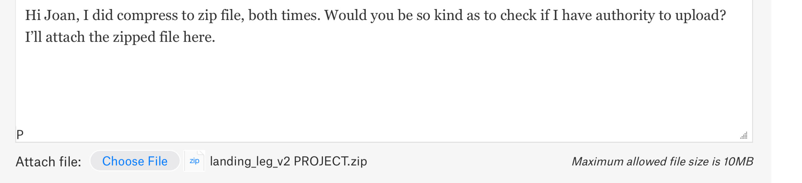

RE: trouble orienting Falcon landing leg
Hi Joan, I did compress to zip file, both times. Would you be so kind as to check if I have authority to upload? I’ll attach the zipped file here.
Posted : 24/08/2024 1:36 pm
3DBob
(@3dbob)
After replying to you, with attached zip, I see that my post is “awaiting moderation”. Thanks again.
