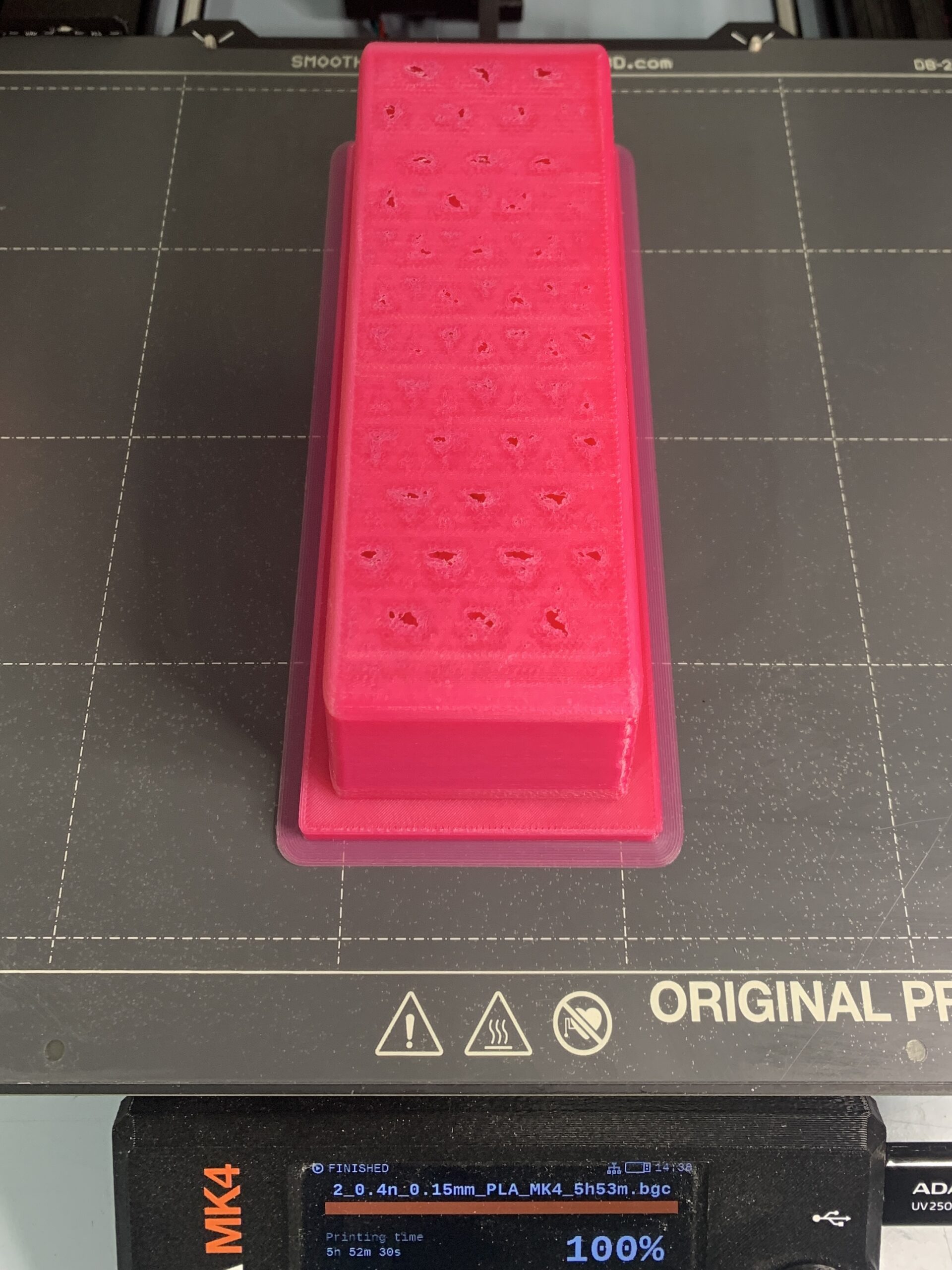

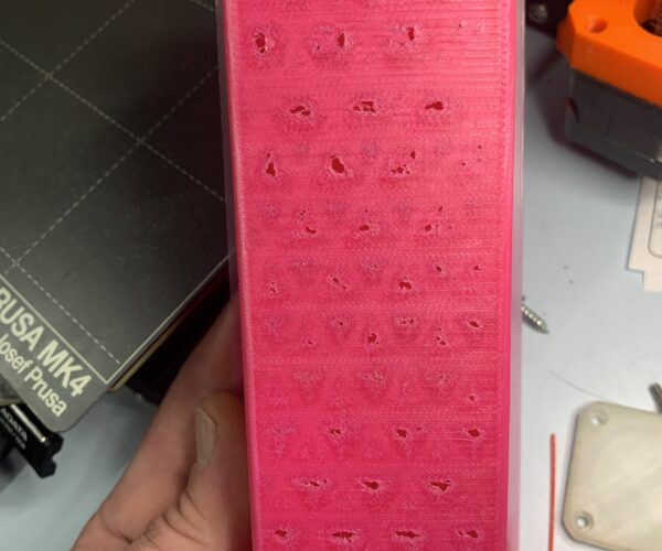

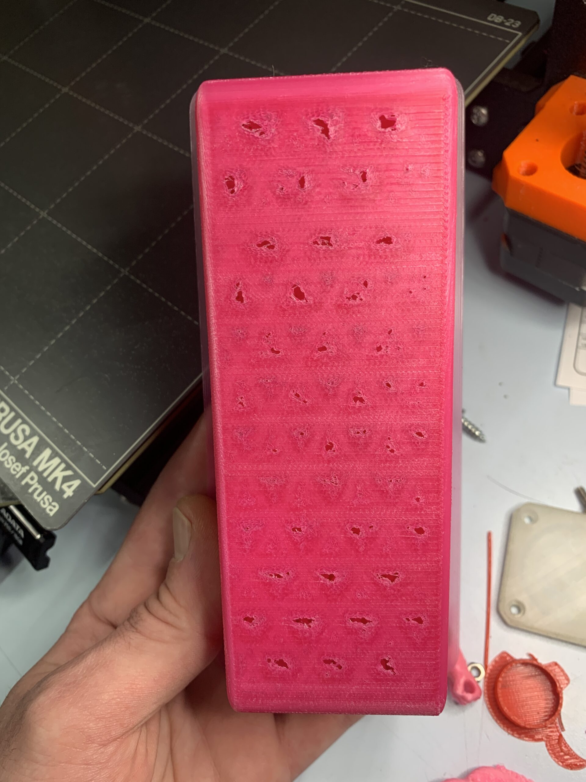

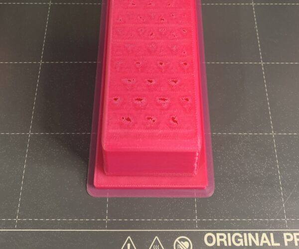

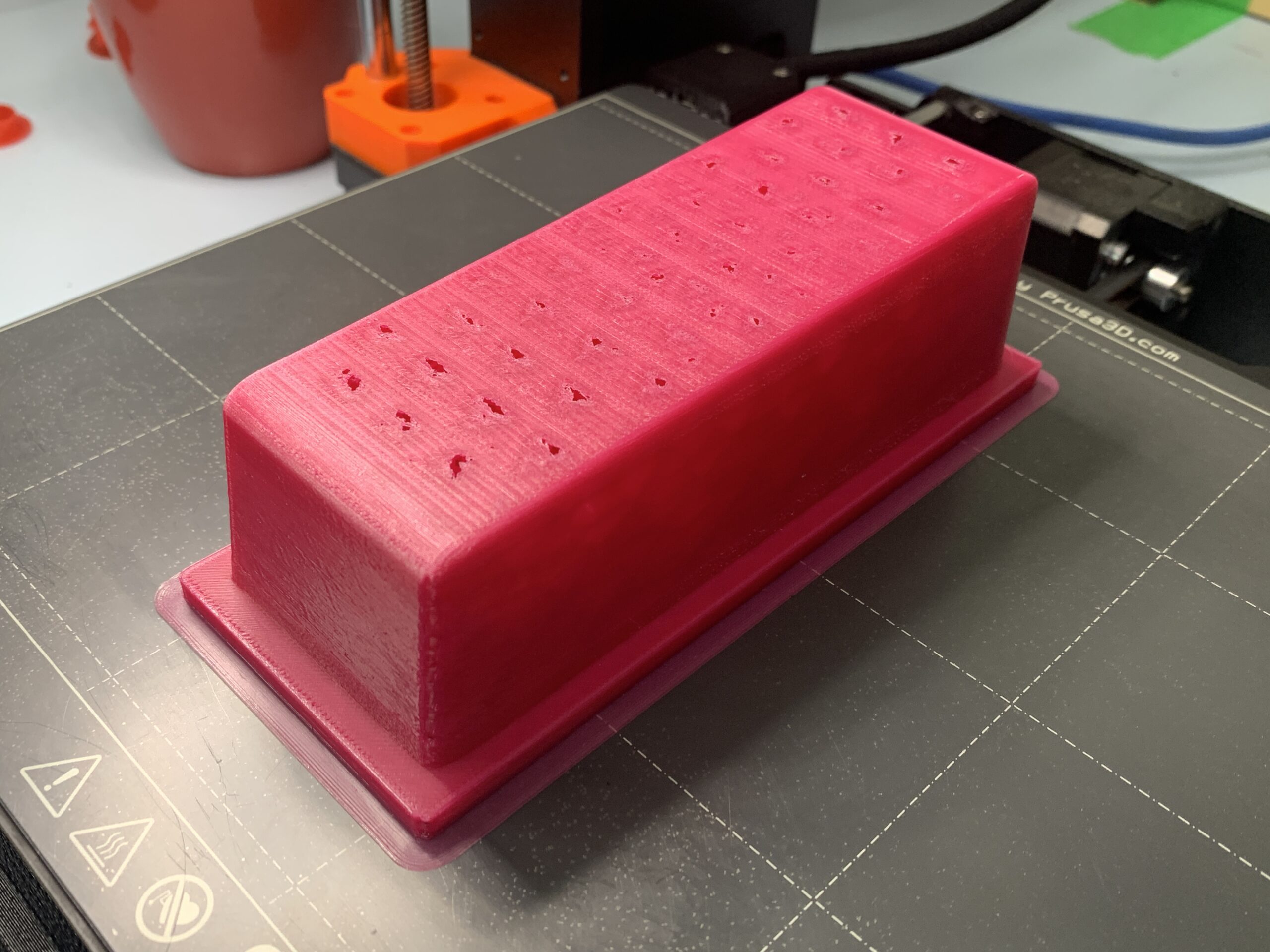

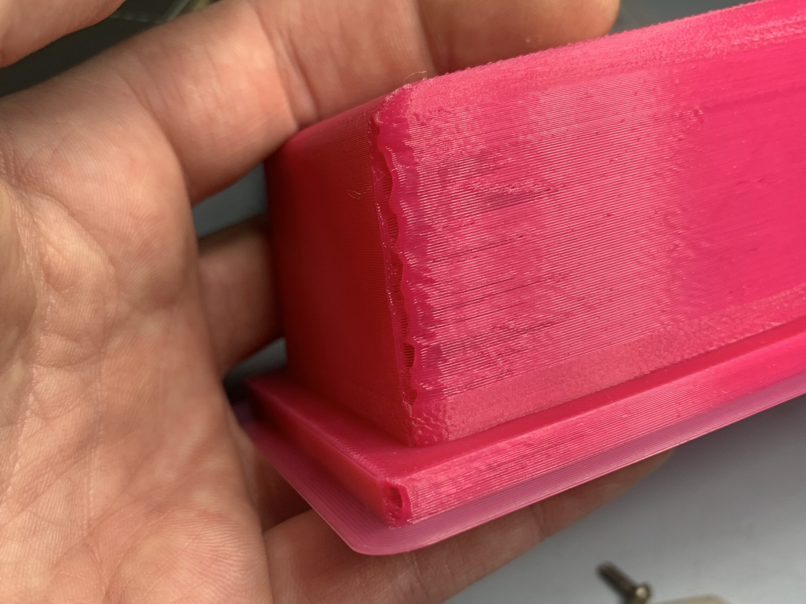

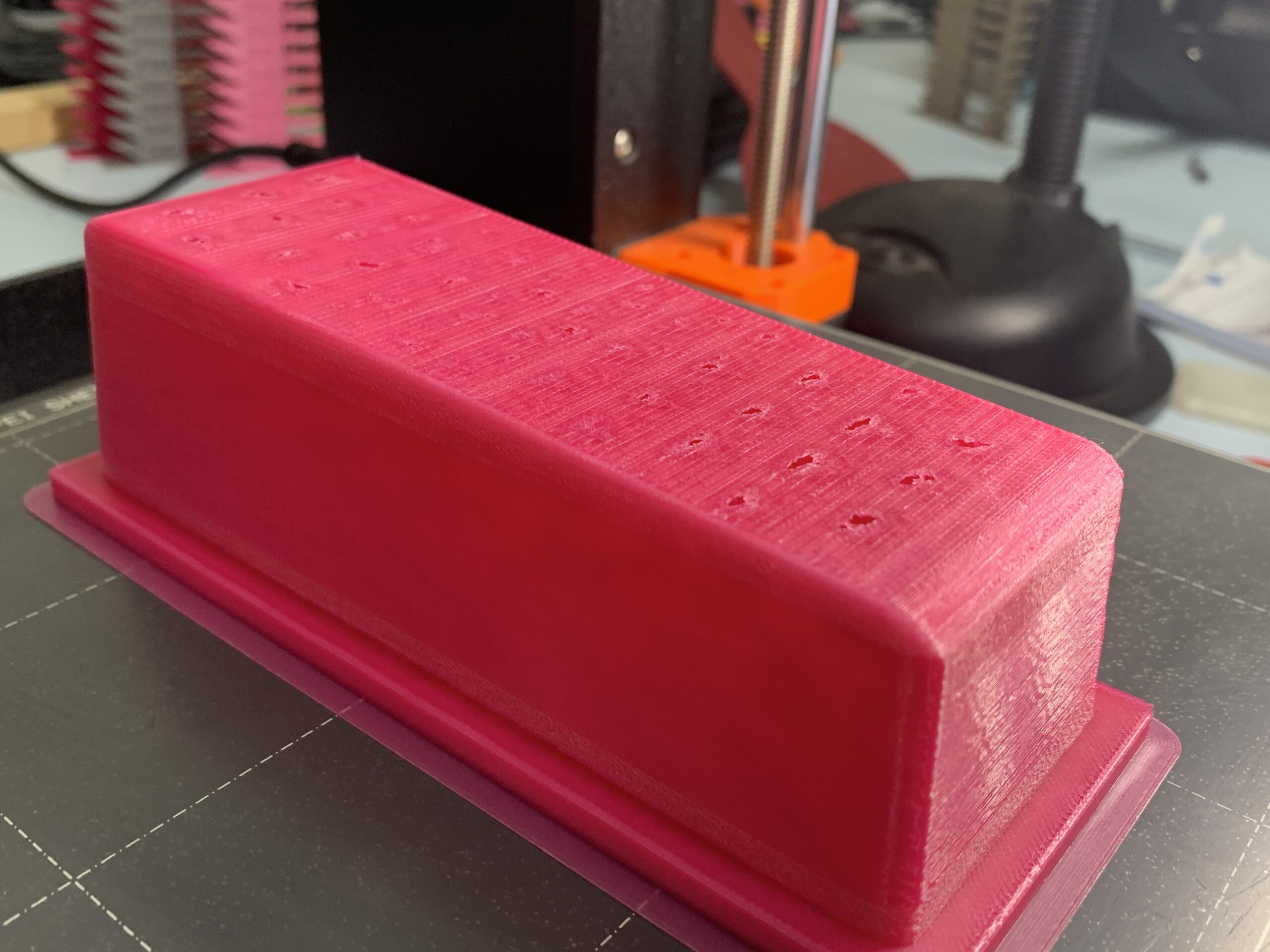

Why would the top layers have this look? Plus, please explain what could have happened to the seam line?
PLA. 0.4mm nozzle. 0.15 draft profile with adaptive/smooth variable layer height enabled.
Posted : 09/03/2024 12:56 am
Increase the density of fill near the top and add one or two more top layers.  Have you been changing the print temperature?
Posted : 09/03/2024 2:14 am
RE: Top Layer & Seam Issues
Looks like insufficient support for the top layers. Increased infill and/or more top layers should help. Seams: There are many reports on github on issues with the latest firmware.
Posted : 09/03/2024 11:52 am
Me
 Me
(@me-2)
Try slowing down, in addition to what Diem and fuchsr recommended
