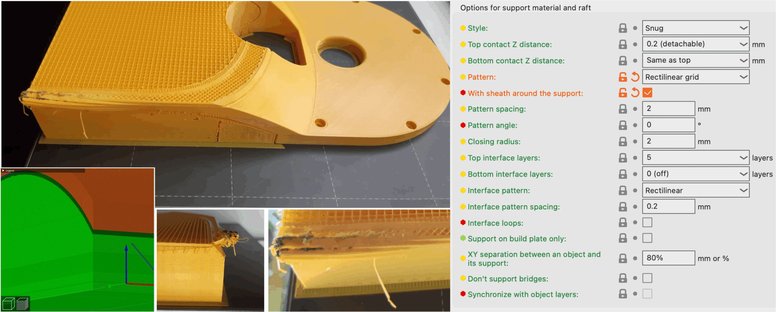

Hi, i have a question. I have a print which fails on the interface between support and print. It is a bit of a special print where the print starts with a thin slice sitting on top of a support structure... The print is printed with Prusament PETG using a mk4. The mk4 fan is situated on the left. I am using a Prusa enclosure including the HAPE Filter which is running.
