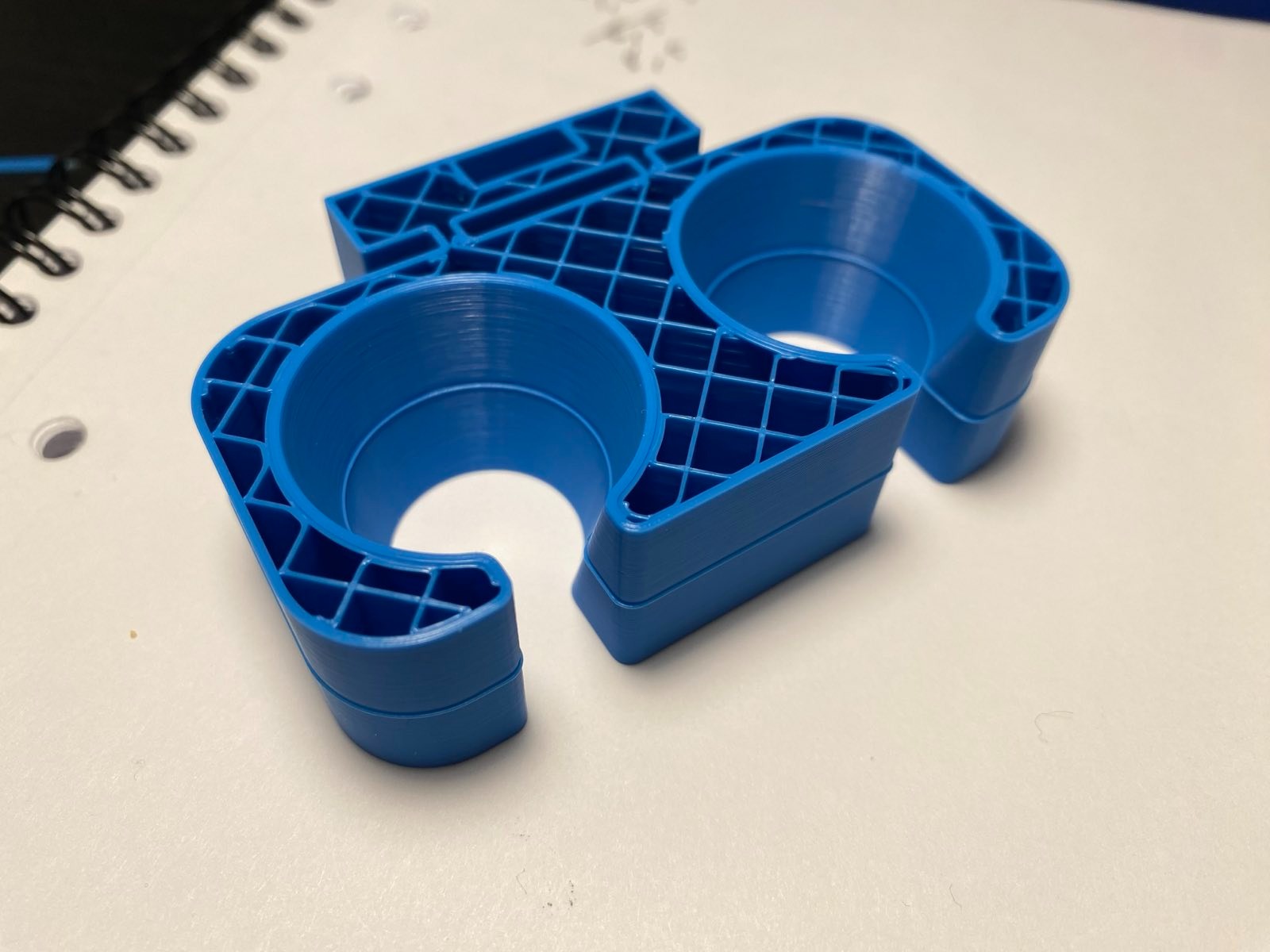

Prusa MK4 missing lines randomly
My Prusa MK4 is randomly giving me missing lines in PETG prints, it just stops extruding and i dont understand why. The print looks fine before and after, the extruder just stops pushing out filament for some reason.
What could be the cause of this? I have changed the USB and the problem is still there.

I have found that this problem was resolved when i down graded to Prusa Slicer 2.6.0 and started to use the USB memory stick to transfer files to the printer. No idea why, but it works.

Did you use Prusa Connect? I installed Prusa slicer 2.7.2 and have used USB for transfer in stead of Prusa Connect. I havent flashed Wifi firmware to the printer either. The problem seams to be solved.
I tried a PLA print when i had problems with the missing lines in the PETG prints, and got an extra line instead 🤣 Dont know why this is happening, but this isnt a problem any more either.

Disabling Prusa Connect seems to solve issue for me. Printed same gcode and same USB drive with Prusa Connect disabled and didn't have any skipped lines.

I did a comparison (dos command FC) of the G-code file on the USB after transfer from Prusaslicer, and the same g-code directly from the slicer, but didnt find any difference. If i took a print that had missing lines and choose "re-print" on the printer, the next print sometimes had the missing lines and sometimes not, and in different places.
When i did a factory reset the last time, i didnt re flash/install the Wifi module, that could make a difference also perhaps.

Hmm. Interesting. I know the reproducible bug with Prusa Connect \ USB.
When you try to add M600 command to bcode, the printer gets stuck if you upload it via PrusaConnect, and the printer works well if you print via USB.
Maybe guys have trouble with FS buffer, they don't run FS flush and try to read data from USB before it's physically fully written. I don't have any idea.
