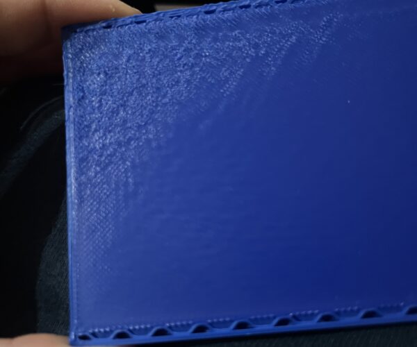

Printer suddenly printing badly
Everything i print looks like this

RE: Printer suddenly printing badly
Looks like a bad bed mesh. Make sure they is nothing under the print sheet, is the nozzle clean, home the z axis.  Make sure there is no residual plastic on the sheet.  Clean the sheet with soap and water.
