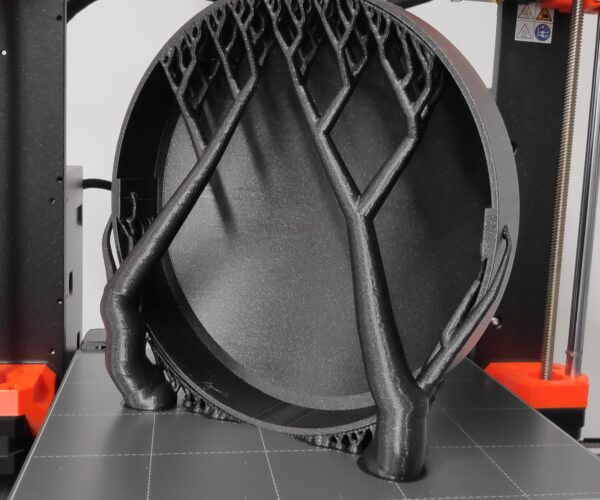

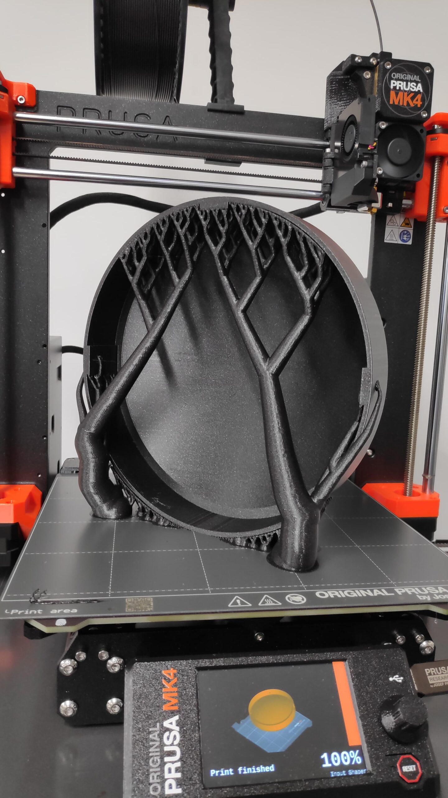

So I tried with organic supports,
Is this the best way to print it?

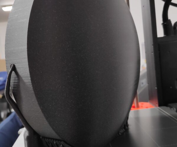

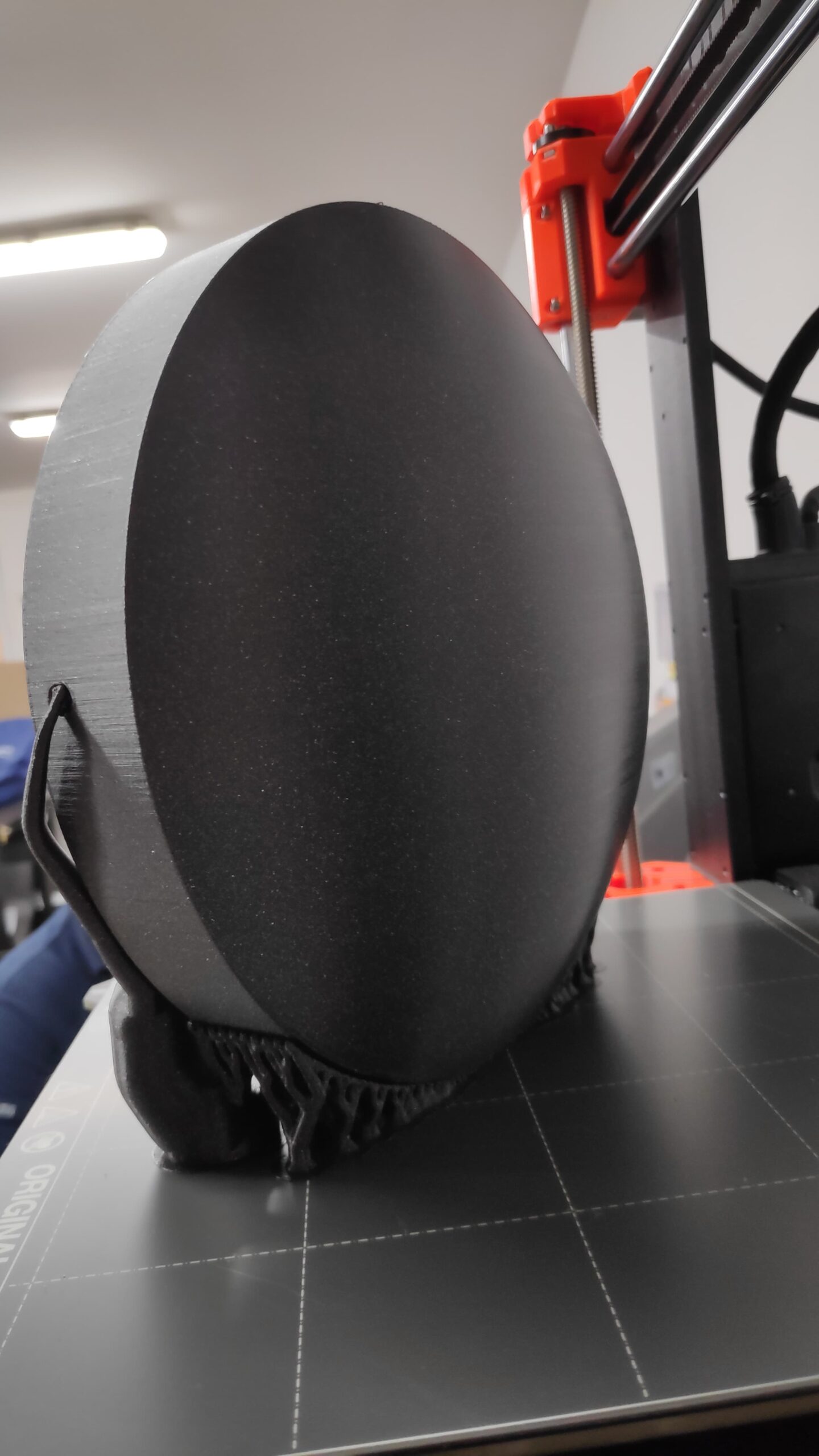

I'd go for a different angle on the disc like so -
Less supports needed and the bottom edge near the bed will print better.  That bottom where it touches is going to be flat no matter what you do (unless you lift the part up) but by having just the edge lowest there's less cleanup.
Attached project file.  Should warn you that I saved it from 2.7-rc1 so if you are running the 2.6 release it might complain when you try and open it.
Posted : 18/11/2023 12:40 am
Rod86
(@rod86)
RE: Need help with how much supports I need to print this dome
Thanks! @neophyl, I appreciate you taking the time to show me what's the best way to place the disc, so I could use less filament in the supports. You have opened my eyes, and the next print, I'm going to use yours.
This is how mine endend up looking like:
Thanks again!
