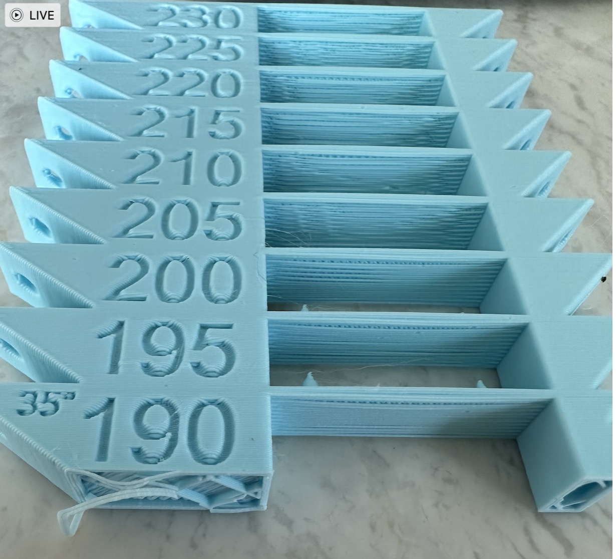

Mines oozes so much the bed leveling fails very often.
 But when I do temp towers, at 190, there’s clear under extrusion and layer adhesion issues.
Posted : 19/09/2023 7:11 pm

Posted by: @ob1
Do you have a picture of the underextrusion?
I couldn't figure out some weakness in the testfile after printing with 190 degrees. It was even pretty hard to break the towers in pieces.
Posted : 20/09/2023 5:53 am

RE: MK4 PLA Stringing
This picture is all I kept. The 190 part of the tower separated as I was flexing the bed sheet to remove the print.
Posted by: @cstef
Posted by: @ob1
Posted : 20/09/2023 6:50 pm
