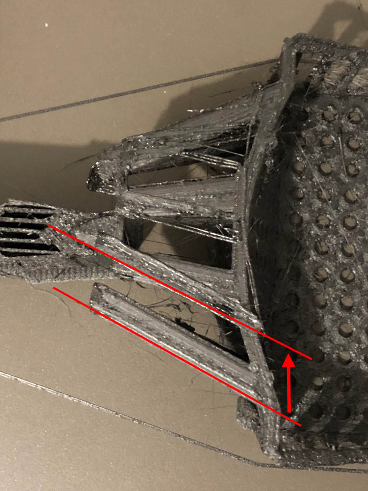

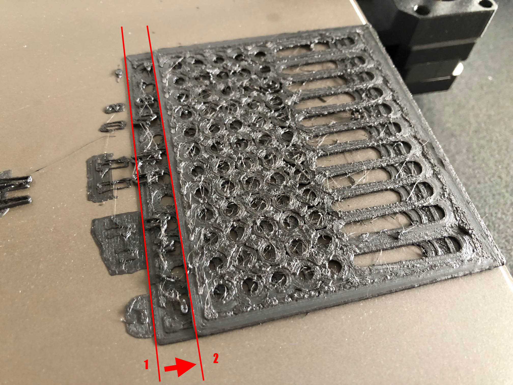

Rui Guerra
(@rui-guerra)

Hi all,
I'm having the same issue of layer shifting in the X axis (and only in that axis, from position 1 to position 2, in the photos attached, each time in opposite directions):
I've created two different G-codes for each try in hope that there was something in the first one that could cause the problem but in both of them layer shifting occurred in different places.
I'm also positive that the X belt tension is fine.
Any help will be much appreciated.
Thanks!
Veröffentlicht : 04/01/2024 4:48 pm
Rui Guerra
(@rui-guerra)
RE: Layer shifting and odd "stringing" issues
UPDATE:
After my last post I've double checked the X and Y belts tension and adjusted them again (the X one needed more adjustment, it was much more loose then the Y).
I've also increased extruder retraction from 1 to 2 and it greatly reduced the stringing you see in the above photos. Recreated the G-code again and started the print in a MK4 printer.
The total printing time was 4h30, but after around 2 hours in the printing I noticed a layer shift, this time in the Y axis, by around 1 cm, so I stopped it to avoid filament waste.
This layer shift started after some sudden (normal) moves in the Y axis but with some strange noises like bumps. That was also the case in the first time I experienced a layer shift in the X axis (first photo above). The bumps were similar to the ones the printer produces once the car hits the final part of the track. When I move the car by hand, or the printing head (X axis) with the printer turned off, I don't feel any kind problem and the movements are quite smooth all the way.
This last Y axis layer shift is clearly seen in the photo, marked with the red lines:
Anyone had experienced this issues and knows what can be happen?
Thanks

Rui Guerra
(@rui-guerra)
@altruego Thanks for the help and explanation. It makes sense to me.
The only thing I don't understand is why it happened in three different locations and the three different tries. Shouldn't it happen in the same spot if it were a G-Code problem?
Could it be something (IS or other thing) that makes a sudden move causing the printer to loose de X or Y axis calibration in a way that successive layers keep printing in the wrong axis coordinates? And if it is already too close to the border of the printing area, it will start to be out of range, so the bumps.
The reason for the bumps (out of range printing) makes all the sense in my case since the part I'm trying to print is big and occupies almost all the area in the X range.
It's The Litterator - a cat litter scoop: https://www.printables.com/model/2648-the-litterator-cat-litter-scoop
Anyway, here is the link for the two G-code I'm trying to print (difference is just the nozzle used, 0.4 or 0.6), if you want to also take a look at it: https://we.tl/t-I9ZlXxVA8Y
Thanks
Veröffentlicht : 06/01/2024 11:39 am

Rui Guerra
(@rui-guerra)
Well, it was not the same Gcode, in fact:
1 - The first try was with the 0,4 nozzle and it was the first G-code I've generated. The layer shift occurred near the handle of the scoop, X-axis towards the left.
2 - For the second try I switched to the 0,6 nozzle, and increased filament retraction (because I also had a lot of stringing). The layer shift occurred shortly after the printing started, still in the base of the scoop, in the X-axis, towards the right.
3 - For the third try I increased further the retraction, created the new G-code and also reinstated the printer firmware and adjusted the X and Y belts, just to be sure that the printer was as it is supposed to be. This time the layer shift occurred also at the beginning of the handle (just a bit sooner than first try) but this time was in the Y-axis, toward the back of the printer.
In all of the three attempts, the amount of layer shifting was always around 1 cm.
Thank you for send it to Prusa support. I was also thinking about doing it. Please share any feedback that they could give.
Thanks.

Rui Guerra
(@rui-guerra)
As I’ve mentioned above, I had layer shifting two times in the X axis (in opposite directions) and one in the Y axis.
Always with IS. Never tried to print without IS.
