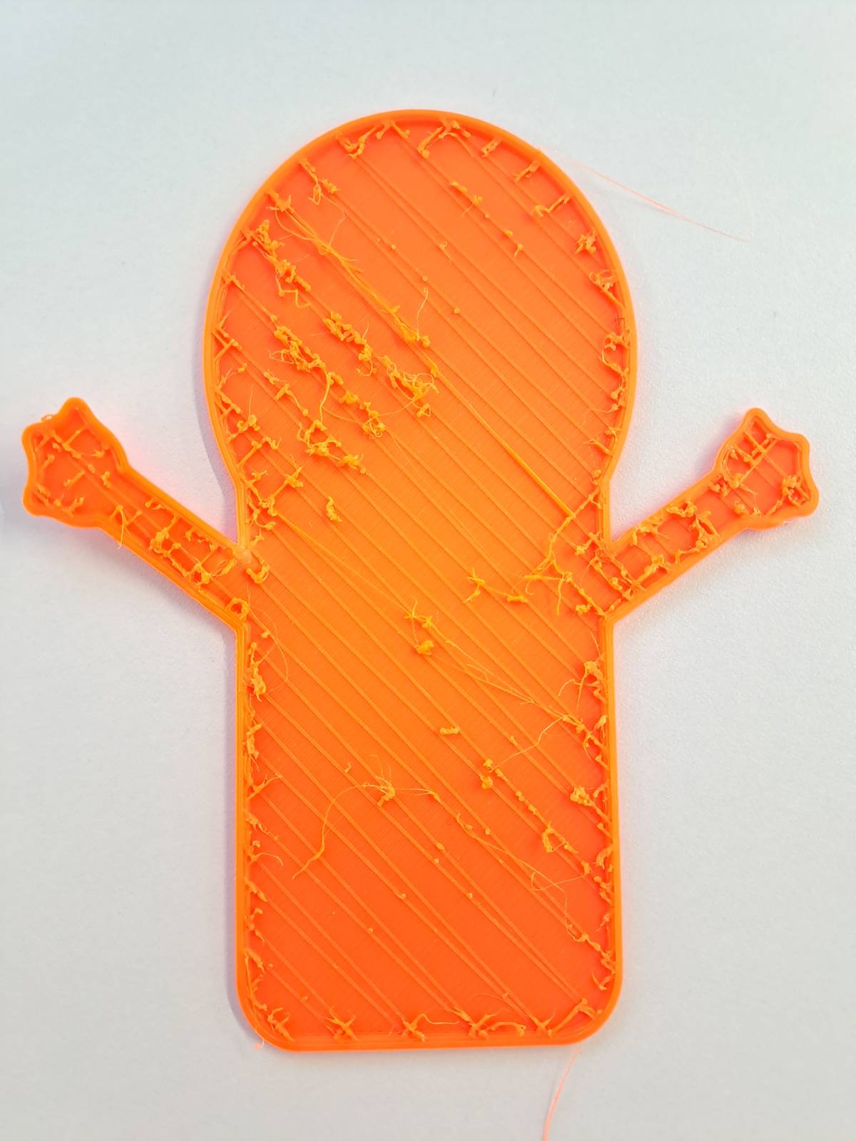

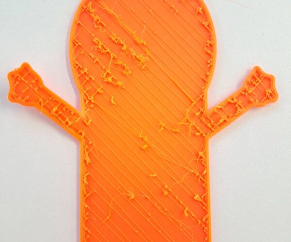

Hello,
I have a problem with the continuity of the filling and supports.
Walls and exterior layers are printed correctly.
Material - PETG (Prusament)
Settings - Default for PETG prusament (input shaper)
Previously models were printed correctly without any problems and defects.
Nozzle is clean.
The Photos show the problem:
Posted : 14/05/2024 10:26 am

I am not the expert in this, but my idea:
- When printing the supports and infill the filament flow is much less then when printing perimeters. If there is a partial obstruction in nozzle, or heatblock, this may lead to underextrusion.
- Because of the lesser flow, it might be that the retraction does not work correct (slipping idler wheel) what causes under-extrusion at one moment and just after that oozing.

Are you by any chance printing PETG at PLA temperatures?

Nozzle is clean, so flow should be correct, but i will check the retraction coefficient
Posted by: @diem
Nope, in 100% temperature is default for PETG.
