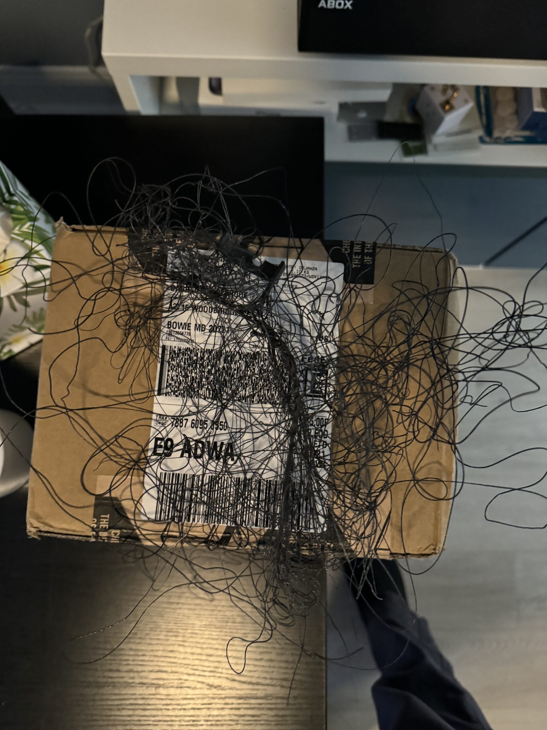

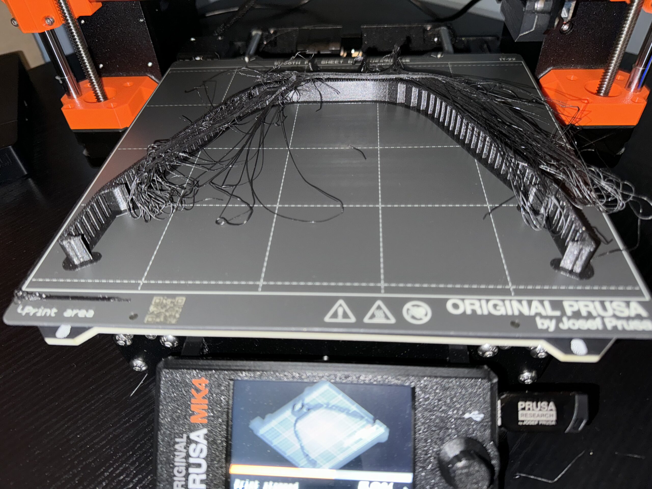

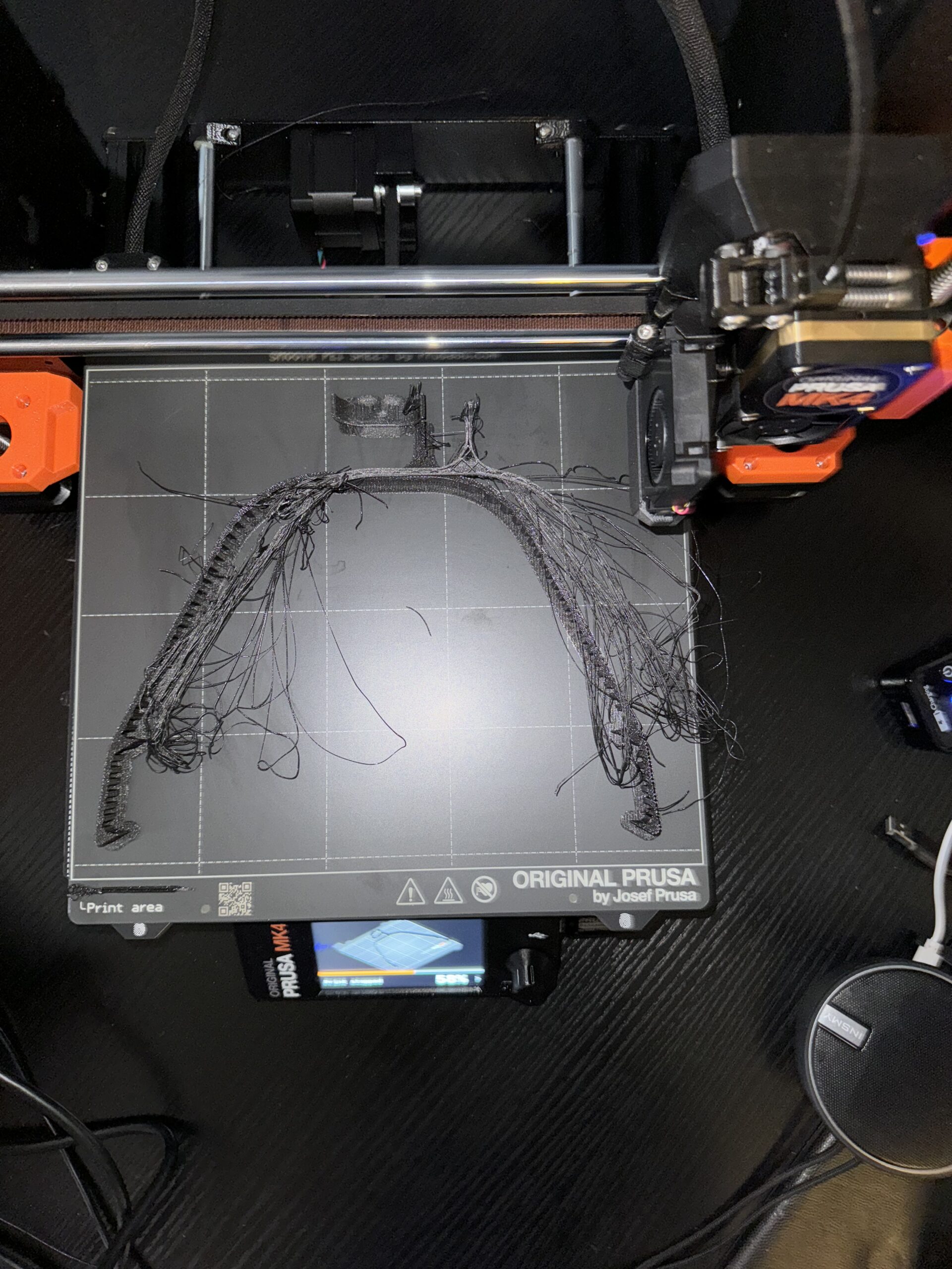

Hello,
My first MK4 print is not going well. The spaghetti below is an attempt without Supports. The remaining images are  “Support on build plate only” but still the mess continues. What am I doing wrong?

Posted by: @darrell-westbrook
Hard to tell from the fuzzy pictures but it looks like a layer shift. Most likely the belts aren't correctly tightened or a loose grub screw on the motor shaft pulleys. Based on the picture I'd check the X-belt and the X-motor. Use Prusa's handy phone app when tuning the belt.

@nhand42 thanks for the tip. I used the app and belts are finely tuned.
