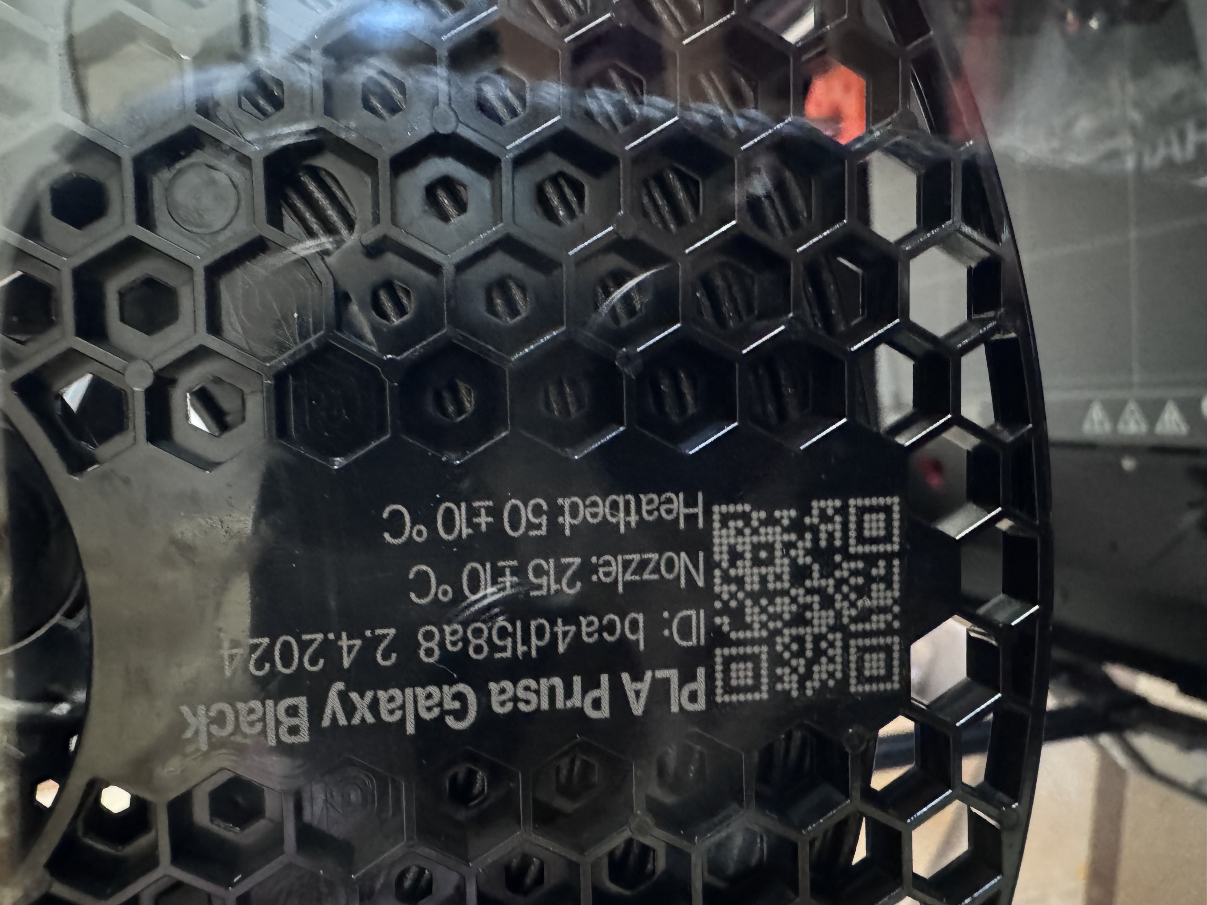

ok, I am at this stage now. Exported to slicer. I believe the prusa is delivered with PLA, there are 3 PLA in the list on the app, I believe they are all the same I presume? everything is as delivered (ready built I just put it in the enclosure)
print settings look ok?

Hi, Greenymeanie,
with 3D Printing, it is very difficult to make positive comments based on little information...
If you could save the Prusa Slicer session, the model and with all settings as you plan to use them, as a project file (File>Save Project as) then when you have saved the project file, if you could ZIP Compress the file, and attach the zip file to your next post, we can have a more informed opportunity to comment on your proposed settings
I suspect the three PLA Options are
Generic PLA
Prusa PLA and
Prusament PLA
I Have no idea which is most appropriate as I can't see the filament that you have
All three profiles are similar
Prusament = Filament actually Produced by Prusa. in house and it comes on a roll with plastic sides perforated by lots of Hexagons. Like the picture below
there will be a description of the filament laser etched onto the side of the reel, complete with a QR Code and serial number
which allow you to look at your actual reel's 'Birth Certificate' (Prusa call it "INSPECT YOUR FILAMENT ONLINE") https://prusament.com/
and when you enter your spool details you get a report including specific details like this, about your actual roll of filament.

RE: First print - small water tank HELP!
Thanks Jean, I’m super excited to get this first print going:-) The PLA I have is what was delivered with the machine. I will check the codes when I’m home shortly.I will upload the zip too:-) can’t wait!
heres the file, no need to zip, its very small edit, I had to zip it because it did not attach otherwise
Prusa PLA it seems
