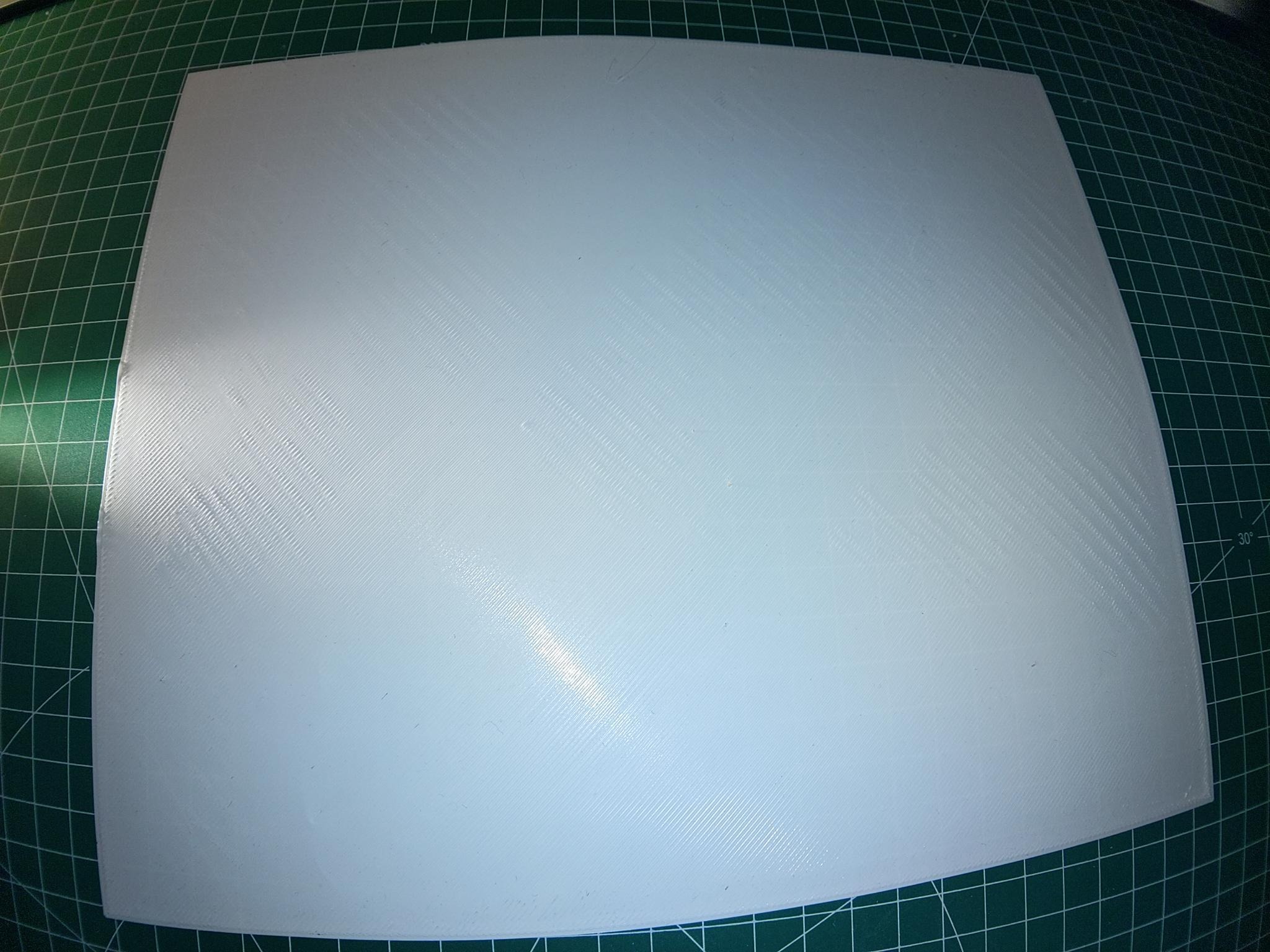

what would cause this ripply look in first layer?
I don't often print things with a large first layer so I don't know if it has always done this but noticed it today and wonder if it indicates a problem and what I might do to correct it?  I have had my MK4 for about 6 months now and love it. I got the kit so I assembled it. I am using input shaping and have stick glue in a light layer on the pei sheet. Sliced with latest version of prusa slicer at default settings for prusament pla filament.
the ripples continued at about the same rate over the whole first layer but are very hard to see by the time the third layer was finished.
thanks for any tips!

It looks like the first layer is the tiniest fraction too low, perhaps by the thickness of a coat of glue ... why are you using it?

Almost every print that I have tried to do without glue has either detached during the print or been stuck on so tight that I either almost damaged the print surface getting it loose (or did damage the sheet a few times) while I can only recall one or two prints that came loose when I was using glue...so I use glue everytime now because I have much fewer failed prints with it.
So you think the thin glue layer is throwing off the automatic first layer calibration? It seems like if that is causing the ripples in the picture I posted it would have been like that over the whole first layer instead of approx. half of the first layer?

The print just finished, the top side looks fine but you can still clearly see the ripples on the bottom, looks like about half the first layer has them and the other half is nice and uniformly smooth. Maybe the areas that rippled are spots where the glue was slightly too think? I think I'll print the first layer over again after cleaning the bed and see if it still has the ripples or not, that would either rule out the glue being the cause or not.

What filaments are you printing?
That looks like a bady mistreated smooth sheet; using the smooth sheet:
PLA works best with a very clean sheet, no surface treatment.  We always suggest cleaning with unscented dishwashing detergent and very hot water, dry with a fresh paper towel and handle by the edges only.
PETG requires an adhesion reducer, either a spritz of Windex type window cleaner or thinned down gluestick; on a clean sheet wipe one stroke of gluestick then spread it over the whole sheet with a wet paper towel.
TPU and similar flexibles require about twice as much glue as PETG; not as much as you are using.
Do you have other print sheets, what is the other side of that one like?
Not really, that was more a tongue in cheek comment on the amount of glue on the sheet.  With the MK3 it would be a sign that the first layer needs recalibration, on a Mk4 I suspect it might be an early sign of nozzle wear.

I always wash the sheet the way you recommended but as I said I have had trouble getting some prints off it when I didn't use the glue but the surface is still pretty smooth I think, any imperfections are recesses, not raised. There are a few spots where the print head pushed down too hard when calibrating and left a dimple on the other side of this sheet.
I will try your recommendations for the glue and filament type. I do have a textured sheet as well.

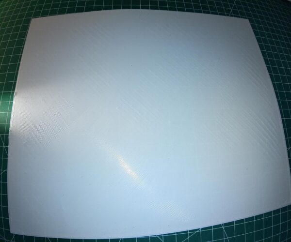

I just reprinted the first layer of the same print with the same filament (pic below) and the ripples look even worse on a clean sheet with no glue to me. They are ripples, I can easily feel them when I rub my finger over them, very rough.
The filament I am using is SHENGTIAN silk silver PLA and its a new roll.
I recently installed the V6 nozzle adapter with a "Micro Swiss Copper Core - M2 Hardened Steel Tip" so I don't think the tip should have much wear on it at less than 2 months old and with maybe 48 hours of print time on it, all pla.
Heres the first layer on the freshly cleaned sheet with no glue at all.

I went ahead and printed the first layer on my textured sheet and it came out just about perfect so I guess my pei sheet is just shot, It feels nice and smooth but maybe it has some slight ripples that are to light to feel but show up in the print?
What would you suggest for the textured sheet as far as when to use glue vs not? I print pla, petg, and sometimes asa, tpu and nylon depending on what I'm printing will be used for.

Silk is often tricky to print as it expands from the nozzle - go back and try with regular PLA.  The texture is probably absorbing some of that expansion.

I tried the same first layer on the pei sheet with some prusa regular pla and there was much less ripples but they still showed up fairly pronounced in one section. Maybe a combination of a bad build plate and the silk pla?  I ordered a new smooth plate so Ill try it on that and see what happens when it gets here.

I had this problem with the satin sheet and silk PLA. Using live Z adjust to raise the nozzle fixed the problem.

Those ripples are a sign that the first layer is too close.  When the first layer is too close, you don't have room for the filament to lay in even lines next to each other, so every once in a while, it sort of pushes up, and as the lines get added, those imperfections push on the next line being put down next to it, and you get those kind of ripples.  When dialing in the first layers on my older ender printers, the exact same thing would happen, and I still get that from time to time on my MK3S+ machines in spots, when the sensor doesn't totally nail the homing (although it's not super common).  I'm pretty much 100% certain that's what you're showing in those photos.

Ripples like that are 100% caused by the nozzle being too close.  Lowering the temperature probably reduces flow a little bit, which will mask the issue, but isn't solving the core problem.
I have 3 MK4 machines (just built the third one last week), and only one of them is showing this behavior.  If you could adjust the Z offset of each machine, like you can on the MK3, it wouldn't be an issue.  The fact that you can't do that, because they've made things "easier", is so frustrating.  I get what they are trying to accomplish, but why couldn't they have left the ability to tweak it on each printer individually?
