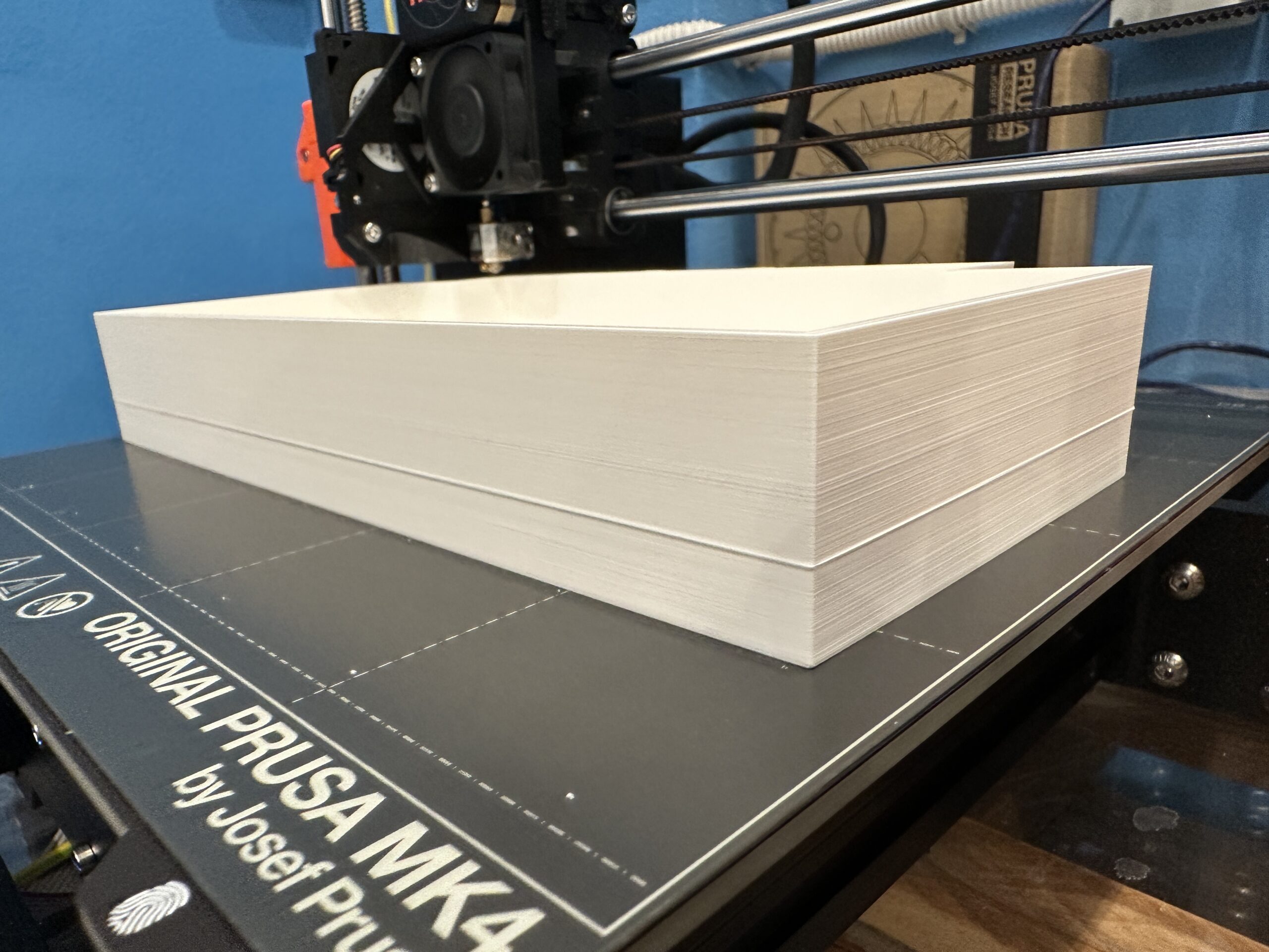

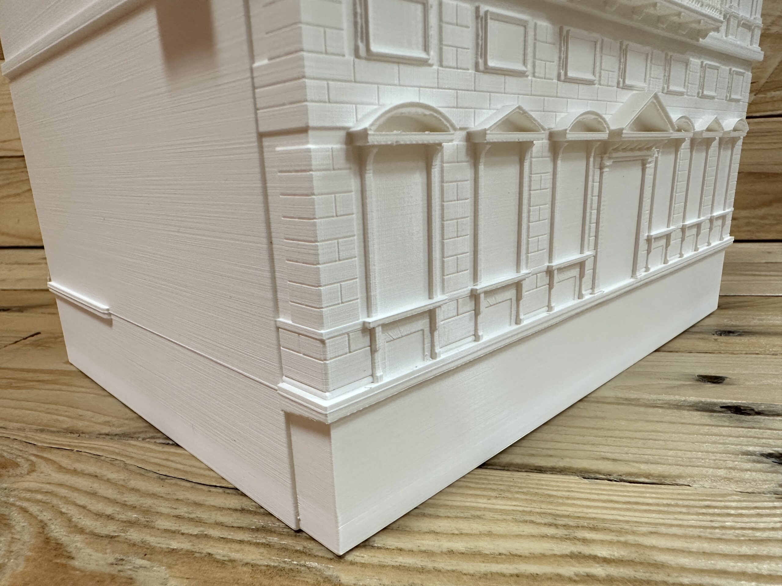

Hi everyone,
I am having some problems that are difficult to diagnose.
In some prints (not all) some layers seem to suffer from under-extrusion, while in others from over-extrusion. The rest of the print is perfect. Initially I thought it might be a mechanical problem, but sending the same print again, the problem recurs identically in the same spot, while making some variation to the slicing, it either does not occur or occurs in a different spot. This suggests more of a software problem (gcode or firmware).
The printer is a pre-assembled MK4. The firmware was updated to version 5.0.0 as soon as it came out, but some of the prints are earlier. The same goes for the version of PrusaSlicer. I checked every model for defects and the slicing looking for difference in volumetric flow rate, printing speed and so on, but I found nothing strange.
I now include some photos with explanation.

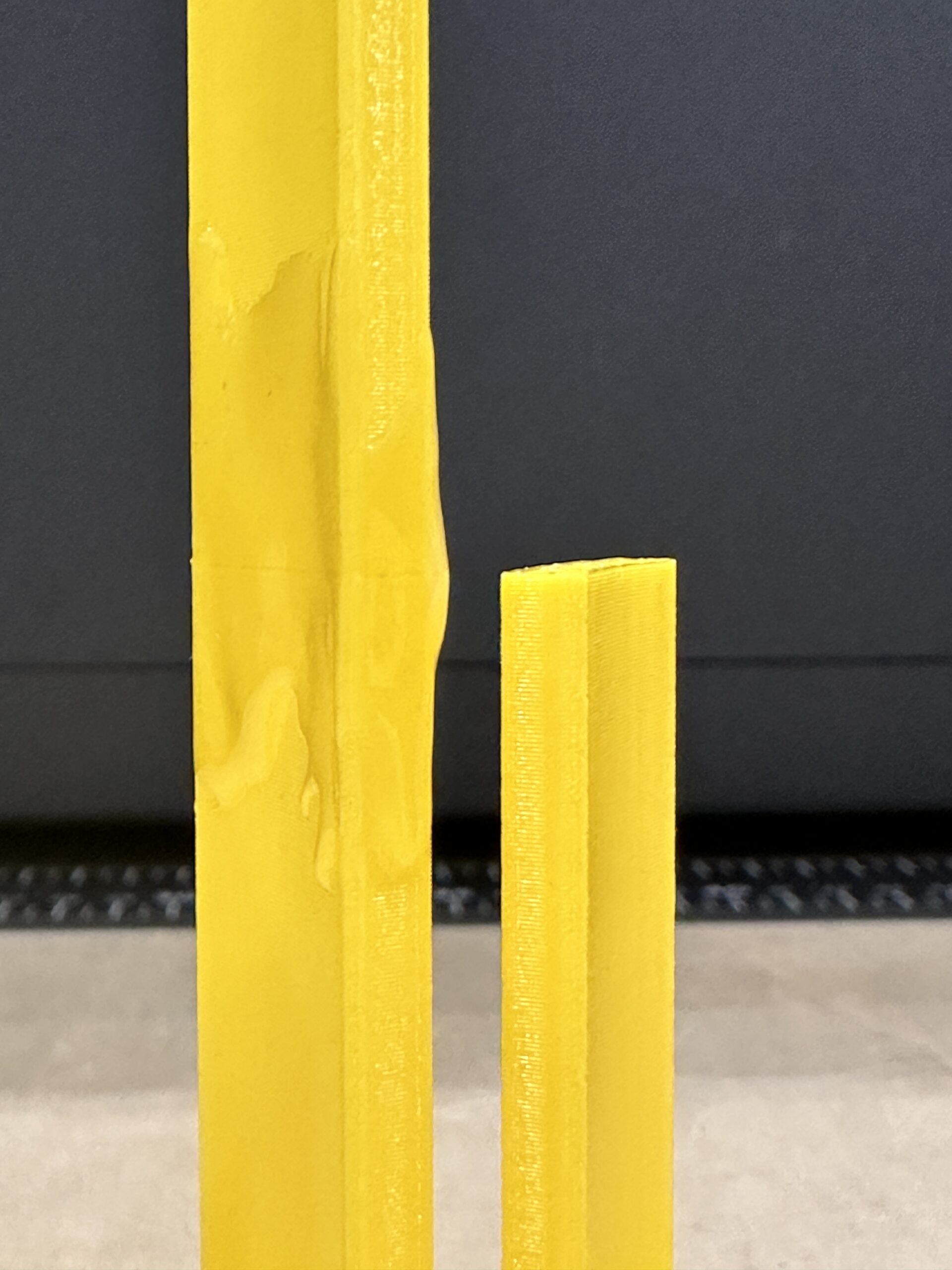

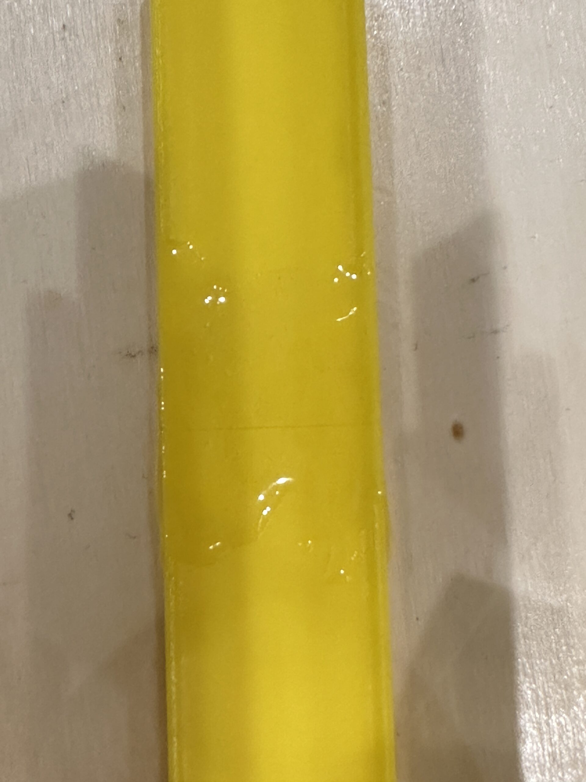

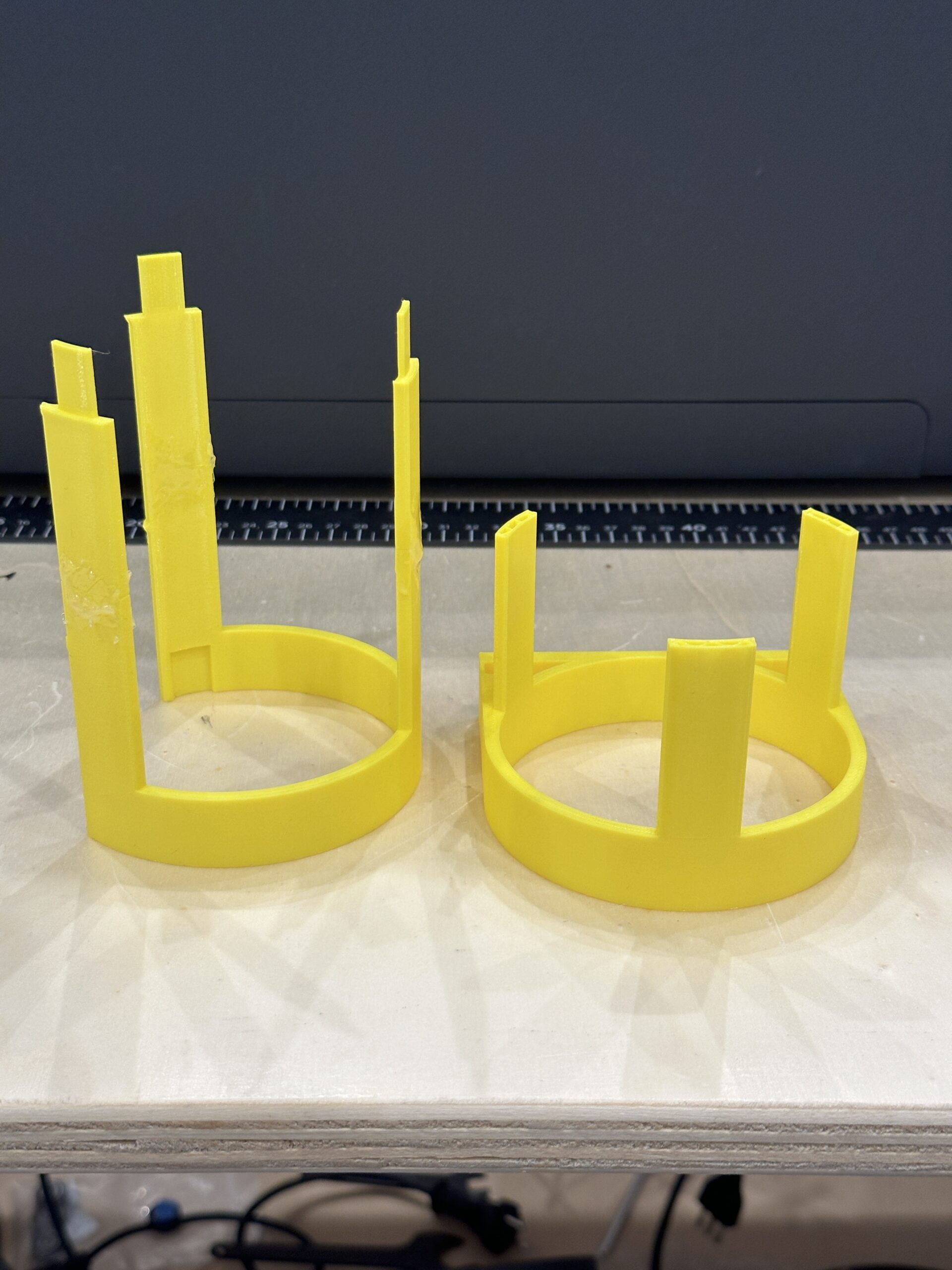

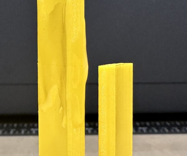

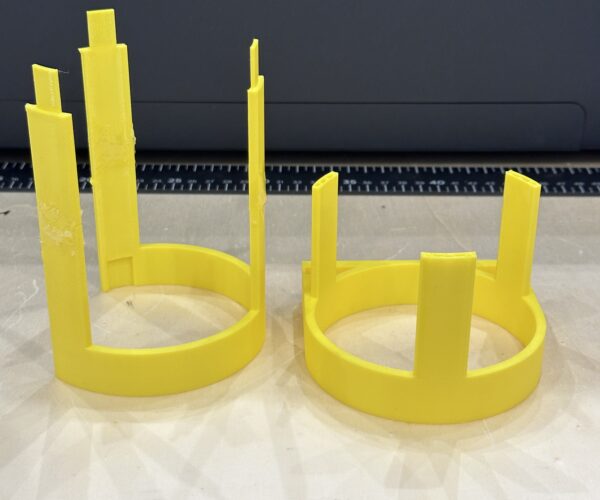

This first PLA print consists of a base and 3 thin columns that rise vertically. The print was submitted prior to the release of firmware 5.0.0 and consisted of 3 copies of the piece just described. An entire layer about halfway through the model has an under-extrusion (so all 9 columns were affected) and the photos show one object with broken columns and one where we attempted to repair the damage with epoxy.
Thinking it was a printing problem (or a filament problem, a Prusament Pineapple Yellow) I sent the same gcode back to print, only to find that the problem recurred the same in the same spot.

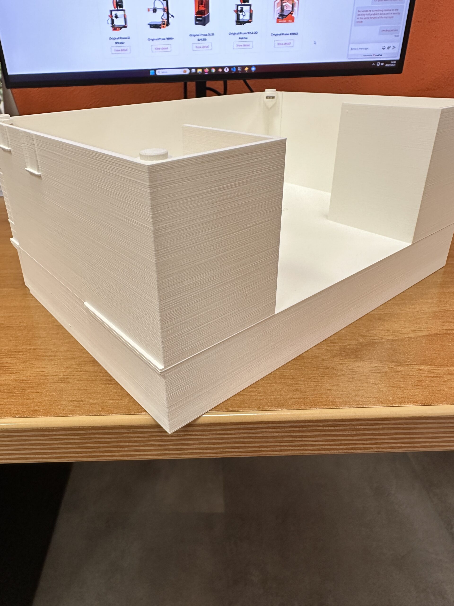

The second print consisted of 3 objects that were printed in Prusa PLA with firmware 5.0.0 and profile 0.2 Structural with Input Shaping.Each plate consisted of 3 objects and only one of them had an under-extruded layer.
I sent the same gcode again and got the same result with the same under-extruded layer.I tried rotating the model that had the defect, so the gcode could be regenerated, and the problem did not recur.

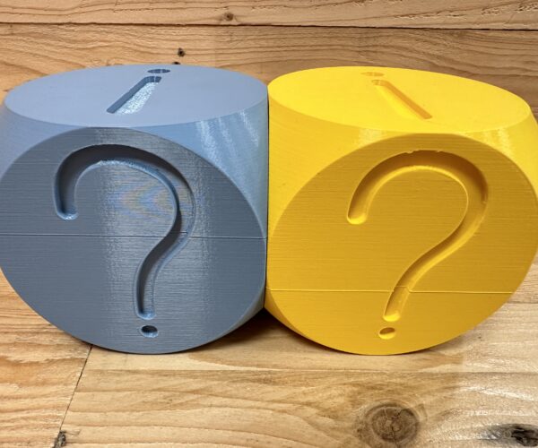

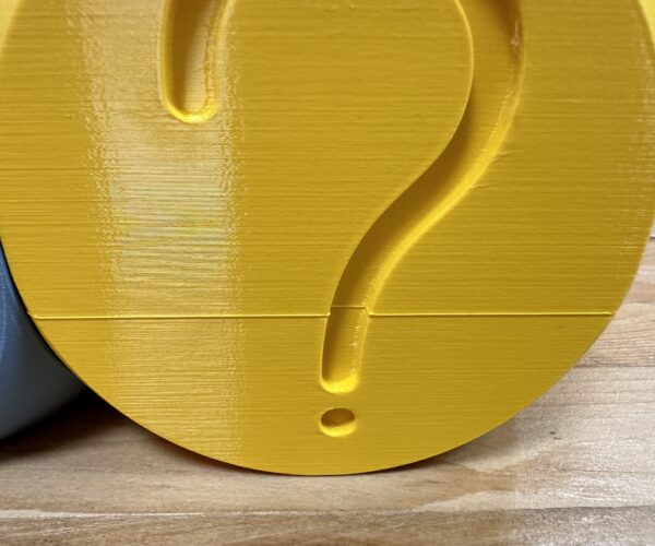

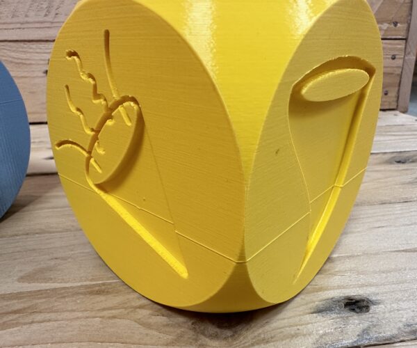

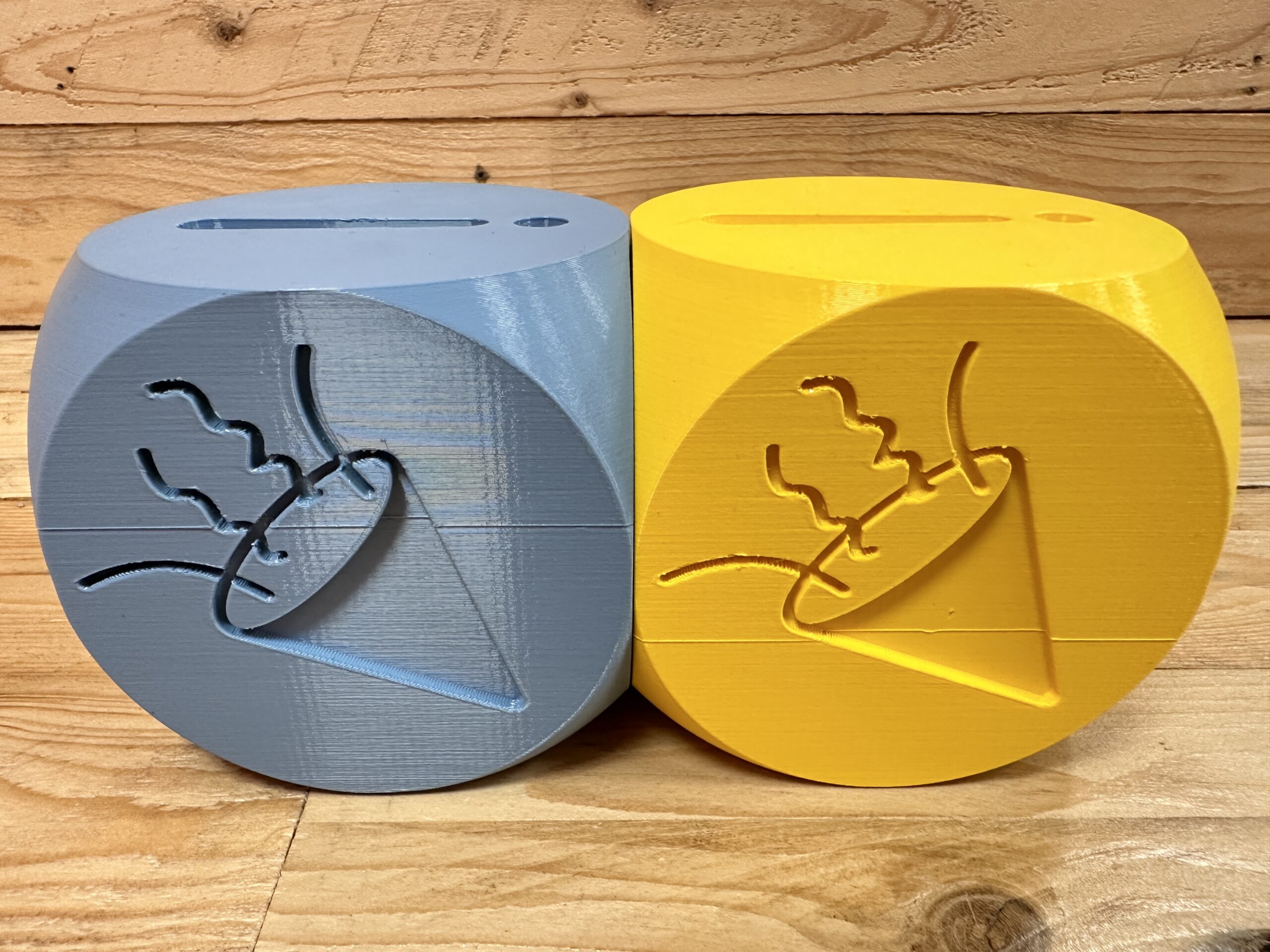

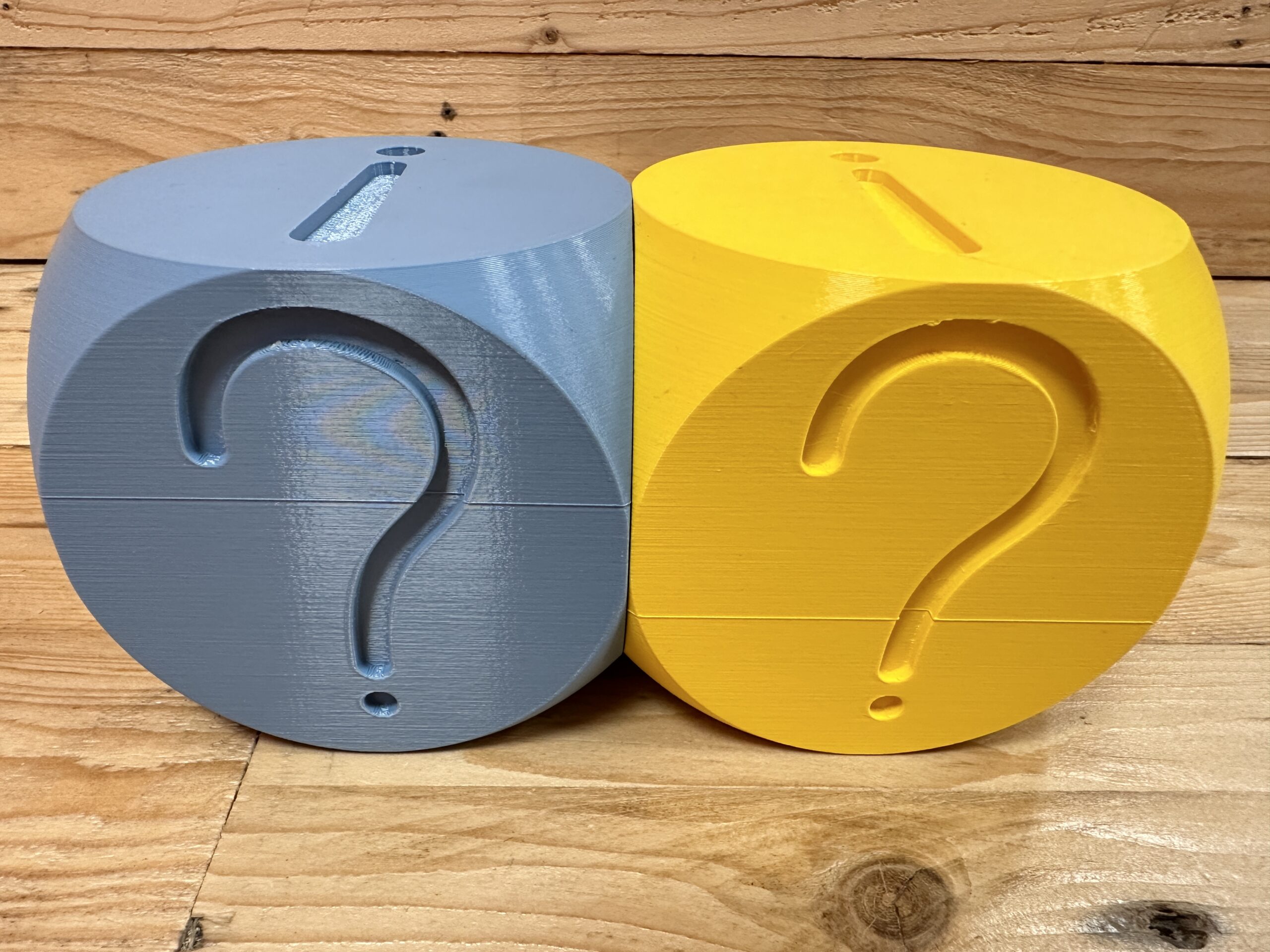

This third case was printed in Prusament PETG and is a large 100 mm storytelling die.The first print, yellow in color, was made with 0.2 Structural profile and Input Shaping enabled. The second print, blue in color, was stapled with 0.2 Quality profile without Input Shaping, following the poor result of the first print. I wanted to remove Input Shaping to see if it could be the cause of the problem.
As can be seen from the photos, the defect is a layer that appears to be consistently over-extruded around the perimeter of the die, but in the two prints it occurred at two different heights.

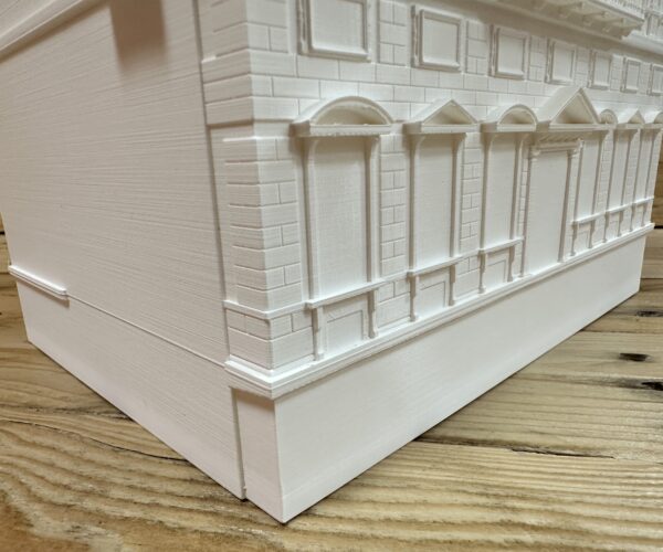

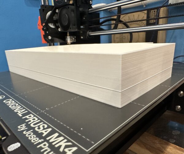

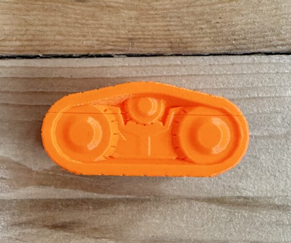

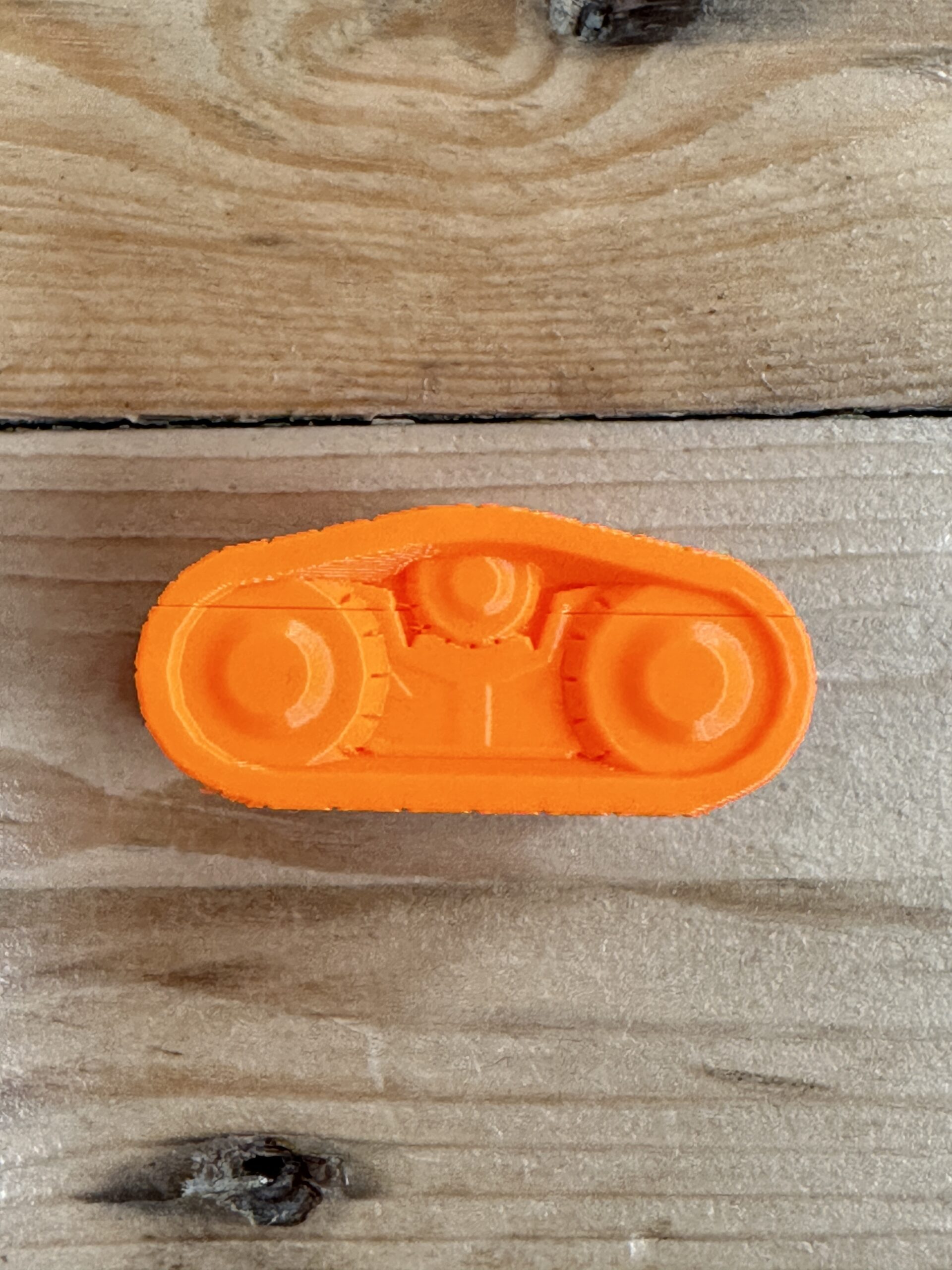

This last print (made long before all the others) may actually be a case of "benchy hull line," since the problem occurs in the same layer as a large top layer. However, since it is visually similar, I include it.
Here you can also see a bad layer stacking, problem that seems reduced with latest firmware.

I have an update regarding the problem. I can't do any testing today, but I have a good feeling about it.
After doing some tests with the help of Prusa support, an operator suggested the hypothesis that the probelma might lie in the faulty USB flash drive.
I then tried opening all the gcodes that gave problems with a text editor (I used Notepad++) and each one ended with a strange sequence of characters.
I can't tell if it is actually the USB flash drive that is defective or maybe we were the ones who unmounted the flash drive before PrusaSlicer had finished writing the gcode.
I will do some tests on Monday to confirm the resolution of the problem.
In the meantime, I thank Bart and Paul M. for their help!

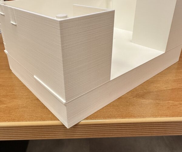

RE: Strange horizontal lines on MK4 prints
OK then my problem is different. I checked several of my files and they all end normally. I am doing some testing today and the results so far point to PrusaSlicer having an issue. I sliced a cut of the model with PS & Cura. PS looks like crap but Cura looks great. I'm now trying to print the full model sliced by Cura (which is gonna take awhile because no IS 😣 ). More testing to try to narrow this down is on the horizon.
