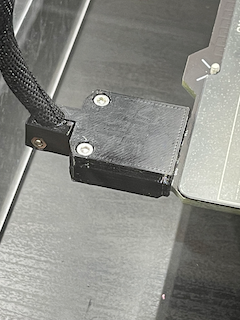

So after many an hour (3 days!), I have designed a heatbed cover that well, it’s the one I’m going to use.
It doesn’t change the original bottom heatbed cable cover bottom, and adds a 90 degree vertical piece, with a side mounting cover, to the original top cover.
This is the first real thing that I have had to work on to complete, and I have learned loads about blender, so it has been useful.

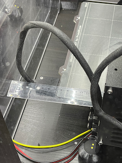

mk4 Heatbed Cover (Lack) Mk4 Heatbed cover for Lack enclosure.
Reference Reference Distance in Lack enclosure
Posted : 29/06/2023 12:13 am

Sorry thought I had added some pictures.... I have posted my design to Printables.com here is the link if you want to try it out, or just have a look: https://www.printables.com/model/515664-prusa-mk4-heatbed-cover-lack-enclosure
