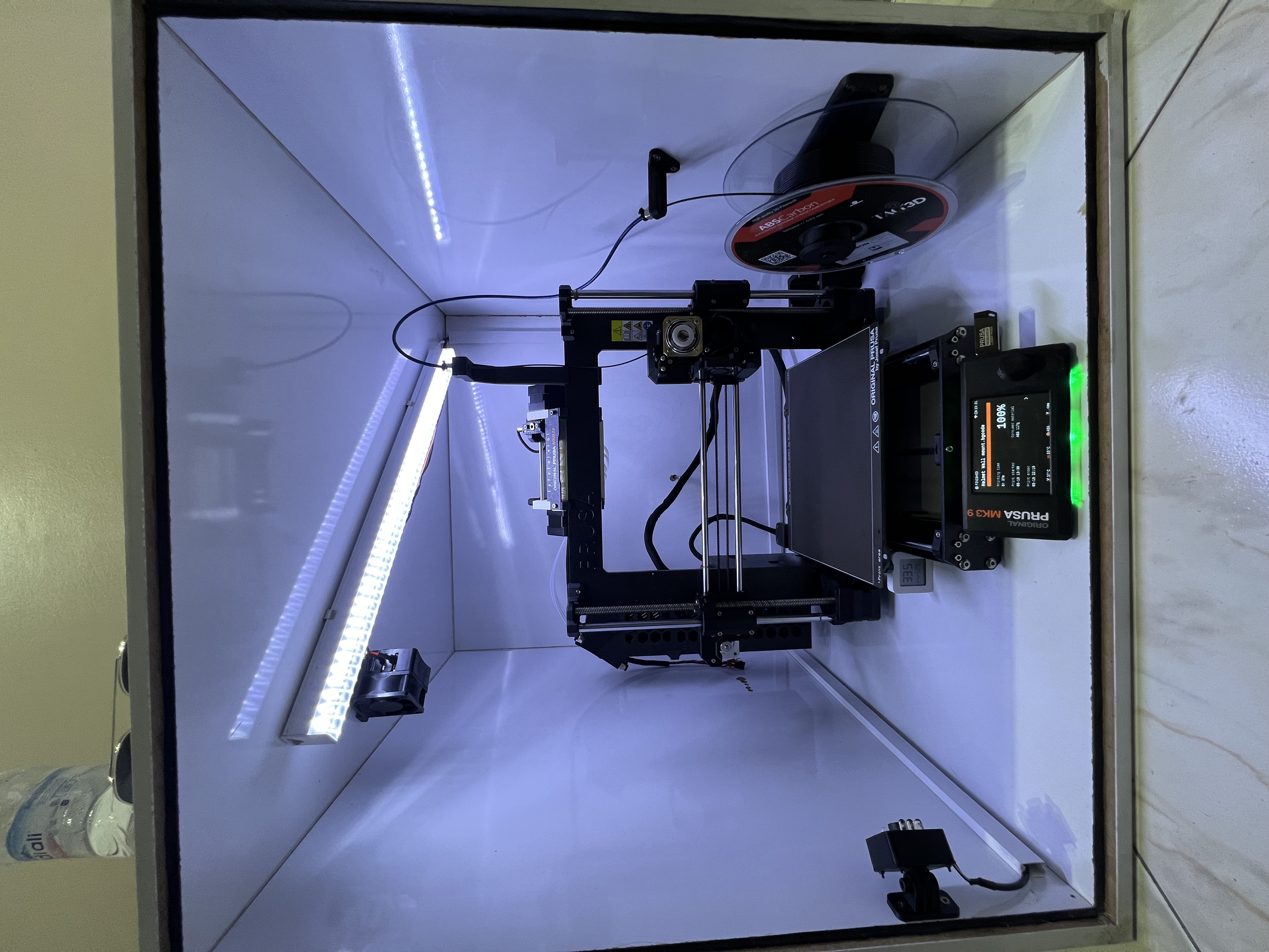

Well i have an actively heated enclosure, i just wanna be safe. I have a 300W ptc heater
