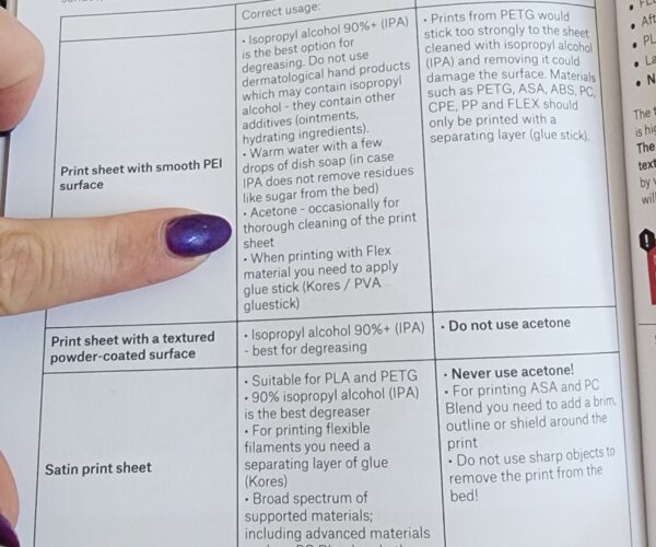

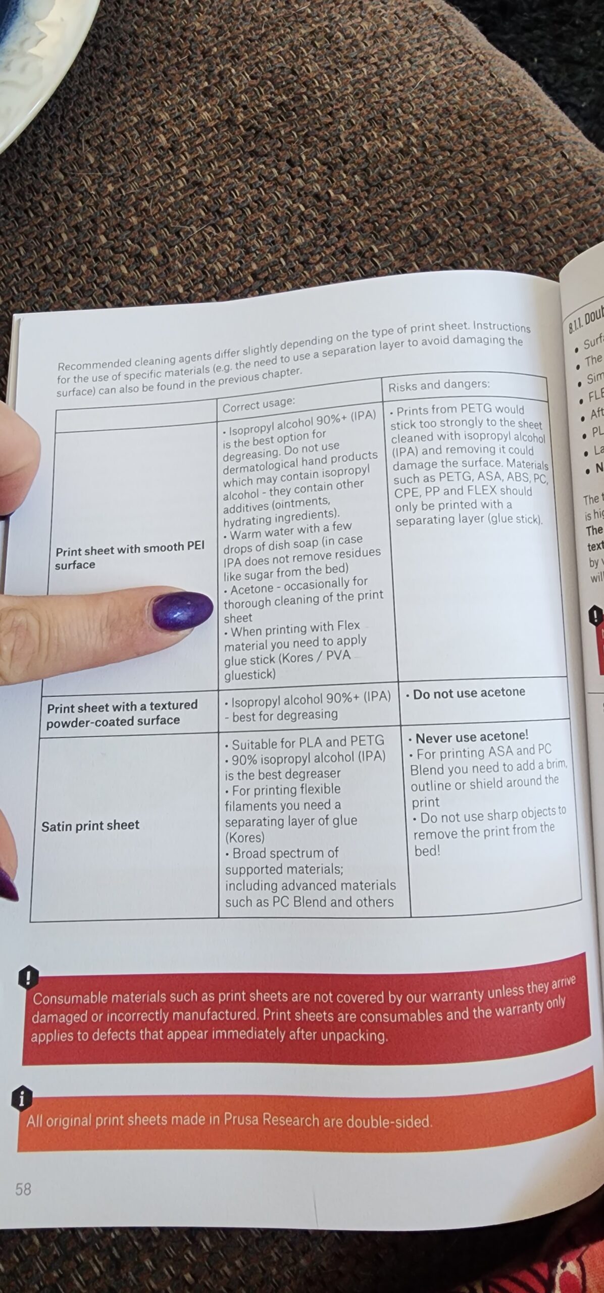

I want to add that if that doesn't improve adhesion then it's recommended to occasionally swab the smooth PEI with acetone. Use a pure acetone, apply it to a cotton cloth or sturdy paper towel and swab the plate with it. It'll help where the other methods fail. Official recommendation from the Prusa 3D Printing Handbook

The Mk4 uses the same sheets as the Mk3; established best practice is:
Clean with IPA between prints.
At the first hint of a problem, use dishwashing detergent and HOT water.
If that's not enough ON THE SMOOTH SHEET ONLY use acetone: once or twice a year at most.

RE: Mk4 PEI sheet maintainance
I wouldn't have recommended it if it weren't specifically recommended as correct usage in the "Prusa 3D Printing Handbook" that came with my MK3S+. It's also echoed in the MK4 handbook. I've done an acetone swab on my original smooth sheet 4 times in a year and a half and I'm printing on it 24/7. It worked where other preparation methods were failing, including dish soap/water.
