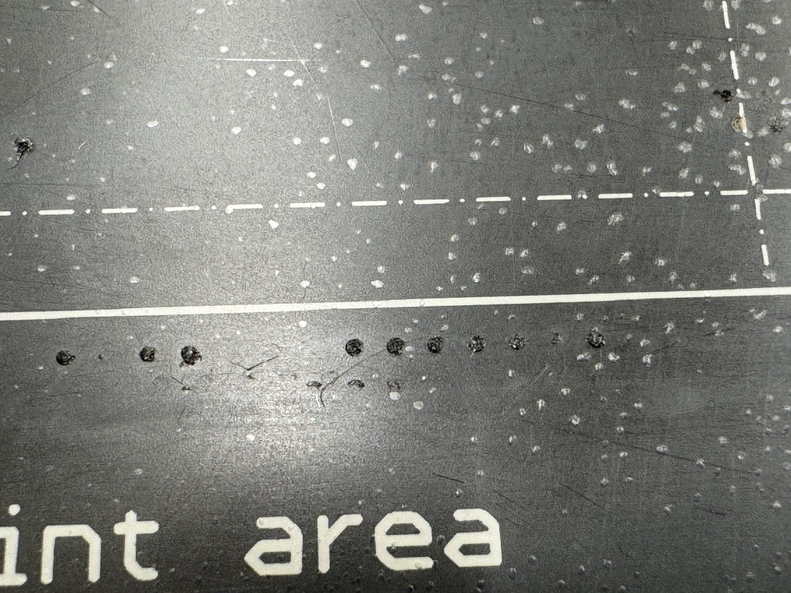

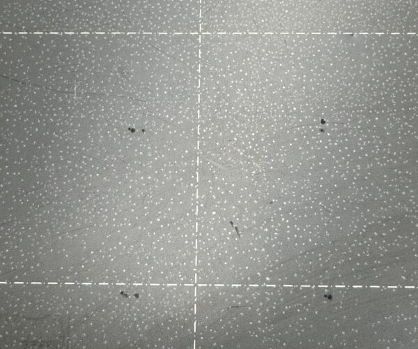

I don't see this as a top level topic, so I'm starting a new thread with a title that is a bit more clearly labeled. I received my MK4 as a kit a couple of months ago. I assembled, upgraded firmware and calibrated and everything worked great from the first print.
Since then, I started to notice small dents in my smooth build plate. I monitored it closely, and it appears that the dents appear during the initial calibration step before printing. I now have little divots all over the plate. Each time the printer calibrates I'm assuming that they also affect the calibration process, possibly making the problem worse?
Here's a picture showing the equally spaced dents:
And here from the gutter on the bottom edge of the plate:
I've reached out to Prusa via their contact page. I'll update this thread with any steps that they ask me to take. Or maybe a Prusa employee who's monitoring the forum can comment. If you have the sames dents on your build plate please post a response to this thread. If you don't have dents and your MK4 is working fine, I'd love to know that too. That would indicate there is something specifically wrong with my printer and it will help the Prusa folks diagnose and repair the problem.

Are you sure they're dents and not bits of filament that could have oozed out when the head tapped the plate? I thought the same thing as you, but I was able to scratch them off with a bit of IPA and a fingernail.
RE: MK4 denting build plates
Good suggestion. I pulled out my microscope out for a closer look. Sure enough the actual "dent" is more of a moon crater; a ring of compressed plastic material. Given that I'll probably need to acquire a new plate anyway, I took out some acetone and some super fine wire wool and took off the raised material. What I found was that most of the "dents" could be smoothed out. Only about 10% were actual dents in the plate. So, not zero, but a lot better than I originally thought.

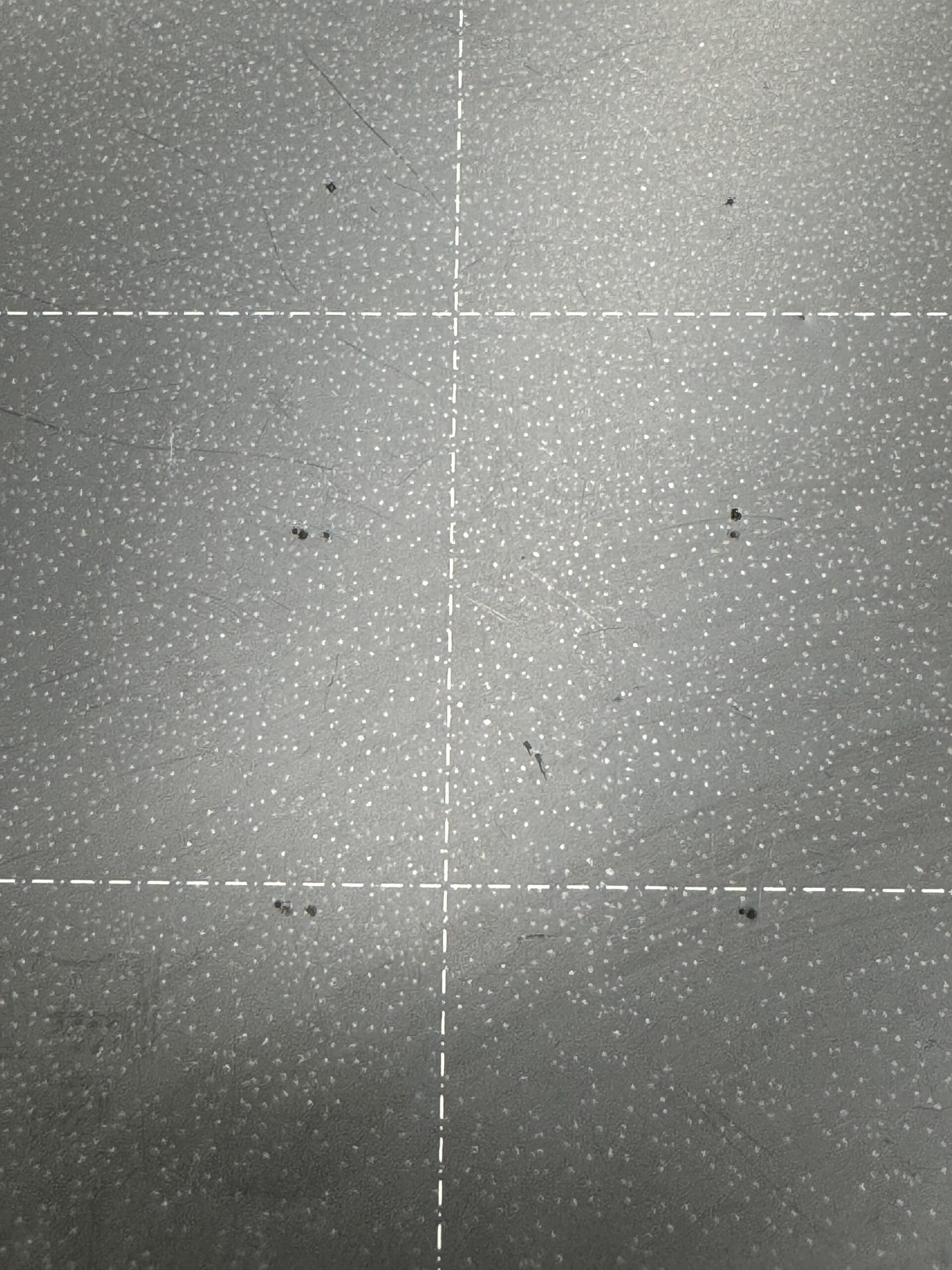

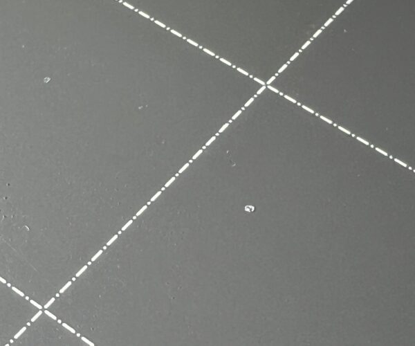

I just had similar issue - new printer (after 8 printouts only), printing with PLA only - I was changing filament to different color (so the nozzle did heat up), then selected pre-heat to PLA (to pre-heat the bed as well) and then started new print via PrusaSlicer - not sure what was exact temperature during bed levelling (if 230 or 170 degrees Celsius), however after the print I did notice having 9 holes in the PEI sheet in places where nozzle was probing - see attached photos.
I have similar structures on my sheets all the time, but until now, they always were specs of filament, not holes. Not saying that this is the case for you, but I really couldn't tell the difference from a picture. I actually thought mine were holes, too - then I took a scraper to to sheet to check if if could perhaps smooth the problem out. That would probably be a total waste of time, but I assumed that the sheet was b0rked anyway, so I experimented. Well, it turned out that my "holes" were little nozzle-shaped rings of plastic I could simply scrape off.
If, what's totally possible, yours are actual holes in the sheet, I suggest replacing it with a satin sheet. It's just the best Prusa has to offer and I really don't know why they still use the smooth sheets as the default that's packed with the printer.

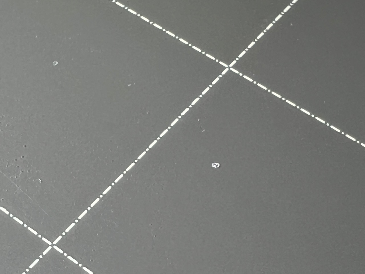

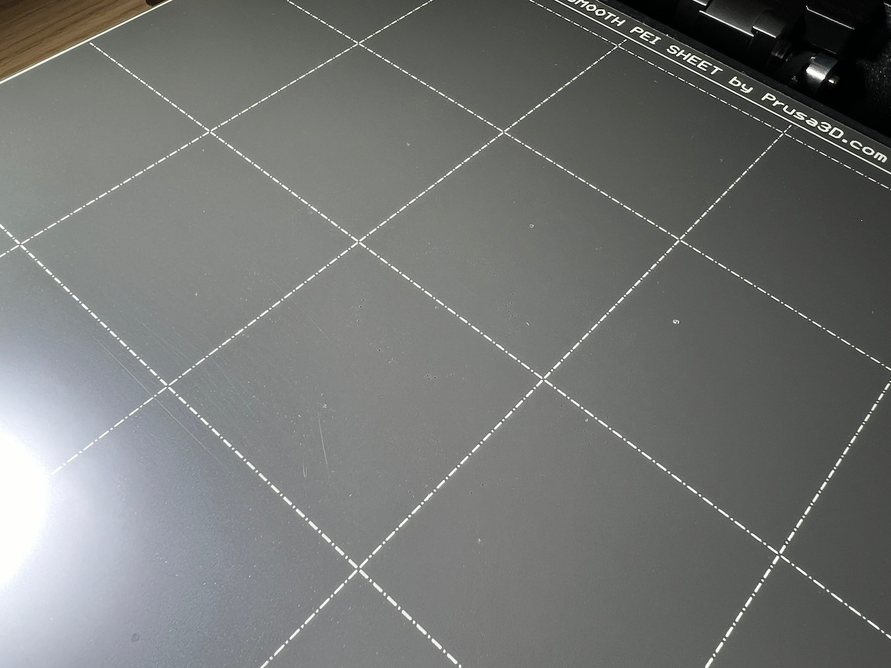

Wow, lots of great discussion on this topic. Just to wrap up the outcome from my perspective.
After sending pictures to Prusa support (very helpful) we determined that indeed the majority of the dents were in fact ring shaped residue. There were a couple of actual dents, but only a small number. I was unable to successfully scrub off the residue without damaging the smooth plate, so I ordered a satin plate as recommended by several of you. The satin plate is actually awesome. No adhesions or denting, PETG & PLA parts stick well and release easily. Highly recommend that folks get one and that Prusa makes it the default plate for new printers.
