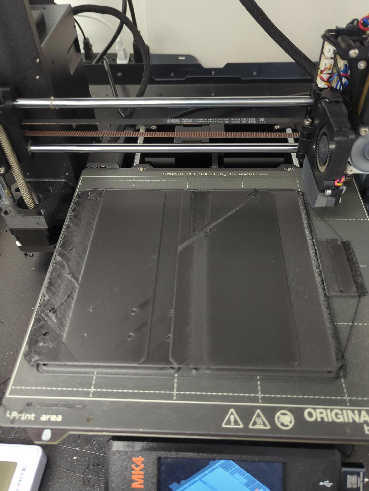

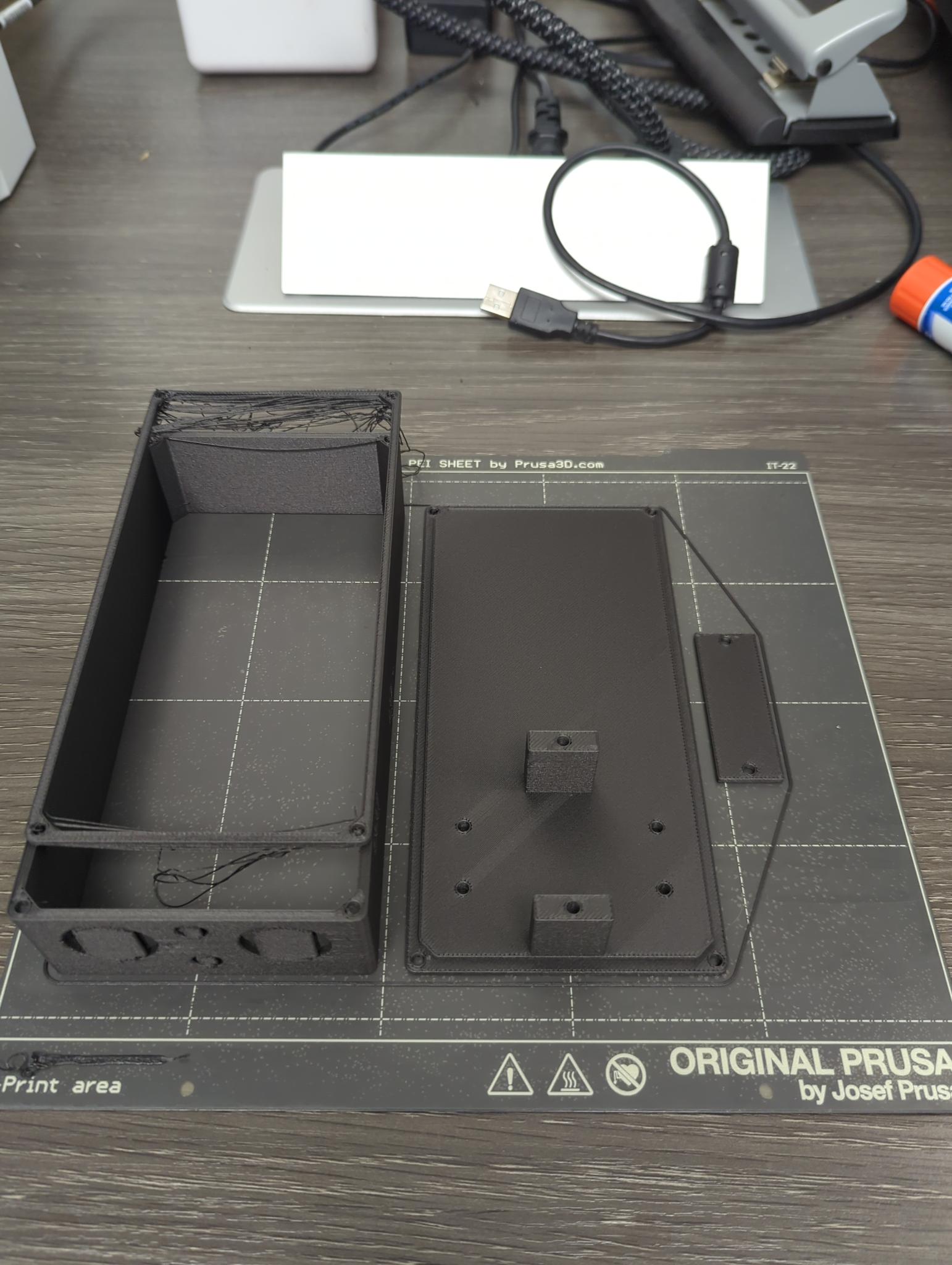

RE: Layer Shifts Galore
MK4 / 0.4mm hardened steel nozzle / 3DXTECH CF-PETG
Like others in this thread I am having sporadic and unpredictable xy-layer shifts that are destroying my prints, wasting material and causing me to get back logged with orders. I am having similar issues with a failure rate of about 1 every 4 prints, and what feels like 100% failure with prints involving multiple objects. For single object gcode files, I've ruled out corrupted gcode because back to back attempts with the same USB drive and same gcode file resulted in a perfect print. Proof is attached in the first picture. My belts are tight so I don't even want to discuss that. I will never buy another Prusa again. I feel completely betrayed by the failures of the MK4.
