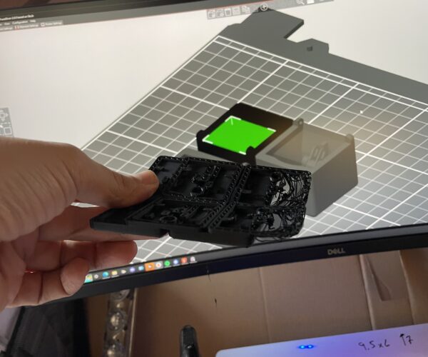

Was running Alpha4 but couldn't stand the constant layer shifting.  Switched to a stable release thinking it would fix it but alas...
Printing a set of 30 simple irrigation clamps (5 hours on stable so not a huge print) and when I got home at lunch I could see the print had shifted probably around layer 8 along the +X and -Y axis and then again probably another 10 layers up along the +X and +Y axis.
I just got off a 23 hour print with no issues, 2 objects.  I have seen layer shifting occur in the same place on repeat prints.  This seems to indicate that the machine is not 'losing it's way' but the problem is more software related (which gives me hope).  Is the slicer possibly doing something strange?
Does anyone have any suggestions?  Very frustrating 😖

These are the 3 sitting next to me.  I'm running almost a 40% failure rate.  However, I printed the same object again, no changes whatsoever, and I got an identical layer shift pattern in the exact same location.  Pretty much eliminates belts as a concern.

I think it's interesting that you think it's a USB issue because I kind of do too.  I switched to a CRAZY slow USB key and the layer shifting went nuts.  Specifically on the attached print.  Four tries, four failures.  The problem seems to have more to do with the number of objects in the initial setup than it has to do with the complexity of the object (which is why I thought it could be a slicer issue).  I'm a noob when it comes to GCode so it's possible that multiple objects would create a larger file than one large object which could create problems on a slow USB.  Someone could probably chime in on that.
Also, I've noticed that the PrusaSlicer software is much much slower than it used to be.  Definitely not a computer power issue.  The program may be poorly optimized for Windows 11 (most stuff seems to be) and my install of 2.6.0 corresponds to my install of Win11 so I wouldn't have seen it until now.   One additional thing I've noticed is that once the Gcode is uploaded to the drive, and the 'eject' option opens up on slicer, if you hit it right away, it will always give a "Drive is in use" warning.  That NEVER happened in the last several years I've been printing on the MK3.  It will eventually eject once it's finished its operations, but the delay is functionally enormous compared to the past.
Anyway, I'm going to try two things.  I'm going to try to print this file (because it has a 100% failure rate) from a faster USB.  I'm also going to replicate the file and slice on the appimage instead of an installed version of PrusaSlicer (doubt that will do anything but why not).  I'll also try an older version of PrusaSlicer.

That would track with my 'multiple separate objects' problem.  All my layer shifting seems to happen when either there are a lot of different objects, or the single object in question has a lot of individual output spots that are not interconnected, like, if you were printing something like an open upright box of crayons.
With my attached example, I was printing 30 individual water clips.  When I dropped it down to 15, it was about 75% successful.  When I dropped it down to 6, it worked fine over and over and over again.
Really leaning on the USB.

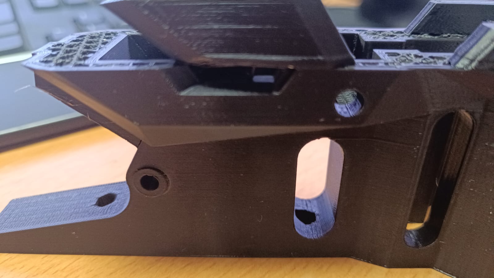

When loading GCode in the viewer it looks fine, at 22m z the print shifts 10mm to the right. I have lost 1Kg of filament so far trying to solve this. Firmware 5.0, Prusa Slicer 2.6.1, profile .15mm structural (modified support, infill, brim). Now I am thinking it is a memory issue, have not tried reset so far.
