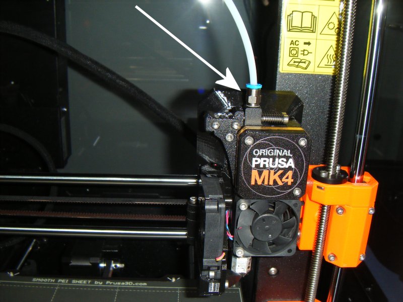

I have my MK4 in the Prusa enclosure and it uses something like a reverse bowden setup and works great. Here is what I mean. I found this info on another thread in hear for a different issue,
https://forum.prusa3d.com/forum/english-forum-original-prusa-i3-mk4-how-do-i-print-this-printing-help/two-failed-dowels-i-am-brand-new-at-3d-printing-am-i-doing-something-wrong/#post-701411

Here is a pic of mine and I just wanted to mention to add the pneumatic coupler for the PTFE bowden tube as pointed out by the arrow.

Thanks for sharing your insights and fails. It seems that my hunch is correct.
I will continue monitoring the new fillament guide and investigate the reverse bowden.
