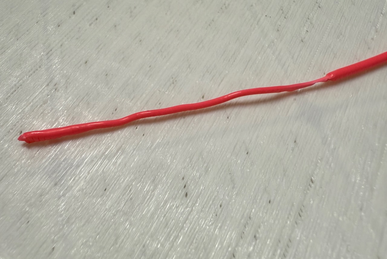

I'm trying to diagnose a "stuck filament" issue on my MK4 (6.2.6+8948) with MMU3. The stuck filament detection page sent me to the loadcell troubleshooting, which I tried completely. Neither the screw-loosening nor checking (and vacuuming debris from) the loadcell helped.
So now, I'm trying a cold pull. My firmware is new enough that it happens automatically. I did two pulls, but the filament coming out isn't conical like I see in the example images. Are these two appropriate looking cold pulls? (Note: prior printing was with black and white PLA, so the this pink PLA should be high contrast to show debris.

While I'm still not sure if my cold pull above looks correct, I followed the directions on the under-extrusion article as pointed to by support. It seems to have fixed my root cause issue.
