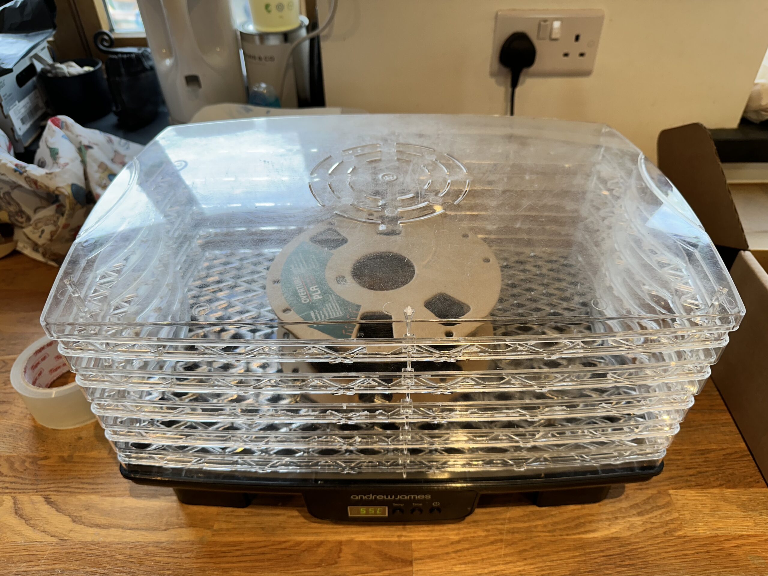

SafetyThird
(@safetythird)
RE: Should I be calibrating my new MK4?
Thanks very much for the info, that gives me temps and times to work on, I'll dig the old dehydrator out and make a cardboard shroud around the reel and see how that works.

I use a food dehydrator with a printed centreless collar that drops over a standard tray and holds two spools.  Now I have the XL it's working overtime.

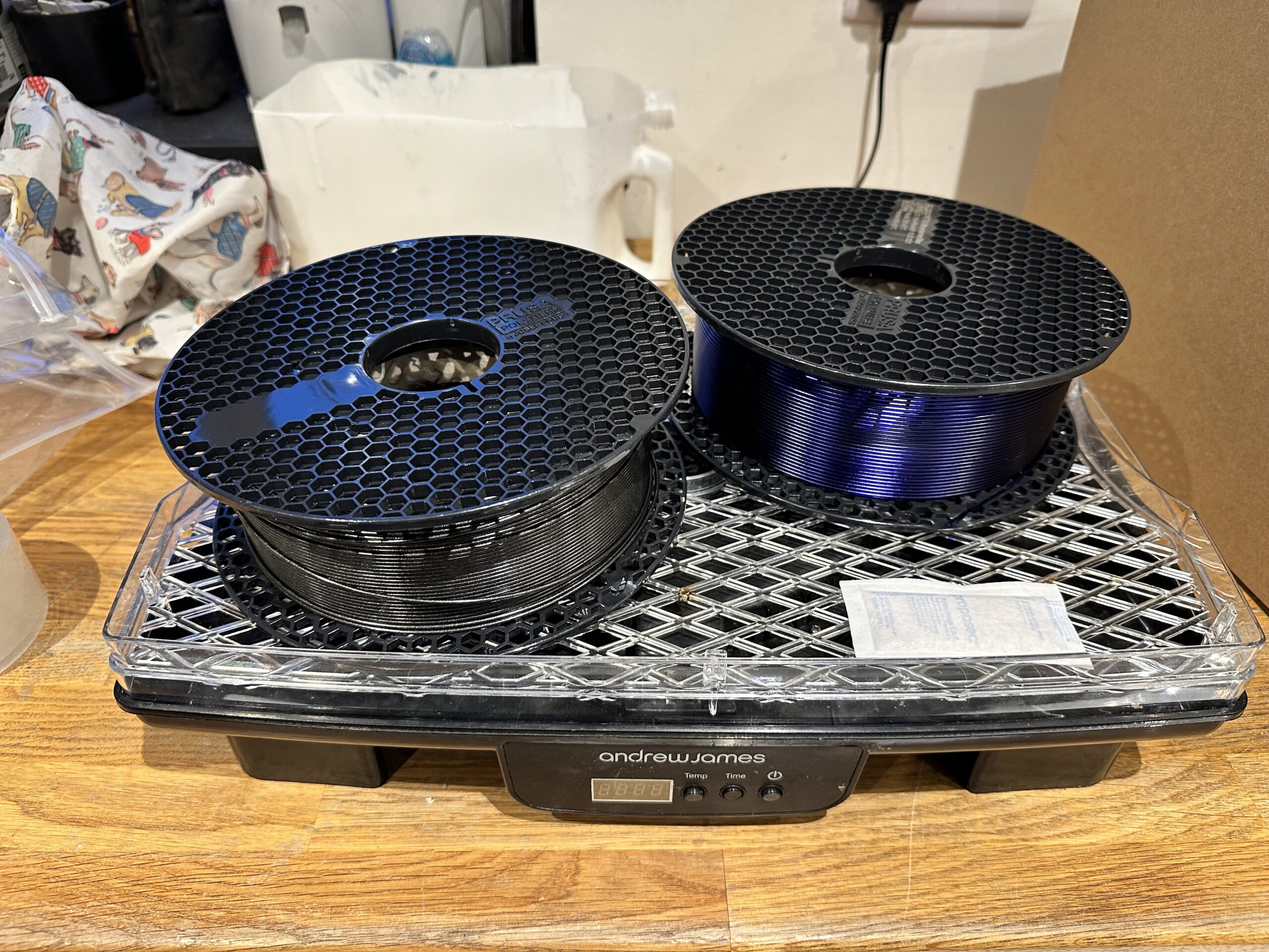

SafetyThird
(@safetythird)
It's not pretty, but it works 🙂
Posted : 25/01/2024 8:51 am
SafetyThird
(@safetythird)
Cut the centres out of the old racks which is neater. Can just squeeze 4 reels in there if needed but probably only run with 1 or 2 for better airflow.

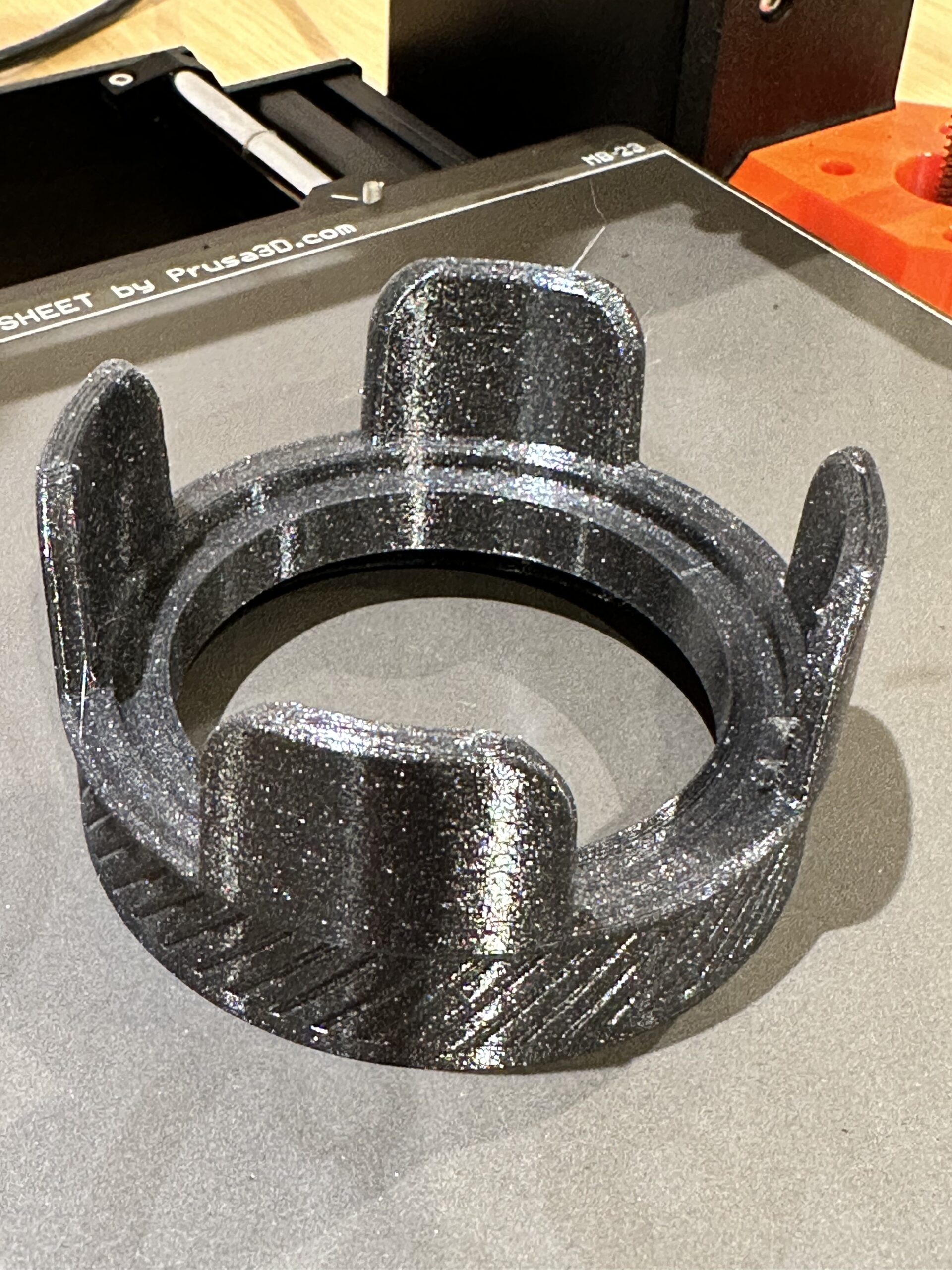

SafetyThird
(@safetythird)
OK, first print off the dried roll and what a difference, it's not perfect but it's 99.9% better than before. Thank you @Diem for the suggestion, it would never have occurred to me that I'd need to dry a brand new reel of filament. I'll now be drying all my petg before use each time.

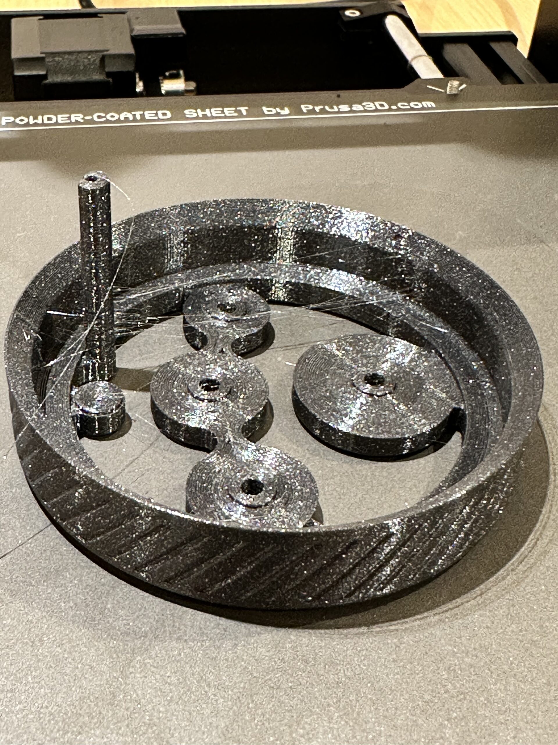

SafetyThird
(@safetythird)
Second print still had a little bit of stringing but much better and smoother than the first version I made with the un-dried filament.

SafetyThird
(@safetythird)
Thanks, that's great advice. I printed the 'print in place' gear mechanism for the umikot coffee distributor in PETG overnight and it came straight off the bed and all the gears rotated beautifully so yeah, seems to be well set up so far 🙂
