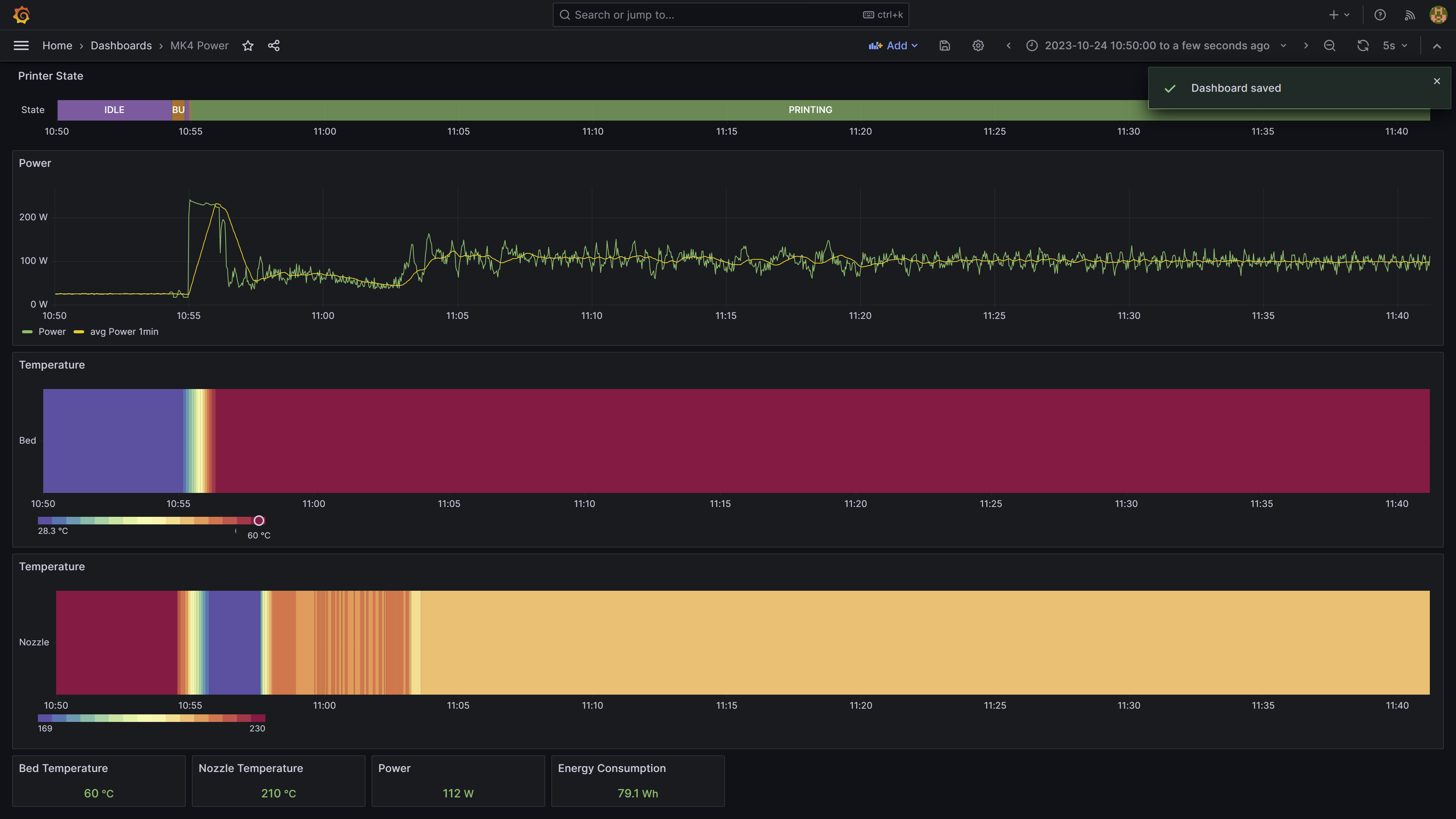

I also wondered about this and added the power figure and energy consumption of the printer (MK3.9) to my data collection setup. Below is one example. The power and energy figures are collected every second from mystrom switch where the printer is connected. It was printing with PLA during this. My quick take home message from this is during heating particularly the bed power figure peaks (>200W), then during printing it is around 100W.
