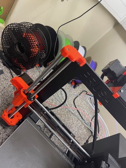

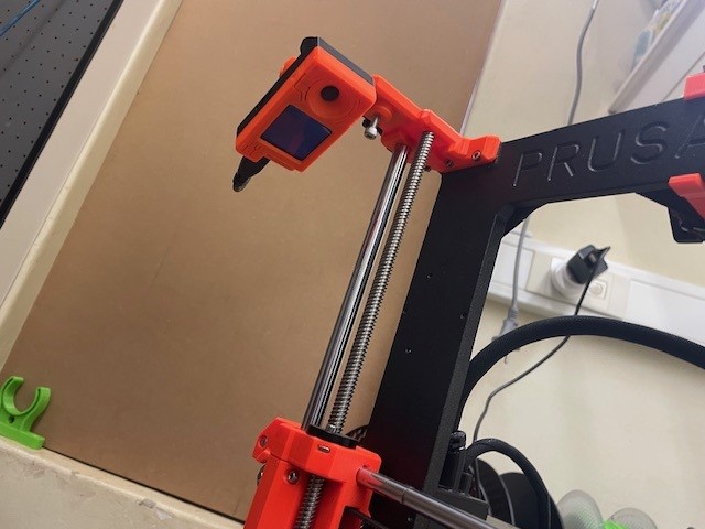

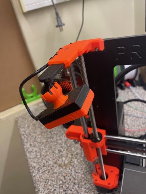

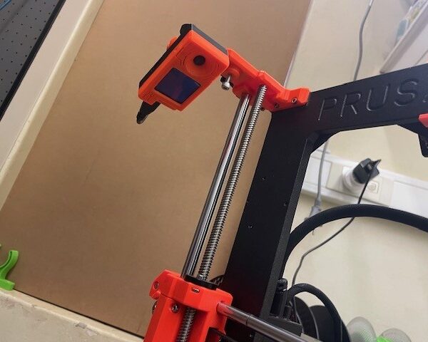

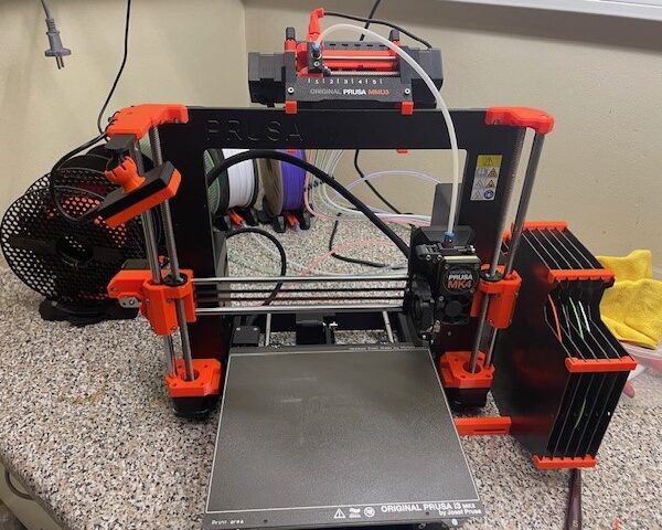

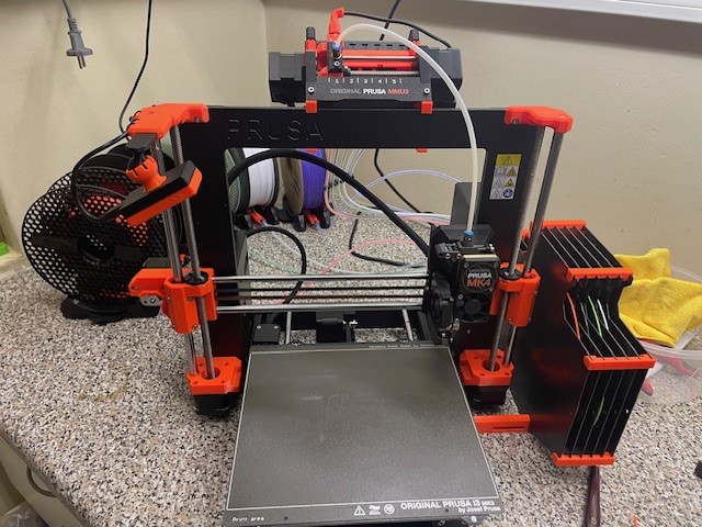

Marthinus Potgieter
(@marthinus-potgieter)
MK4 Camera ESP32 EYE
ESP 32 EYE working extremely well. Simple setup as per Prusa Connect instructions.
Posted : 24/09/2024 9:07 am

Kenjidmn
(@kenjidmn)
RE: MK4 Camera
where did you find the case?  link to it on printables?
