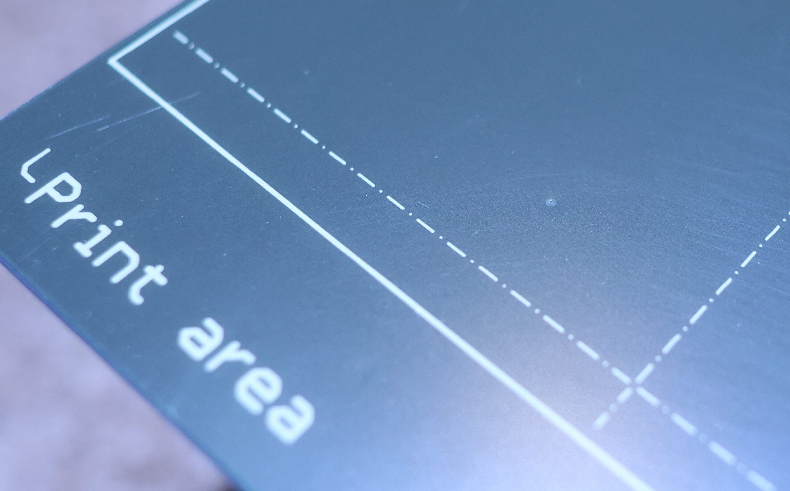

MK4 auto-leveling front left corner divot?
I'm waiting on delivery of my MK4, but I'm noticing a LOT of chatter about MK4s creating a divot in the front left corner of the build plate due to the auto-leveling process.
I don't see a discrete topic called out for this, so wondering if this is isolated to a handful of early and vocal MK4 users or if it's a more systemic issue in the 4.5.4 firmware.
Tried to find a reported firmware issue on GitHub, but nothing jumped out at me.
One video with an example (@ 8:10 marker): My Prusa MK4 3D Printer Issues
Best Answer by Walter Layher:
I can confirm that it left a visible indentation at that spot on the smooth sheet.

Walter Layher
(@walter-layher)
RE: MK4 auto-leveling front left corner divot?
Posted : 16/04/2023 3:15 pm
Walter Layher
(@walter-layher)
After the last print job has just ended, I just checked on the textured sheet that has had most use so far (after one day): I can feel no indentation at that spot there. Also no indentation on the satin sheet that I used for one or two test prints.
Posted : 16/04/2023 3:38 pm
The probing at that spot happens at the beginning of the print during the homing procedure and not at the full temperature of nozzle and bed. The actual bed levelling comes later. Also the smooth sheet is thicker than the other types and softer as well.
Posted : 16/04/2023 3:51 pm

DancingWithMachines
(@dancingwithmachines)
Small Divot Mk4
I can confirm my MK 4 dose leav a small Divot on the sooth PEI sheet
And when watching it perform its first probe you do see noticeable bed flex
Posted : 16/04/2023 8:22 pm

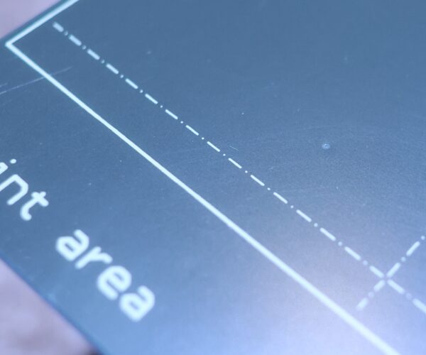

Walter Layher
(@walter-layher)
I have an indentation just on my smooth sheet, no indentation at all on the textured and satin sheets. I did not print a test pattern so far, just practical parts, e.g. all the parts for attaching the doors to the enclosure, hinge parts, handles etc. The set covers a large part of the bed. I watched the first layer, all parts were complete on the first layer, no parts missing. All parts came out fine. Did not make a photo though :-/
Posted : 17/04/2023 2:39 pm

Walter Layher
(@walter-layher)
That booger is not caused by a dent in the sheet, it is where I touched the sheet with my finger. I did not wipe it down before the print, totally my fault. I checked with my finger before for the same indentation as on the smooth sheet. That is "orange" and "fingerprints" in the same sentence at least the second time this week. 😉
