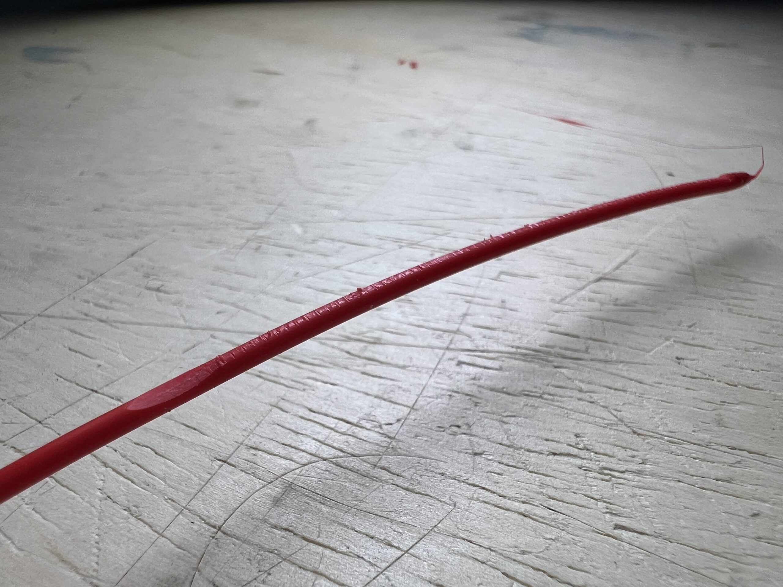

I have an issue with my MK4 that is really frustrating.  After an hour or so of *perfect* printing, filament stops being extruded.  The printer thinks everything is fine and continues to go through the printing motions, but no filament is being extruded.  After unloading the filament, it is clear that the extruder gear was turning, but just grinding a gouge in the filament (see pic).
New prints will repeat the process: perfect start, then no extrusion.  I suspect a temperature problem, but haven't been able to identify it.  Is thermal creep a thing with Nextruder?
This is seen using higher temperature material - ASA, ABS and PETG.  I seem to be able to get through a print with PLA.  I use mostly MatterHackers Pro and Prusa/Prusament filaments.
I have been communicating with Prusa support on the issue, and have tried some of their suggestions, but so far nothing is working.
I have tried the following:
  • Use latest firmware (6.0.3)
  • Multiple cold pulls
  • Re-calibrate nextruder PG alignment
  • Adjusted idler tension screws
  • Swap nozzles
  • Replaced nozzle thermistor (per recommendation from Prusa support)
  • Disable IS
  • Increase temperature for easier flow with higher IS speeds
  • Verified nozzle temp is stable during print (at least according to telemetry)
  • Monitored heatbreak temps (look fine during print)
  • Tried with and without enclosure (I use a WhamBam)
  • Ensured no drag on filament while printing (by sitting there pulling filament off the spool so that there are big free loops of filament above the extruder)
  • Tried in both warm and cool ambient temperatures
  • Tried different slicers (in case there was some bad gcode in there somehow)
  • Tried different thumb drives (in case there was a storage error)
  • Cleaned extruder gear
So far nothing has worked.  Any ideas?

This sounds a lot like an issue I had with one of my printers.  I have 2 Mk4s that were purchased 1 week apart, one of them started doing this.  I went through all kinds of debugging to no avail.  Fortunately, I had two of these, so I started swapping parts one at a time.  Hot end, gears, gear ring, idler, etc.   As soon as I swapped the extruder motor, the problem moved from one machine to another.  Prusa were great and sent me a new motor and the printer is working great now.
One more thing:  I could get the extruder to start up again, temporarily, by opening and closing the idler door mid-print.  I also printed a clear transparent gear cover in PETG as per the CNC Kitchen instructions, and that was helpful to visualize the gear movement, (or lack thereof)

That indeed works. If the Filament stops proceeding, I can open the idler and it starts to move once again. I meanwhile exchanged the idler, but that didn't help. I'll need to contact Prusa Support I guess.

Interesting - sounds like you are saying that the extruder motor/gear actually stopped turning.  I don't *think* that's my problem, based on two things:  the filament shows a distinct gouge where the extruder gear has been turning (see photo in first post), and the extruder gear gets plastic bits clogging the teeth.  All points to the gear turning but unable to extrude for some reason.

After another marathon session on support chat, Prusa sent me replacement parts for the idler assembly:  Idler Lever A+B, Idler Nut, and 2x Idler Swivel.  All printed out of PCCF, so heat shouldn’t be an issue in the future.  They also sent me the Y-tension blocks, also out of PCCF.  Sounds like they sent me everything that “might get hot”.
I installed all the bits and re-tried my test print (a small box for a an electronic device, using ASA) - and IT WORKED!  Granted this is only one print so far, but it’s the first successful print in like 6 weeks.
Seems like if they are making these things out of PCCF instead of PETG, they should probably provide them in the upgrade kit (like they did for the print fan duct).
