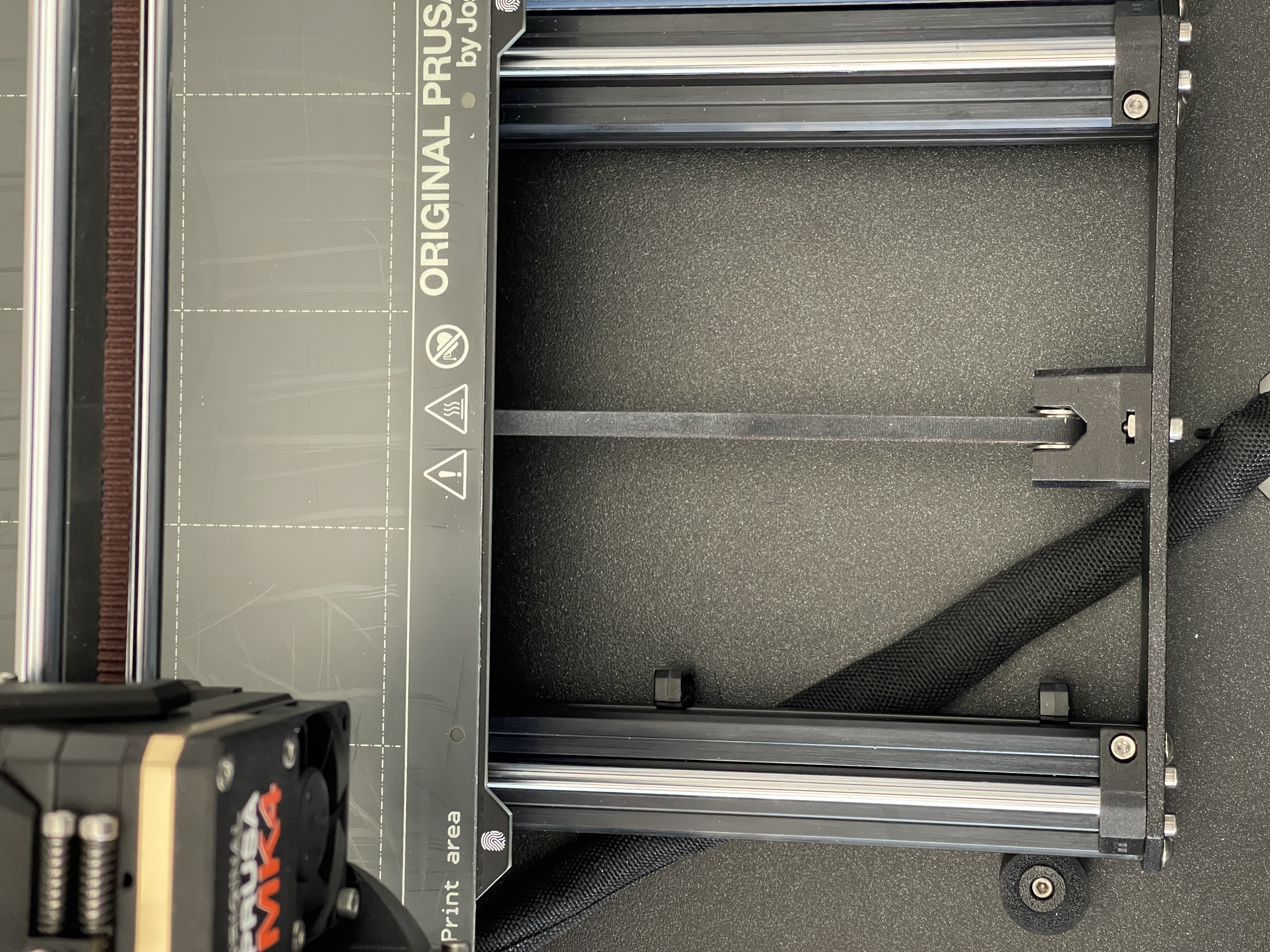

Not sure if anybody else has the issue, that with the update to FW5.1.2 the selftest for y-axis fails and fails and ...  no chance to get it working for me.
I downgraded the FW, and voila, it works fine again. Going back to 5.1.2, same issue occurs.
I cannot find the issue as a know bug anywhere but i cannot imagine that i am the only one who has this problem ?

After 2 days analysing the issue, and it was a lot of work because i builed my MK4 in an orginal enclosure.
Story short version:
I had the same issue with FW 5.0, and so i decided to disasable the y-axis completely and assamble it from scratch. I found that a lot of screws were loose (factory assembly). Now I used screw glue and after assembling it three times, I had no errors on one axis and can now carry out all the tests repeatedly. However, I now only print spagetthi monster and it doesn't matter which filament and which settings I use. I also changed nozzles in different thicknesses. All my hopes for a stable device are slowly dashed and I'm thinking about switching to Bambu 🙁 It's really frustrating when you decide against a Chinese bomber and you think you're buying good European quality... in total I've now spent over 2000 euros for a lot of trouble.

Here is something else I found on y axis only yesterday.
If you mistakenly install y axis idler support upside down, it still works but the belt geometry is all wrong. The result is the belt gets tighter as the bed moves to the forward position. When moved by hand, and the bed is released it can move backward under belt tension.
The correct orientation of the y axis idler mount has the insertion of the idler pulley from underneath, the smooth surface must be uppeemost.
This can cause layer shifting, and could theoretically also affect y axis calibration (in addition to the bearing position thing). it can also cause excessive belt stretching with longer term belt wear-out leading to a maintenance issue after some time has elapsed, and certainly belt tension will need adjustment more frequently.

Check the orientation of the y axis idler holder. the slot for insertion of the idler pulley should be underneath, not anove.

Read the thread. many have this issue. it can be fixed by altering the position of the front left y axis bearing so that the inside  gap of the bearing to the bed frame is at least 0.25 mm.
With the fix done you can use 5.1.2 and y axis selftest will complete successfully.

You are right ! i made all these steps, and all axis are passing the tests well now. unfortunately, now i print only spagetthi monsters because of layer shifts.
I have losen the belt a little bit, afterwards i made it shortly stronger, but it still fails - spagetthi spagetthi spagetthi ....
i have absolutelly no clue why, but 1cm heigh the layershifting starts,- no matter how the belt looks like...
