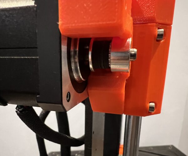

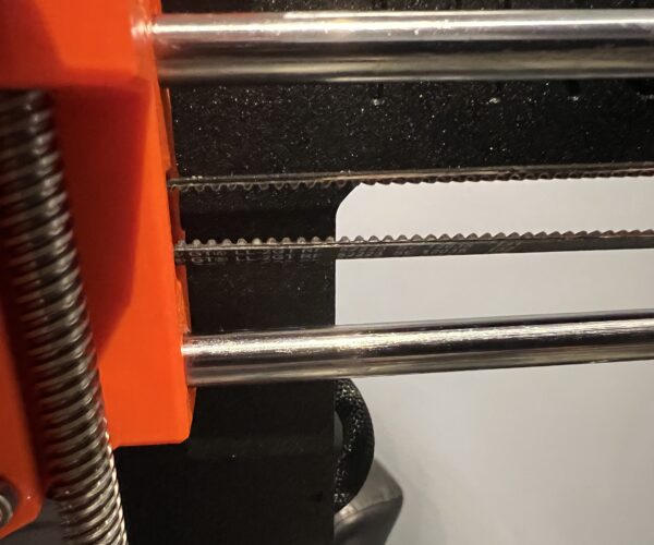

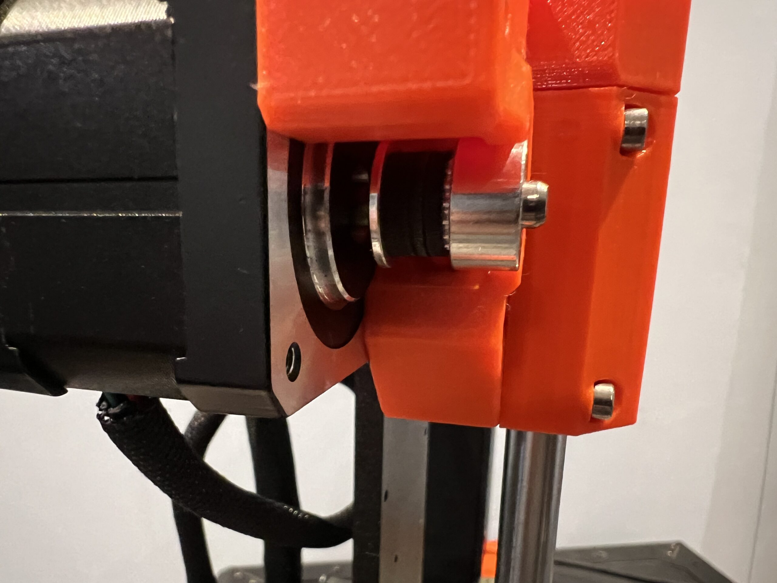

i have just got round to upgrading my mk3 to mk4 and just switched on just now and it fails at the x axis test. The belt kinda twists on the side where the x axis motor is. Any help would be appreciated.
Best Answer by Yaka:
Well I found the culprit it was a screw that was at the bottom instead of m3x16 I used a m3x20 the screw was poking through and hitting the belt

OOOps!
good find!
