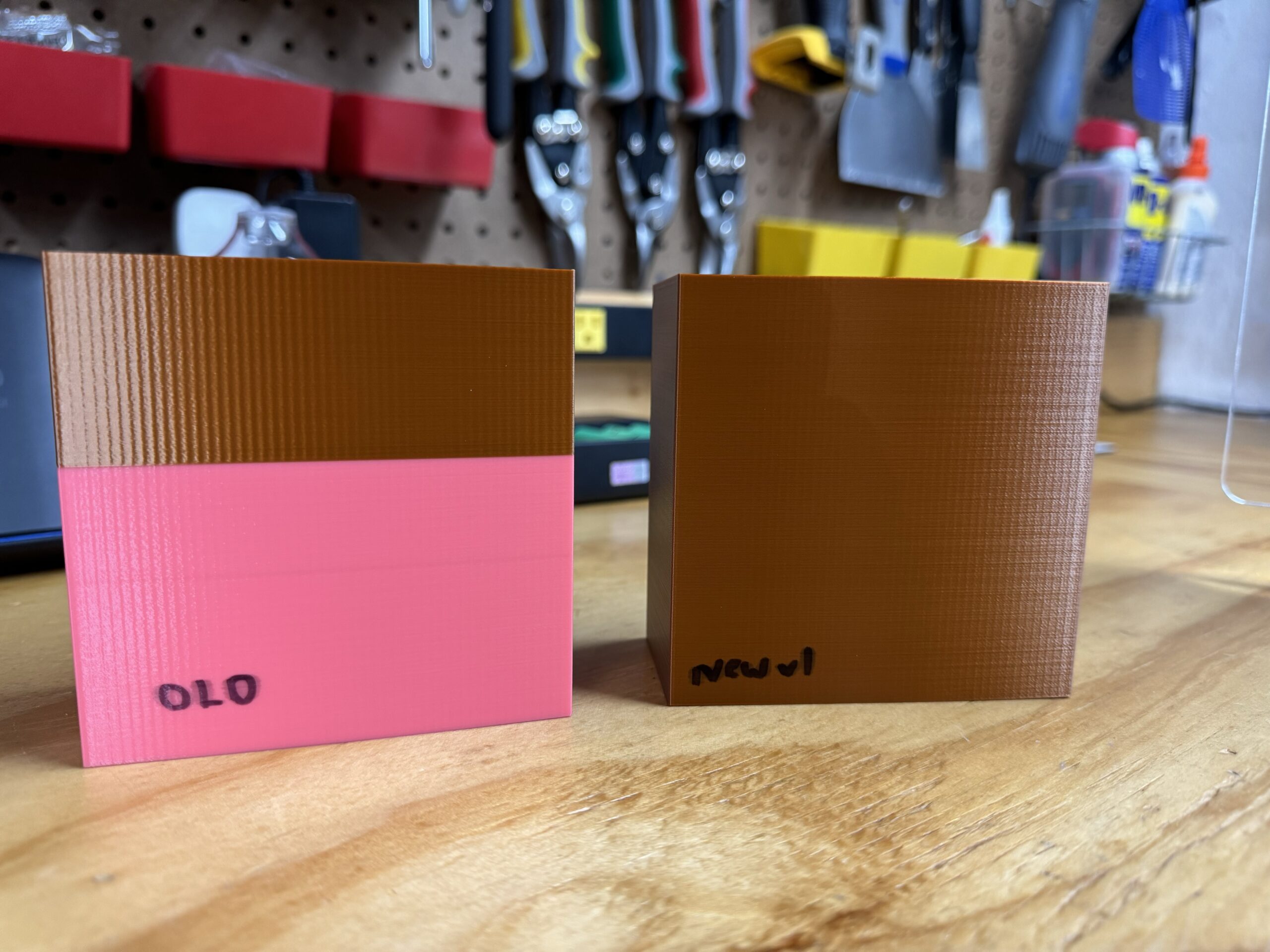

RE: Vibration artefacts on Y-Axis
I just replaced the y-motor pulley on my MK4 and the artefacts are gone.
Images: old vs. new (same gcode)
Publié : 02/10/2023 5:12 pm

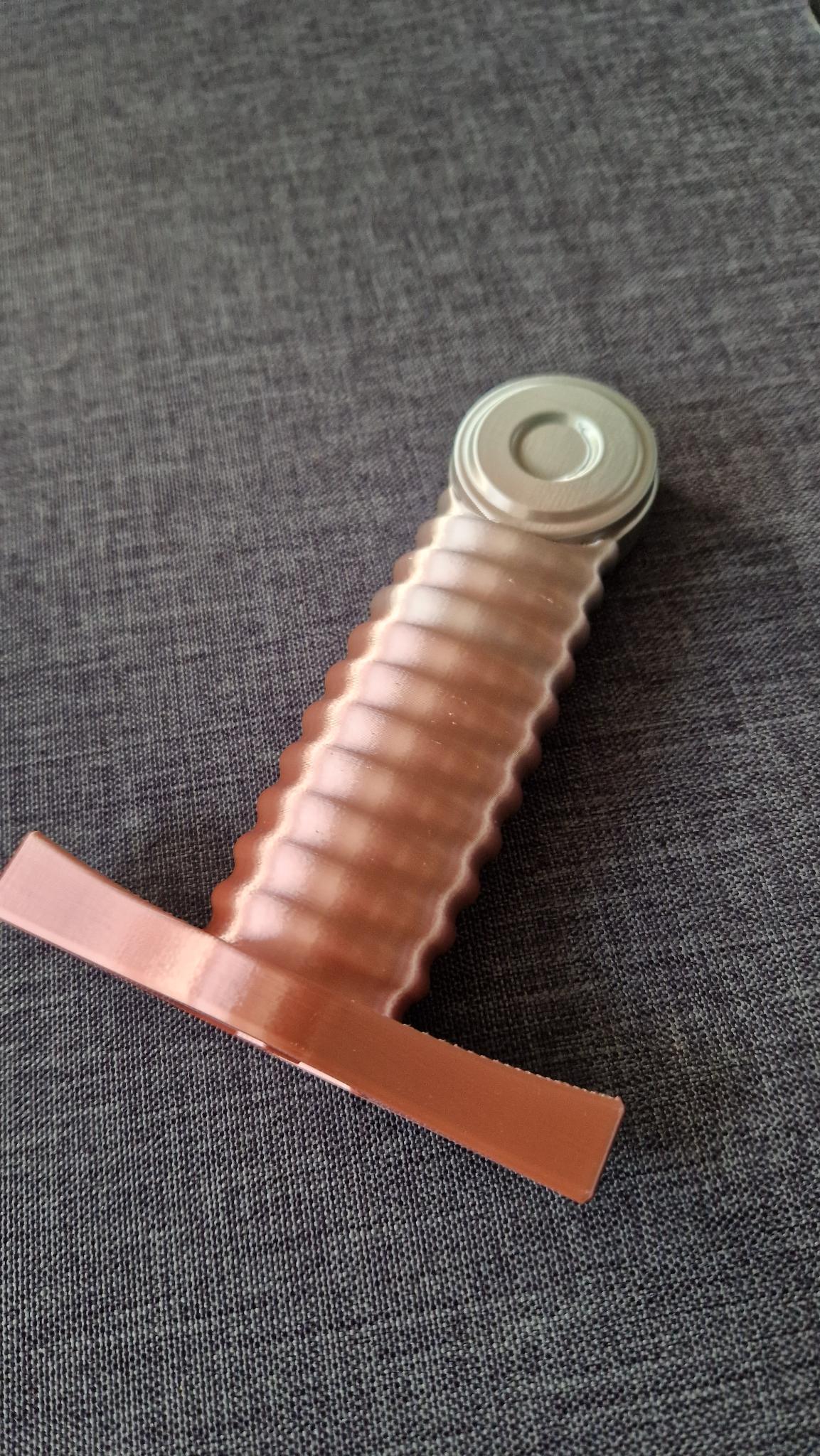

I ran into the same exact problem that I slowly started to notice over time.  When I came across this thread I just went ahead and replaced the Y axis pulley, sure enough it seems to have alleviated the worst of the problem.  This definitely seems to be a problem, I'm curious if the idler is wearing over time or if there was just a bad batch of them.  Like others I cannot discern a different between the pulleys.
y axis artifacts

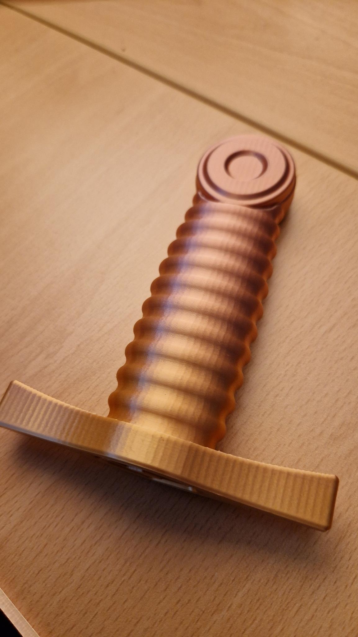

I came across this thread and I was wondering if the artifacts I have in below pictures are also caused by vibration artefacts on the Y-axis? Or is there something else throwing off my prints?
I thought it was a loose belt, but even after tightening it I still see the "steps" now I know what to look for.
Photos of 3d print artefacts
